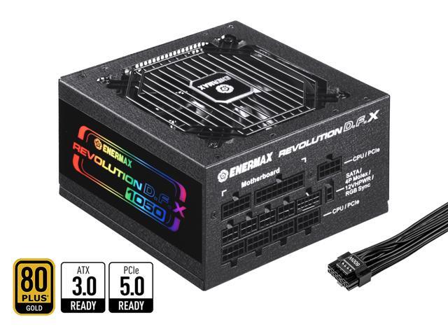

The Enermax REVOLUTION D.F. X 1050W is the second Enermax power supply we have seen here at TheFPSReview. However, it is by no means the first power supply Enermax has produced as they have been a long-time staple in the enthusiast sphere. However, while Enermax has a long history that includes a lot of high-quality units pricing has sometimes been an issue. So, with a new REVOLUTION on our hands, has the REVOLUTION D.F. X 1050W gone the way of the world-changing revolutions that people think fondly of, or has it gone the way that oh so many more have gone and descended into chaos? Let’s see.
Build Quality
Today’s Enermax REVOLUTION D.F. X 1050W starts things off with a build quality that is excellent. The finish that this unit has is exactly what we have come to expect from Enermax units over the last number of years. This includes their much more textured finish, a revised REVOLUTION branding, and flat FlexForce-style cables. The topology is very modern, and the component selection is generally very high quality. Among these components, we find Rubycon and Nichicon standard capacitors coupled with FPCAP and Chemi-con solid capacitors. The fan is an Enermax-branded “Twister Bearing” fan. The actual integration is excellent and the soldering is excellent. Lastly, this unit is covered by a 5-year warranty and decent documentation.
