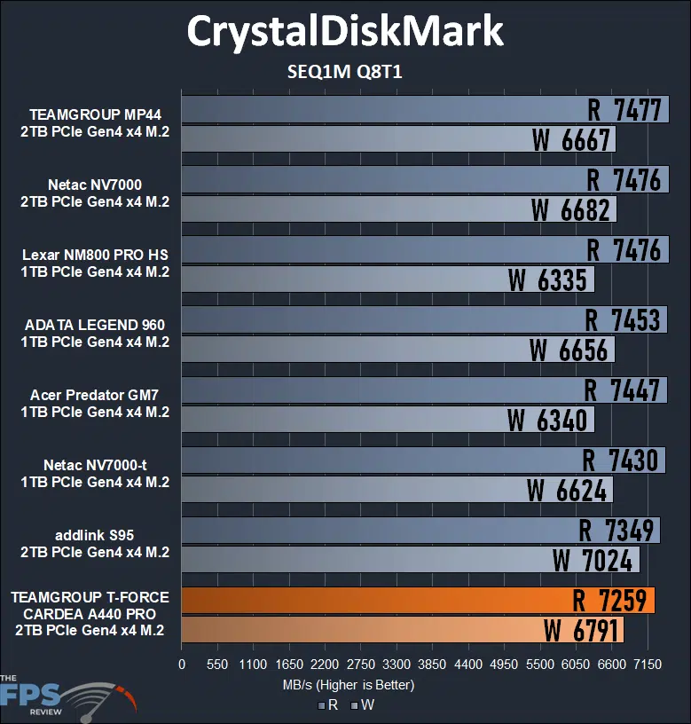

We are using CrystalDiskMark to benchmark sequential and random throughput of read and write performance. For these NVMe SSDs, we are using the NVMe profile in CrystalDiskMark. This tests SEQ1M Q8T1, SEQ128K Q32T1, RND4K Q32T16, and RND4K Q1T1.
The rated sequential read speed on the TEAMGROUP T-FORCE CARDEA A440 PRO 2TB SSD is 7,400MB/s and the rated sequential write speed is 7,000MB/s. In CrystalDiskMark SEQ1M Q8T1 we are getting just slightly under that for read, and a bit more under for write performance. It’s still very close to the rated speeds, but compared to all the other SSDs on this graph it does miss the mark a bit by comparison, on sequential performance.

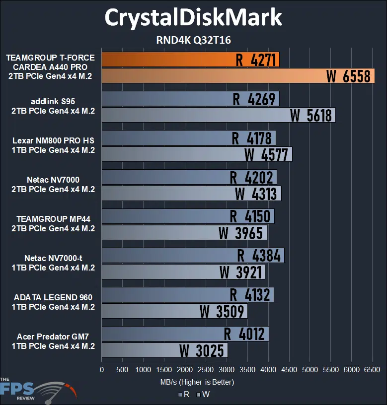

In RND4K Q32T16 performance the very much opposite is true of the TEAMGROUP T-FORCE CARDEA A440 PRO 2TB SSD, and it actually performs really good at random performance! Here we are seeing the highest read and write performances out of this group of SSDs, with a read of 4,271MB/s and a write that is very impressive at 6,558MB/s. This is the highest random write speed we’ve seen out of this class of SSDs. So while the TEAMGROUP T-FORCE CARDEA A440 PRO 2TB SSD is a bit under in sequential, apparently in random it’s doing really great!

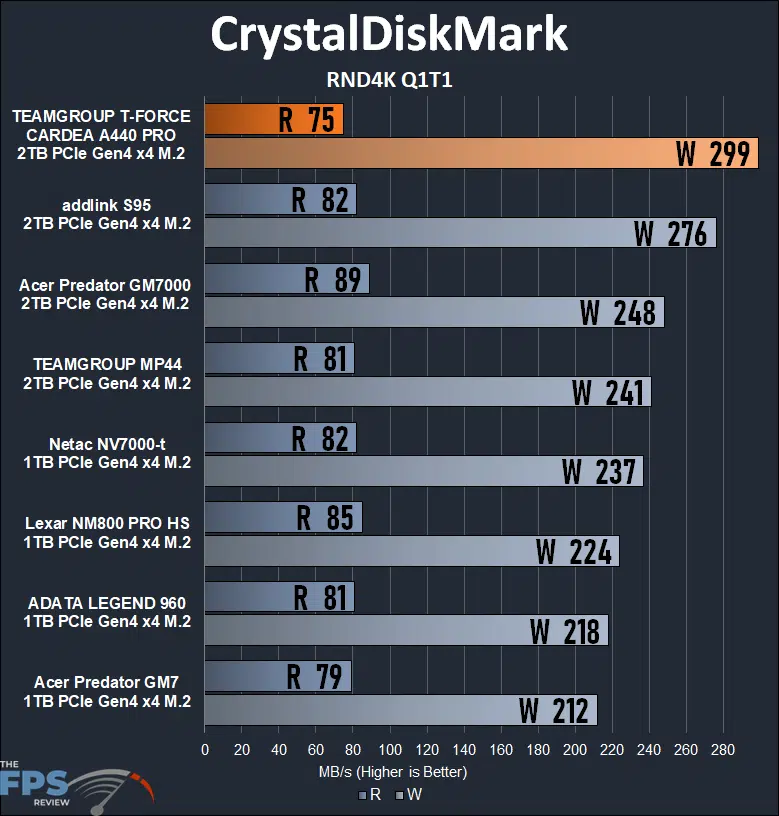

In RND4K Q1T1 performance, the TEAMGROUP T-FORCE CARDEA A440 PRO 2TB SSD once again has a very strong write performance of 299MB/s, outperforming every other SSD here! This is definitely the strong point of the TEAMGROUP T-FORCE CARDEA A440 PRO 2TB SSD, it’s random performance, and specifically, it’s random write performance.
