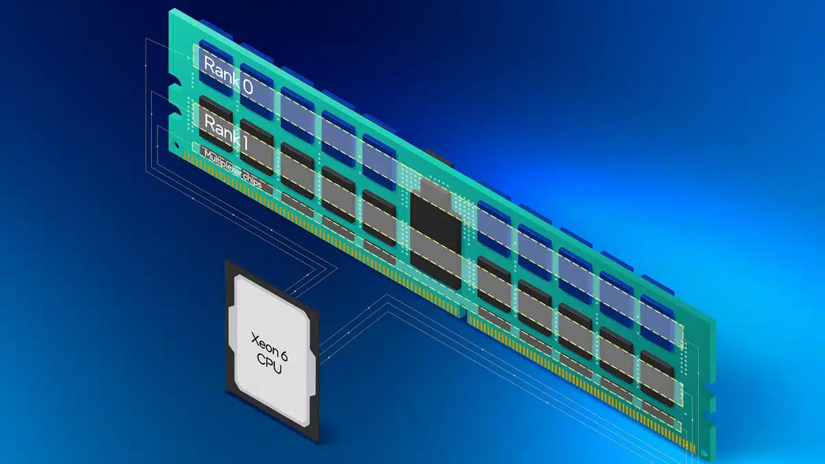

It turns out the most common memory modules used for data center jobs, known as RDIMMs, do have parallel resources on board, like modern processors do. They’re just not used that way.
“Most DIMMs have two ranks for performance and capacity,” says George Vergis, a senior principal engineer in memory pathfinding in DCAI. “It’s the sweet spot.”
You can think of ranks like, well, banks – one set of memory chips on a module would belong to one and the rest to the other rank. With RDIMMs, data can be stored and accessed across multiple ranks independently but not simultaneously.
Considering this situation, recalls Vergis, “We’re like, ‘Wait a minute. We’ve got parallel resources that are unused. Why can’t we put them together?’” The idea that Vergis pursued was to put a small interface chip – a multiplexer or “mux” – on the DRAM module. It allows data to flow across both ranks of memory in the same unit of time.
The mux buffer consolidates each MRDIMM’s electrical load, which allows the interface to operate at a higher speed compared to RDIMMs. And now that both ranks of memory can be accessed in parallel, its bandwidth has doubled.
The result is the fastest system memory ever created – by a leap that would normally take several generations of memory technologies to achieve (in this case, peak bandwidth rises by almost 40%, from 6,400 megatransfers per second (MT/s) to 8,800 MT/s).

What stands out about the MRDIMM is its ease of use. It employs the same connector and form factor as a regular RDIMM (even the little mux chips fit in previously empty spots on the module), thus requiring no changes in the motherboard.
MRDIMMs also bring along all the same error-correcting and reliability, availability and serviceability (RAS) features as RDIMMs. Data integrity is maintained no matter how separate requests might be multiplexed across the data buffer, Vergis explains.
