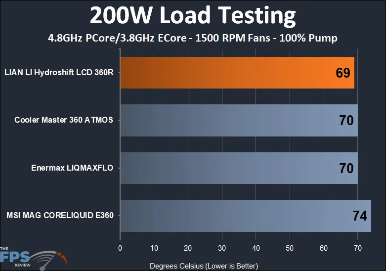

1500 RPM Fans – 100% Pump Speed
Lian Li Hydroshift LCD 360R 200w load testing results at 1500 rpm fan
Leveling out the contestants at 1500 RPM on the fans, Lian Li Hydroshift LCD 360R pulls ahead at 69 degrees Celsius while the Cooler Master 360 ATMOS and the Enermax LIQMAXFLO participate in a two-way tie at 70 degrees. The MSI MAG CORELIQUID E360 trails the tied contestants at 4 degrees Celsius warmer.

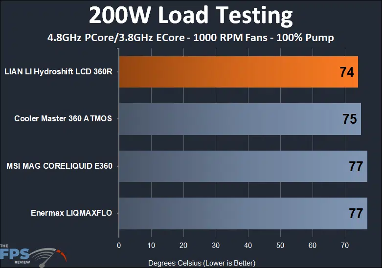

1000 RPM Fans – 100% Pump Speed
Lian Li Hydroshift LCD 360R 200w load testing results at 1000 rpm fan
Further slowing the fans to 1000 RPM, the Lian Li Hydroshift LCD 360R maintains first place at 74 degrees with the Cooler Master ATMOS trailing by a single degree. The MSI MAG CORELIQUID E360 and Enermax LIQMAXFLO are three degrees warmer than the Lian Li Hydroshift LCD 360R.

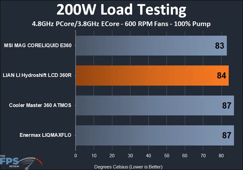

600 RPM Fans – 100% Pump Speed
Lian Li Hydroshift LCD 360R 200w load testing results at 600 rpm fan
Finally, at our lowest tested fan speed of 600 RPM, the Lian Li Hydroshift LCD 360R achieves an 84-degree Celsius temperature. The MSI MAG CORELIQUID E360 shoots to the top of the charts at 83 degrees while the Cooler Master 360 ATMOS and Enermax LIQMAXFLO land three degrees warmer than the Lian Li Hydroshift LCD 360R.

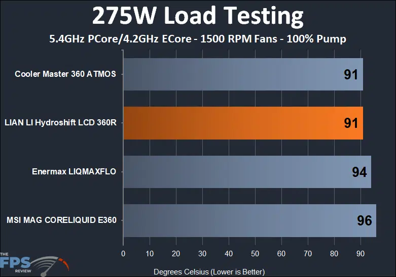

Lian Li Hydroshift LCD 360R 275w load testing results at 1500 rpm fan
Normalizing all of the fans at 1500RPM found the Lian Li Hydroshift LCD 360R tying with the Cooler Master 360 ATMOS at 91 degrees, the Enermax LIQMAXFLO flowed down to 94 degrees and the MSI MAG CORELIQUID E360 chilled at 96 degrees Celsius.
