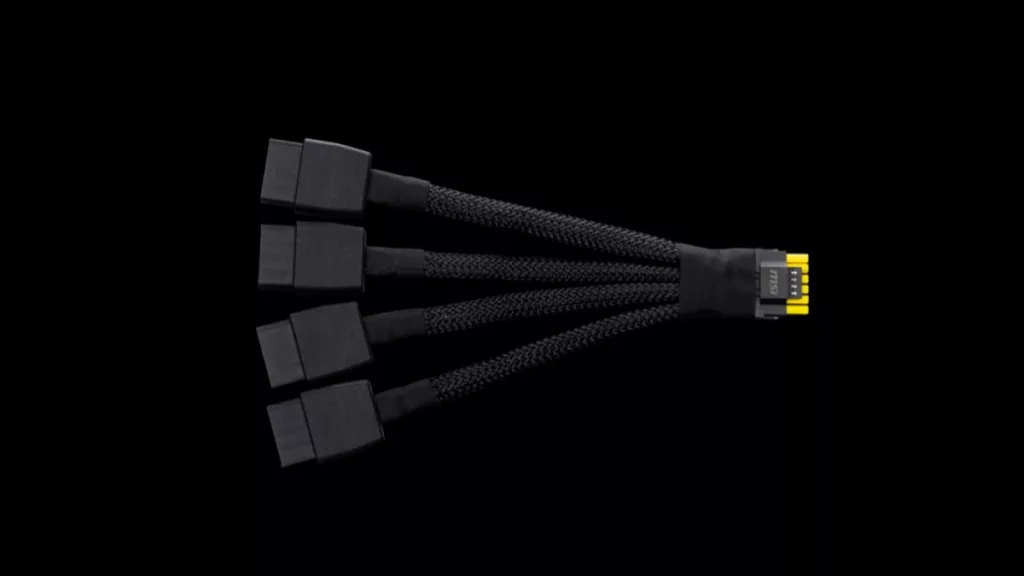

Multiple hardware manufacturers were asked which is better: using an adapter or the included PSU cable, and not all gave the same answer. It goes without saying that the 12VHPWR/12V-2×6 connector has a spotty reputation; however, one thing is certain: owners of graphics cards with this connector do not have clear guidance on which cable to use. Well, someone has at long last had the notion to ask multiple manufacturers just that question, and unfortunately, there’s still no clear indication for the right choice, but their answers might surprise some.

Use the “squid” adapter included with the graphics card
  • ASUS – The included adapter should be used.
  • GIGABYTE – Use their included adapter because it has been tested more.
  • MSI – Use their included adapter.
