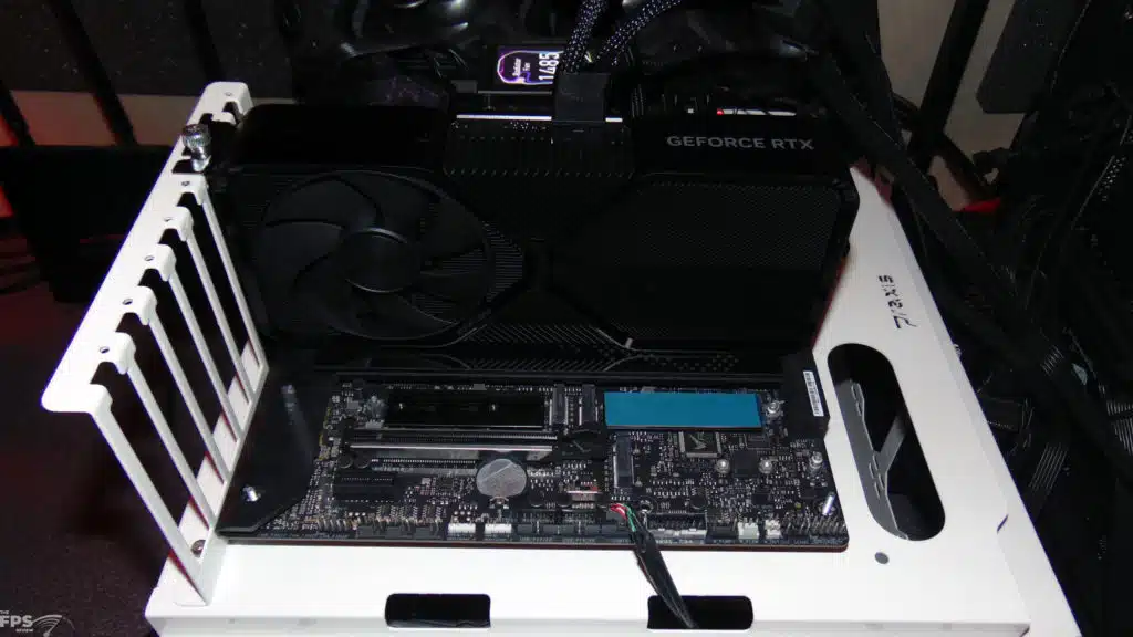

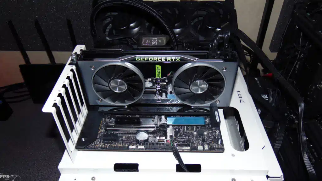

NVIDIA GeForce RTX 4070 SUPER Founders Edition On Left and NVIDIA GeForce RTX 2070 SUPER Founders Edition on Right

The GeForce RTX 2070 SUPER is based on the TU104 GPU die with 40 SMs, 2,560 CUDA Cores, 64 ROPs, 160 Texture Units, 320 Tensor Cores, and 40 RT Cores. The Boost Clock is 1770MHz. It has 8GB of GDDR6 on a 256-bit bus at 14Gbps providing 448GB/s of bandwidth. The TGP is 215W.

The GeForce RTX 4070 SUPER is based on the AD104 GPU die with 56 SMs, 7,168 CUDA Cores, 80 ROPs, 224 Texture Units, 224 Tensor Cores, and 56 RT Cores. The Boost Clock is 2475MHz. It has 12GB of GDDR6X on a 192-bit bus at 21Gbps providing 504GB/s of bandwidth. The TGP is 220W.
