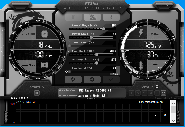

As we stated previously, we are using MSI Afterburner for overclocking for various reasons.  It’s less buggy than AMD WattMan, simple to use, and we simply have less trouble with it. It also now allows voltage manipulation on the Radeon RX 5700 series GPUs.

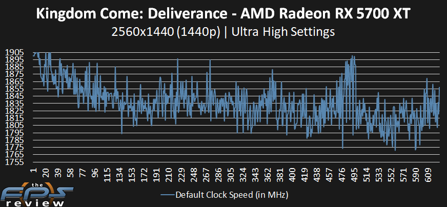

In the timeline graph above we are showing you the real-time GPU clock speed while playing a game on the Radeon RX 5700 XT.  The clock speed is a bit more dynamic and frantic on this video card compared to the Radeon RX 5700.  From this graph you can see that the clock frequency hovers mostly between 1795-1855MHz while gaming.  The “Game Clock” is 1755MHz, therefore the Radeon RX 5700 XT is boosting beyond the game clock while gaming.
This is a positive result and shows that it is not throttling the clock speed.  However, it is not reaching the “Boost Clock” of 1905MHz at all while gaming, this is the peak of what the boost clock is possible of, but it just can’t get there while gaming at default settings.  The average of all this clock frequency while gaming is 1836MHz.  This is definitely above the game clock.
Above you will see all the settings at default.  The GPU Temperature (which is die edge temperature) is 84c while gaming.  The Junction Temperature, or hottest spot on the die temperature, is 101c.  Also note the default voltage on this GPU is 1.193V.  The default fan speed was 42% on automatic.  System Wattage was 362W.  Ambient temp was 70F.
