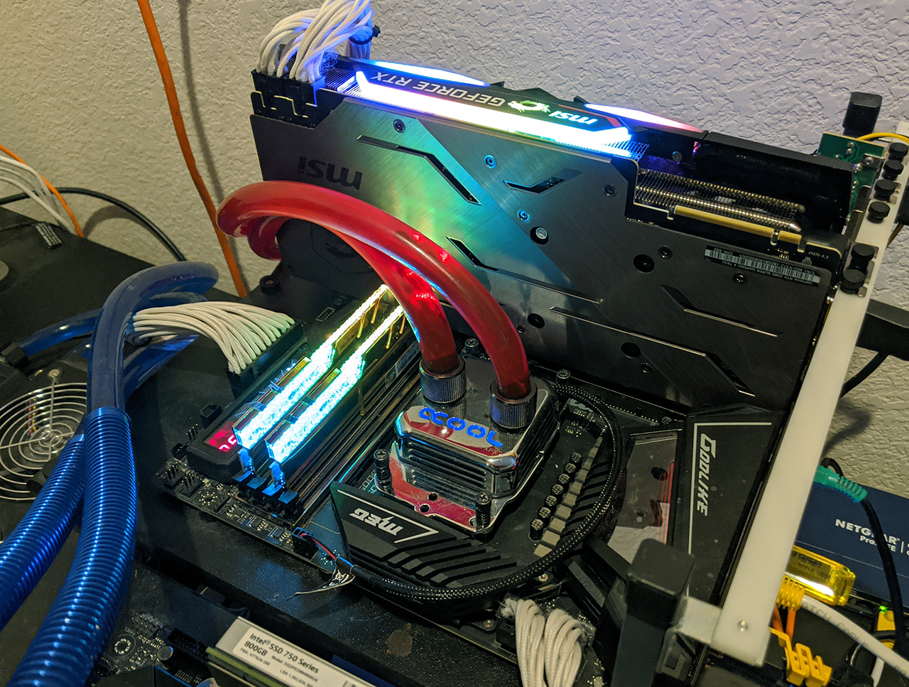

Using custom water and PB2 I saw temperatures upwards of 79c. When manually overclocked, things obviously got worse in some tests reaching temperatures of 85c in some cases. While this sounds kind of bad, its nothing compared to Intel’s Core i9 10980XE, which can actually hit 110c on some cores if you clock it to high.

We don’t have a high-end air cooler on hand or I’d have tested it. But based on the data we’ve seen and shared here, there is virtually no chance that you aren’t leaving at least some performance on the table by opting for air cooling instead of a high-end 360mm AIO at the very least. Custom water cooling will produce better results. Given the cost of building a good water cooling setup, I can see why some people would be hesitant to go that route despite spending $750 on a CPU. A good setup is going to be at least $400-$500 and it does require more maintenance to deal with and more skill to put it together. First-timers will waste more money than they need to by not accounting for every fitting, length of tubing, or flat cutting tubing wrong or whatever. They might need a different case or have to buy some tools to get the job done.
I’d say that at a minimum, you want a really good AIO for the 3950X. Custom water cooling will yield better results, albeit at a much higher cost.
