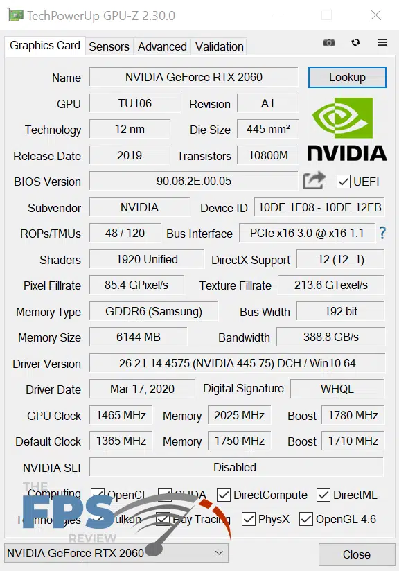

To get a sense for our baseline performance, the GeForce RTX 2060 FE has a stock base clock of 1365MHz, a stock boost clock of 1680MHz and operates its memory at 14GHz GDDR6. We pulled out Battlefield V and sat down for a gaming session and recorded the actual GPU clock to run at about rattle around between 1845MHz and 1860Mhz. We’ll call it 1852.5MHz which represents a 10.3% gain over the boost clock promised by its specifications.

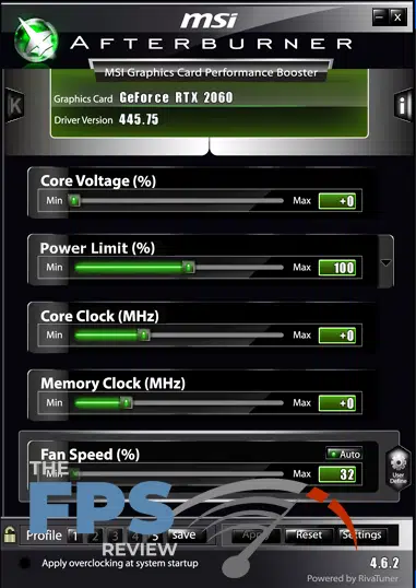

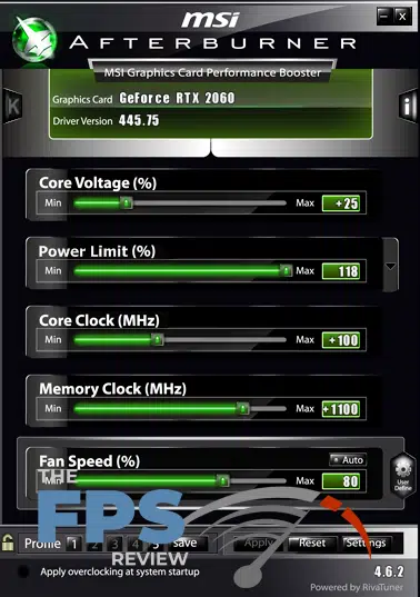

We overclocked the GeForce RTX 2060 FE by dialing up the power limit to +118, bumping the voltage to +25 mV and the fans up to 100% and then began increasing the GPU clock. After some trial and error, we settled on a +105 offset to the base clock. We then went back to a stock core clock and increased the memory speeds, yielding an additional 2200MHz of GDDR6 speed to bring us to a 16.2GHz GDDR6 rate. When we combined the two peak overclocks, we had to back off the core overclock to a +100 offset to stabilize the system. We then backed off the fans a bit to bring down the noise level and still maintained stability and temperatures lower than the stock configuration, leaving our fans set at 80%. You may notice that in most of these reviews we end up backing fans off to 80% as we find that there’s a significant difference in the amount of noise made between 80% and 100%.
After a few gaming sessions at our maximum stable overclock, we measured the actual GPU clocks within Battlefield V over the course of ten minutes to see how the boost clocks were working. It initially started at 1995MHz but quickly stepped down to 1980MHz within the first minute of gaming and stayed locked on that clock for the duration of our session. This is an additional 6.9% higher than the stock boost clock that we measured and an extra 15.7% gain on the memory.
