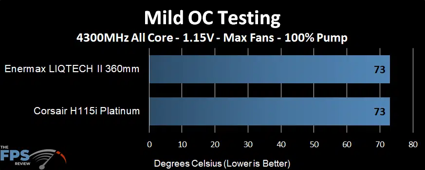

Max Fans – 100% Pump Speed
Temperature performance of the Enermax LIQTECH II 360 AIO at a mild overclock and max fans
Turning the fans up all the way tied the score with the two units even at 73 degrees Celsius. We noted that the max fan speed on the LIQTECH was 2250 RPM and the H115i was 1800 RPM.

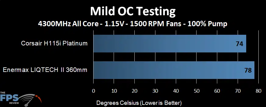

1500 RPM Fans – 100% Pump Speed
Temperature performance of the Enermax LIQTECH II 360 AIO at a mild overclock and 1500 RPM fans
Bringing the fans down to 1500 RPM boosted the Enermax LIQTECH II 360 temperatures by 5 degrees to 78 degrees Celsius, but the Corsair H115i only gave up one degree with a temperature of 74 degrees Celsius.

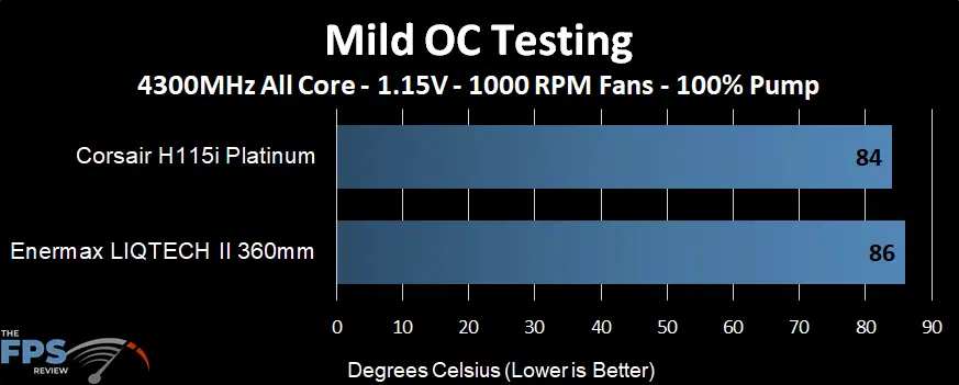

1000 RPM Fans – 100% Pump Speed
Temperature performance of the Enermax LIQTECH II 360 AIO at a mild overclock and 1000 RPM fans
With the fans set to 1000 RPM, the Enermax LIQTECH II 360 was able to sustain 86 degrees Celsius under load. However, the Corsair H115i Platinum was two degrees cooler at 84 degrees Celsius.
