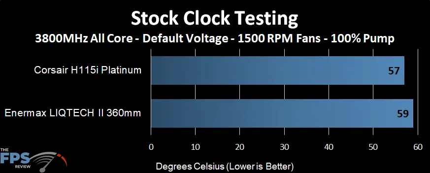

1500 RPM Fans – 100% Pump Speed
Dropping the fans slightly to 1,500 RPM brought the units added a little more distance with the Enermax LIQTECH II 360 at 59 degrees Celsius compared to the slightly cooler Corsair H115i Plaintum at 57 degrees Celsius.

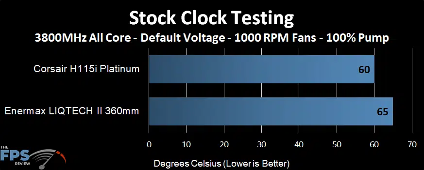

1000 RPM Fans – 100% Pump Speed
Lower the fans further to 1,000 RPM continued the trend with the Enermax LIQTECH II 360 checking in at 65 degrees Celsius and the Corsair H115i Platinum 8.3% cooler at 60 degrees Celsius.

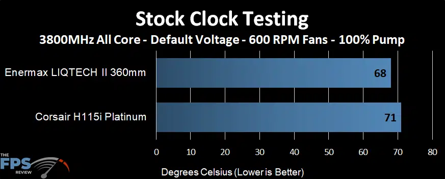

600 RPM Fans – 100% Pump Speed
Finally, down at 600 RPM with the pump still at 100% provided an audible whir in the room. The Enermax LIQTECH II 360 took the lead at 68 degrees Celsius. The Corsair H115i Platinum arrived at 71 degrees Celsius.

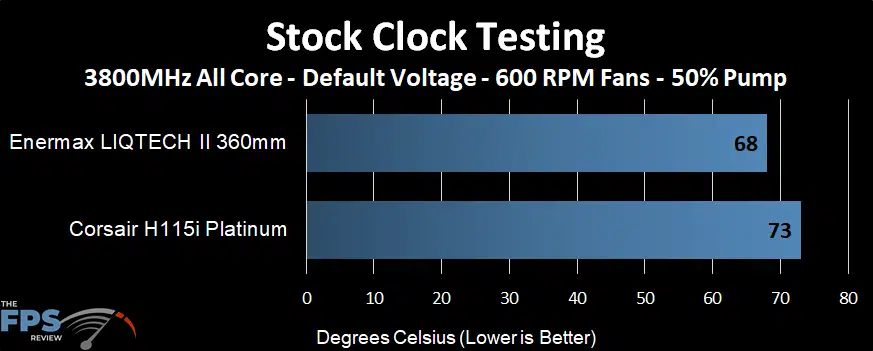

600 RPM Fans – 50% Pump Speed
To silence the pump, we dropped its speed to 50%, giving us our quietest configuration to test. The Enermax LIQTECH II 360 checked in at 68 degrees Celsius. This is 7.3% cooler than the Corsair H115i Platinum which landed at 73 degrees Celsius.
