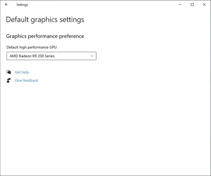

“If you’re a power user that has multiple high performance GPUs and would like to specify which of those GPUs should be the one used for high performance uses cases, you can now do that by going to Settings > System > Display > Graphics settings or Settings > Gaming > Graphics settings,” wrote Microsoft. “What this means is that an application that asks for a high-performance GPU will by default use the high-performance GPU you specify on this page.”

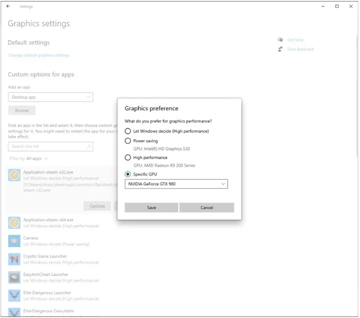

“Now if you want even more control, we have also added the ability for you to specify exactly which GPU you want an app to run on using the new “Specific GPU” option. As you can see below, an application can be set to run on your GPU of choice.”
