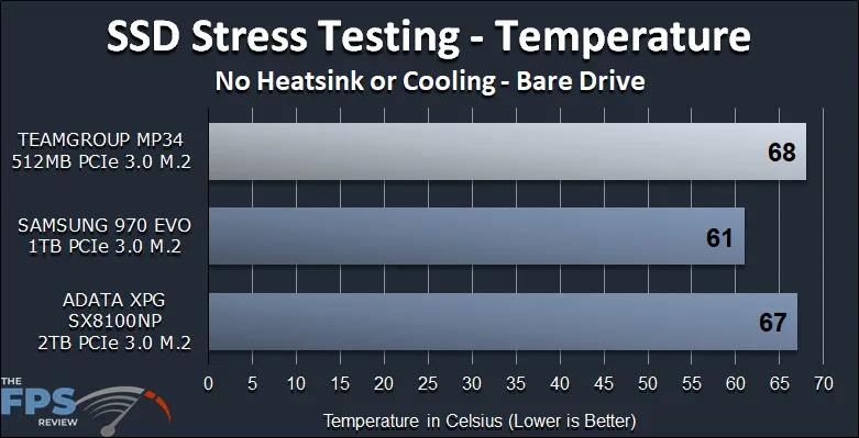

All of our SSDs are tested in the same way below, we have the same case fan blowing down on the SSDs with no heatsink attached, in an open-air system during benchmarking. We do this to ensure the best performance and no throttling when testing. Since we don’t install a heatsink, this active fan takes the place of the heatsink being installed. Temps should be similar when you install your M.2 heatsinks. For the temps shown in the graph below though, we have turned the fan off to see how hot each SSD can get with no heatsink installed and no active cooling.
TEAMGROUP MP34 512GB PCIe NVMe M.2 SSD Review Temperature Testing Graph
Out of all the SSDs, the TEAMGROUP MP34 SSD did get the warmest, but still very close to the ADATA XPG SX8100NP SSD. The SAMSUNG 970 EVO ran the coolest without a heatsink. We definitely started to see some throttling happen without any cooling. However, once we turned on a fan or installed a heatsink the temps went all the way down into the ’40s while operating. We definitely say, install that heatsink.
