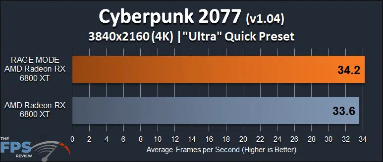

Cyberpunk 2077
In Cyberpunk 2077 we are using the 1.04 patch at time of testing, this was before 1.05 patch was released. It wouldn’t make a difference though in terms of RAGE MODE. Where we saw the same performance at 1440p, we see a slightly better performance at 4K with RAGE MODE. There is a 2% performance advantage using RAGE MODE. It’s not really enough to make a gameplay experience difference, but we can detect the small uplift in a run-through.

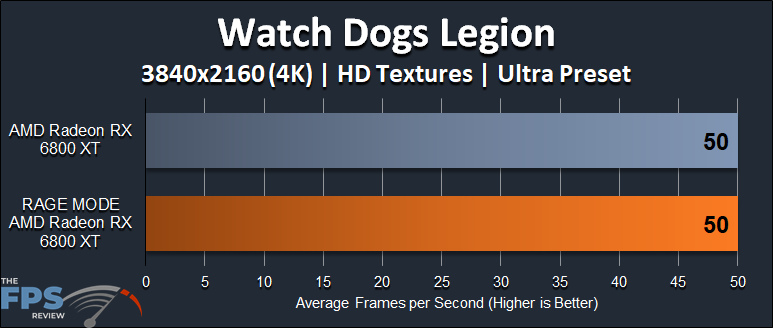

Watch Dogs Legion
In Watch Dogs Legion at 4K performance is identical between RAGE MODE and default performance.

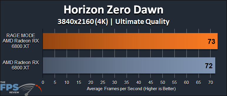

Horizon Zero Dawn
In Horizon Zero Dawn there is a 1FPS difference using RAGE MODE versus default performance at 4K.

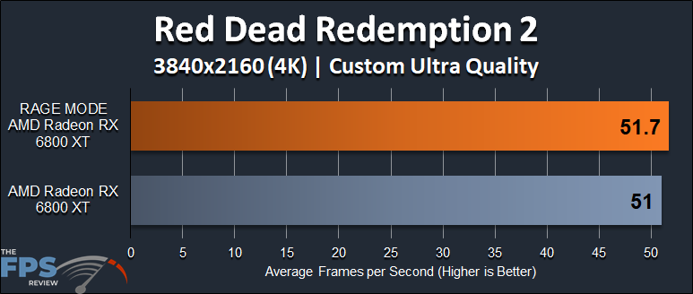

Red Dead Redemption 2
In Red Dead Redemption 2 there is a less than 1FPS difference with RAGE MODE versus default performance at 4K.

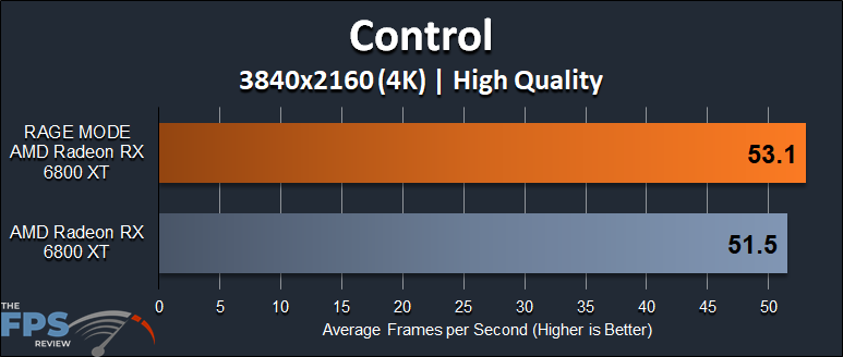

Control
Similar to 1440p, at 4K Control shows the “biggest” difference. RAGE MODE is 3% faster than default performance, so that is actually the best result.

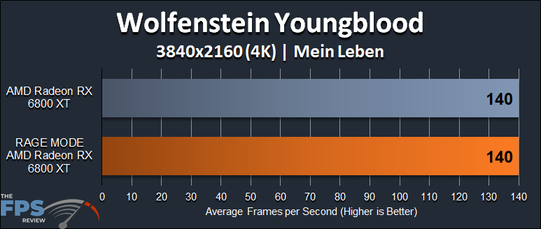

Wolfenstein Youngblood
In Wolfenstein Youngblood at 4K there is no performance difference, but at 1440p there was.

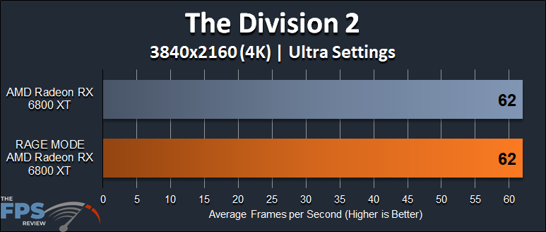

The Division 2
The Division 2 performs the same between RAGE MODE and default.

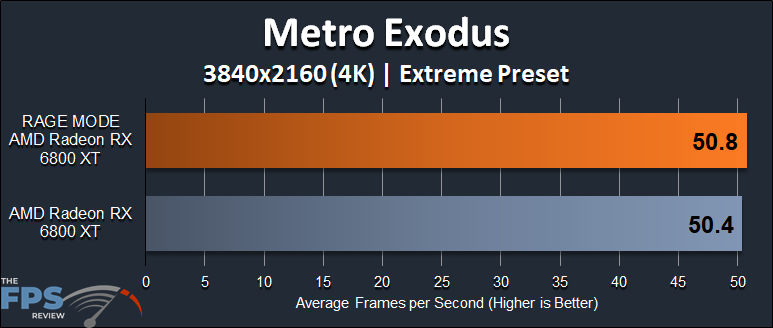

Metro Exodus
Metro Exodus is the same performance, within the margin of error between RAGE MODE and default.
