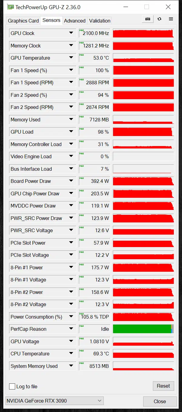

GPUz Sensor Data Overclocked
Here is the GPUz sensor data with the video card overclocked. Overclocked we can see that the GPU Temperature is 53c at 100% fan speeds.  The temperature is not holding back the overclock potential.  The TDP is maxed out at the 105% which we knew we would hit very quickly with this video card, there just isn’t much headroom.  The GPU Voltage did increase automatically with GPU Boost, it is now running at 1.0810V versus 1.0680V at default.  Therefore, GPU Boost is managing GPU Voltage and raising it for us to hit this high of a GPU Clock speed.  This is also why we are running into the TDP limit so quickly.
