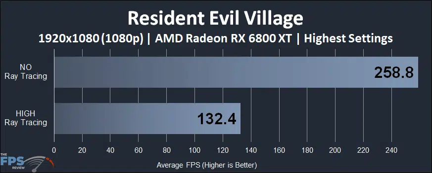

In this first graph, we are looking at the AMD Radeon RX 6800 XT at 1080p. We are comparing NO Ray Tracing and all settings on “HIGH” Ray Tracing. You can see that without Ray Tracing performance averages 258FPS. When we turn on HIGH Ray Tracing that drops to 132FPS which is still very playable, and well above 100FPS. That’s a drop though of 49% in performance. Therefore, turning on HIGH Ray Tracing caused the framerate to nearly drop in half.

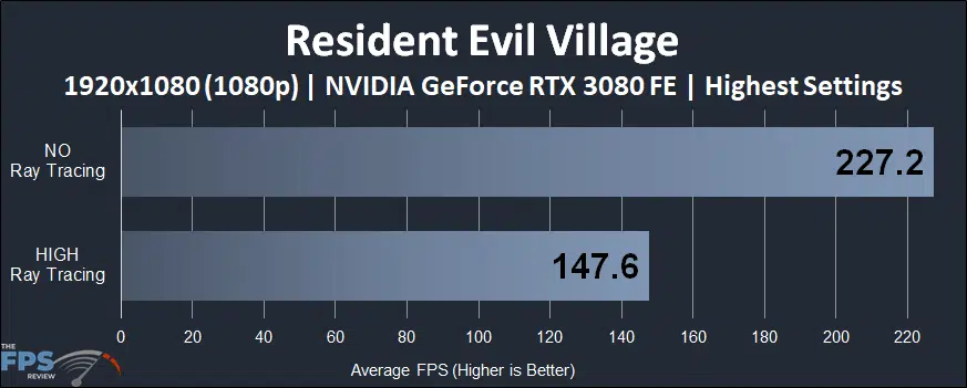

Now we are looking at the NVIDIA GeForce RTX 3080 FE doing the same comparison. It starts out at 227FPS without Ray Tracing and drops to 147FPS with HIGH Ray Tracing. That is a drop of 35% in performance. That’s a whole lot less than the 49% drop experienced with the AMD Radeon RX 6800 XT. The game is very playable at these settings.

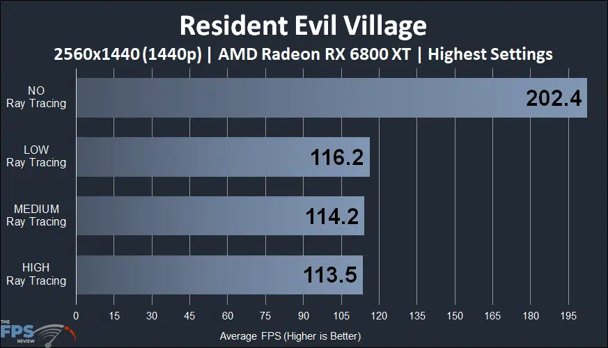

Now we are again looking at the AMD Radeon RX 6800 XT but at 1440p. We have now included LOW Ray Tracing, MEDIUM Ray Tracing and HIGH Ray Tracing so you see the whole gamut of settings performance. Without Ray Tracing it’s at 202FPS, and at HIGH it’s at 113FPS which is still very playable. Turning on LOW Ray Tracing drops performance 43%. Turning on HIGH Ray Tracing drops performance 44%. Between LOW and HIGH is only a 2% difference in performance.

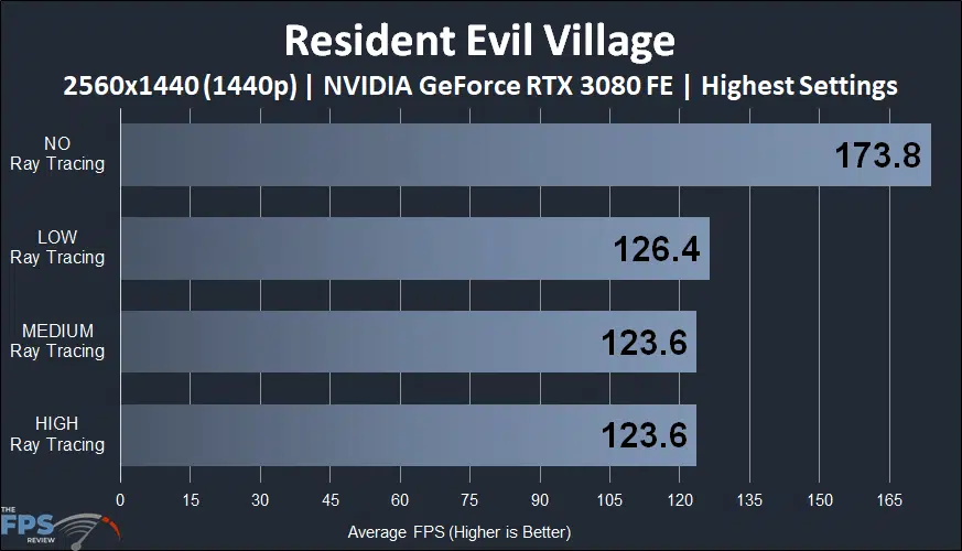

Now we are looking at the NVIDIA GeForce RTX 3080 FE at 1440p with all the Ray Tracing settings. It starts at 173FPS and on HIGH Ray Tracing drops to 123FPS which is very playable. The drop-down to LOW Ray Tracing is 27% and the drop-down to HIGH is 29%. This is much lower of a drop compared to the Radeon RX 6800 XT. The difference between LOW and HIGH is 2%.

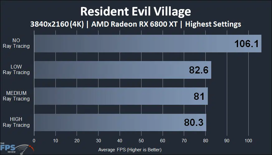

Now we are looking at the AMD Radeon RX 6800 XT at 4K. We start out at a very playable 106FPS and with HIGH Ray Tracing it’s still very playable at 80FPS! The drop in performance turning on LOW Ray Tracing is 22%. The drop going to HIGH Ray Tracing is 24%. The difference between LOW and HIGH is only 3%.

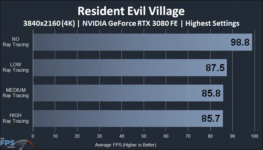

Now we are looking at the NVIDIA GeForce RTX 3080 FE at 4K. We start out at 98FPS and end up at 85FPS with HIGH Ray Tracing. The game is very playable. Turning on LOW Ray Tracing causes a drop of only 11%. Turning on HIGH Ray Tracing causes a drop of only 13%. The difference between LOW and HIGH is 2%.
