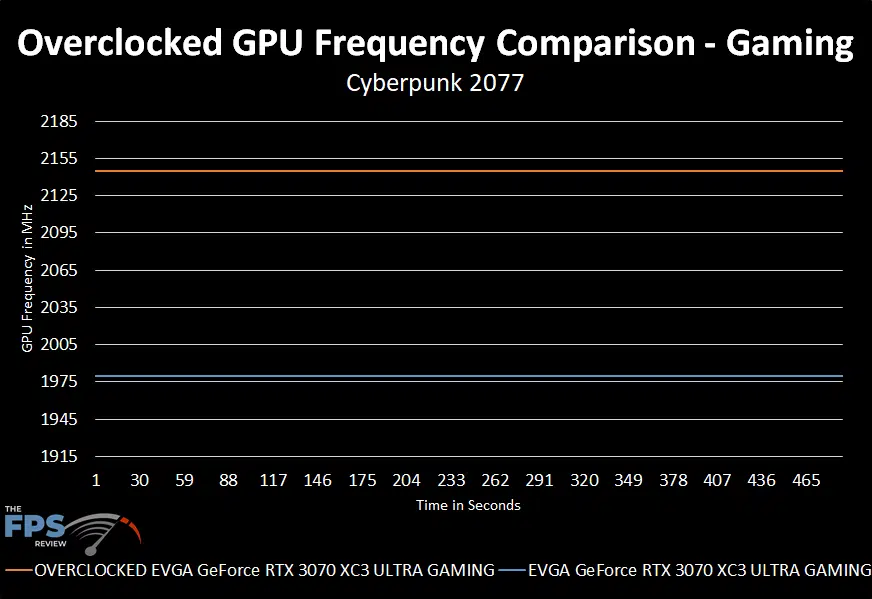

The EVGA GeForce RTX 3070 FTW3 ULTRA GAMING settled in at 1980Mhz during testing and maintained a temperature of 59 degrees Celsius. Comparing to the Founders Edition that averaged 1935MHz, the EVGA GeForce RTX 3070 FTW3 ULTRA GAMING checked in 45MHz faster. Memory in both the Founders Edition and the EVGA GeForce RTX 3070 FTW3 ULTRA GAMING is set to 14GHz using GDDR6 memory.

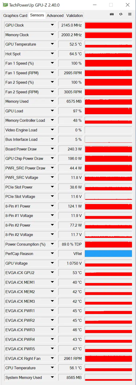

We started by maxing out the Power Target at 111% and boosted the GPU Temp Target up from 83C to 89C. We then cranked the fans up to 100%. There was not a knob present for modifying voltage, however, given the low power budgets on the RTX 30 Series that we have seen so far, adding voltage has not been necessary as it only increases power consumption and reduces how far GPU Boost will push the core clock speed up.

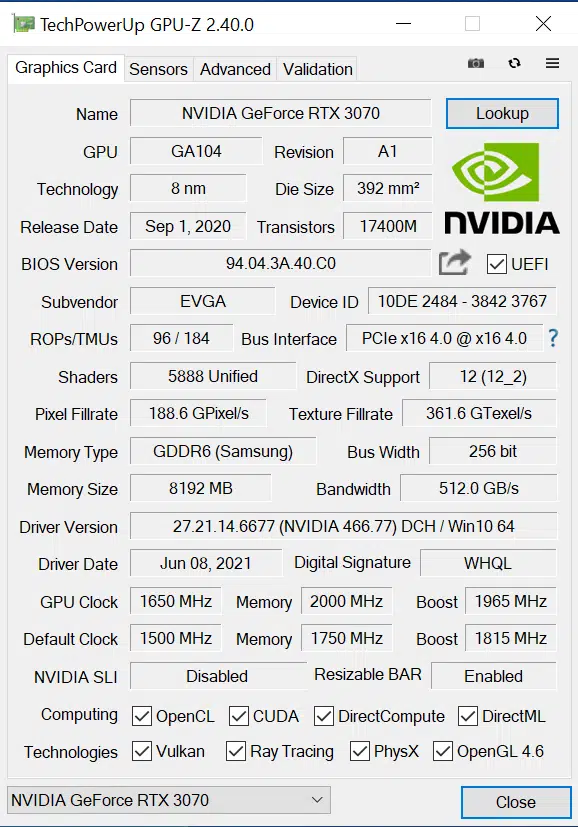

With the power matters settled, we started by pushing the core clock up as high as it could go without touching the memory side of the equation. We were able to pick up an extra 150 MHz on the slider offset before we started crashing.
Next up, we set the core back to stock and boosted the memory to see how far we could take it. It appeared to be happiest at +405MHz (+810MHz effective). This is a boost to 16GHz GDDR 6 over the stock of 14GHz GDDR6.
Putting it all together, this gave us a final stable overclock of 1650MHz core clock, 2000MHz boost clock, and 16GHz memory clock.
Comparing the sustained GPU frequency to the stock frequency, we see that the observed overclocked frequency averaged out to 2145MHz. This is a 10.8% increase over the stock clocks and stock Founders Edition performance. The memory at 16GHz is 14.2% faster than the stock clock as well.
