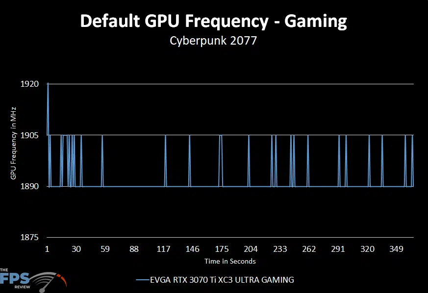

EVGA GeForce RTX 3070 Ti XC3 ULTRA GAMING default GPU clock performance
The EVGA GeForce RTX 3070 Ti XC3 ULTRA GAMING settled in around 1890MHz with the occasional bump up to 1905MHz during testing and maintained a temperature of 75.1 degrees Celsius. Compared to the Founders Edition that averaged 1875MHz, the EVGA GeForce RTX 3070 Ti XC3 ULTRA GAMING declares victory over the Founders Edition by about 15MHz.  Memory in both the Founders Edition and the EVGA GeForce RTX 3070 Ti XC3 ULTRA GAMING is set to 19GHz using GDDR6X memory.

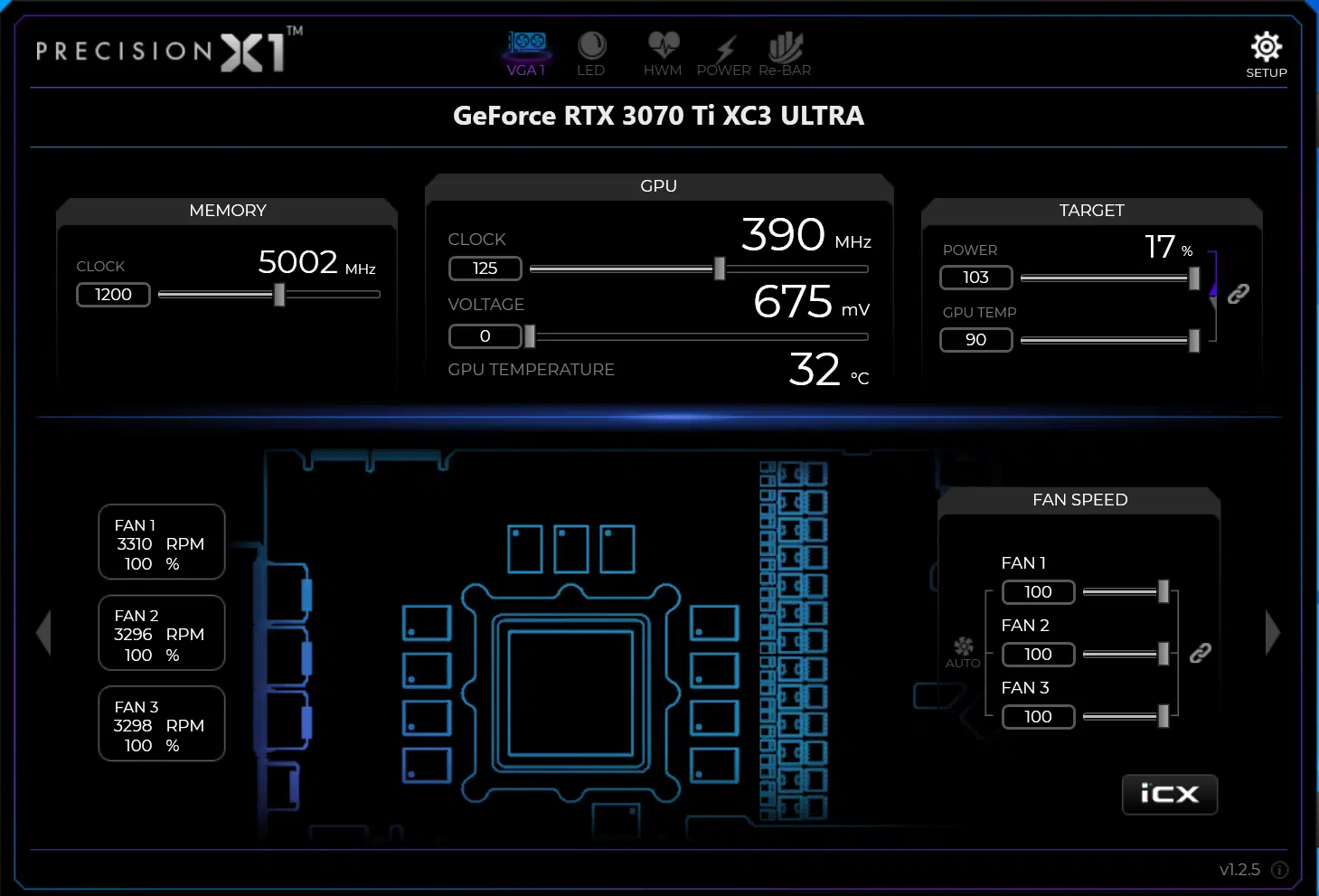

To dial in the maximum overclock for the EVGA GeForce RTX 3070 Ti XC3 ULTRA GAMING, we used EVGA’s Precision X1 software that makes lots of knobs to turn and levers to pull available for tuning enjoyment.

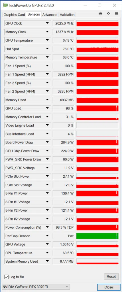

EVGA GeForce RTX 3070 Ti XC3 ULTRA GAMING GPUz system health monitor results while overclocked
We started by maxing out the Power Target at 103% and boosted the GPU Temp Target up from 83C to 90C. We then cranked the fans up to 100%. There was not a knob present for modifying voltage, however, given the low power budgets on the RTX 30 Series that we have seen so far, adding voltage has not been necessary as it only increases power consumption and reduces how far GPU Boost will push the core clock speed up.
With the power matters settled, we started by pushing the core clock up as high as it could go without touching the memory side of the equation. We were able to pick up an extra 125 MHz on the slider offset before we started crashing.
Next up, we set the core back to stock and boosted the memory to see how far we could take it. It appeared to be happiest at +1200MHz (2400MHz effective). This is a boost to 21.4GHz GDDR 6X over the stock of 19GHz GDDR6X.

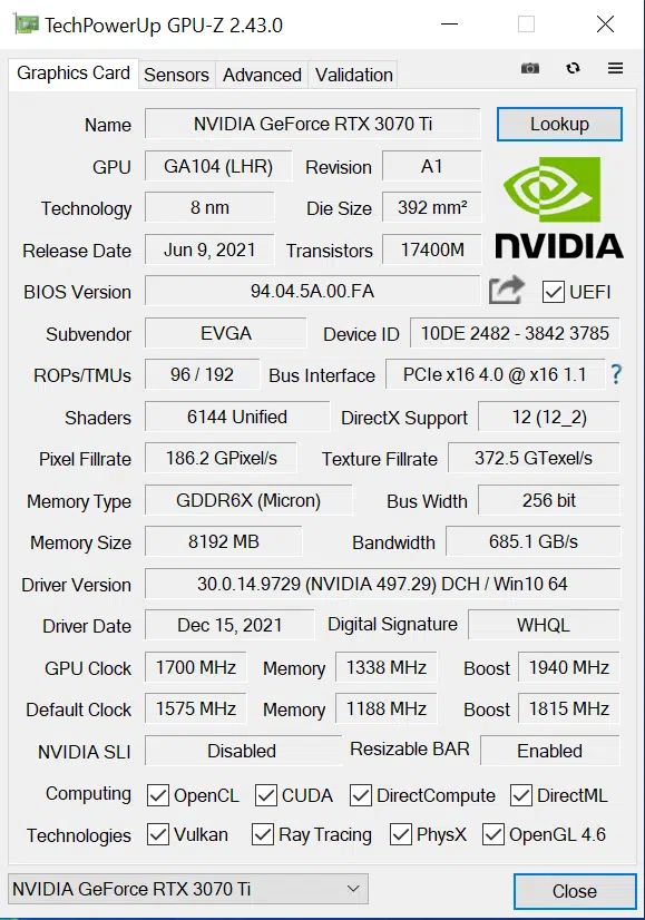

Putting it all together, we first tried our max individual clocks together to see how it worked. This gave us a final stable overclock of 1700MHz core clock, 1940MHz boost clock and 21.4GHz memory clock.

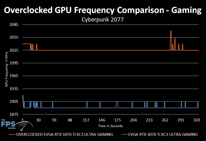

EVGA GeForce RTX 3070 Ti XC3 ULTRA GAMING overclocked gpu clock performance
Comparing the sustained GPU frequency to the stock frequency, we see that the observed overclocked frequency averaged out to 2025MHz. This is a 7.1% increase over the stock clocks and a 8% boost over the stock Founders Edition performance. The memory at 21.4GHz is 12.6% faster than the stock clock as well.
