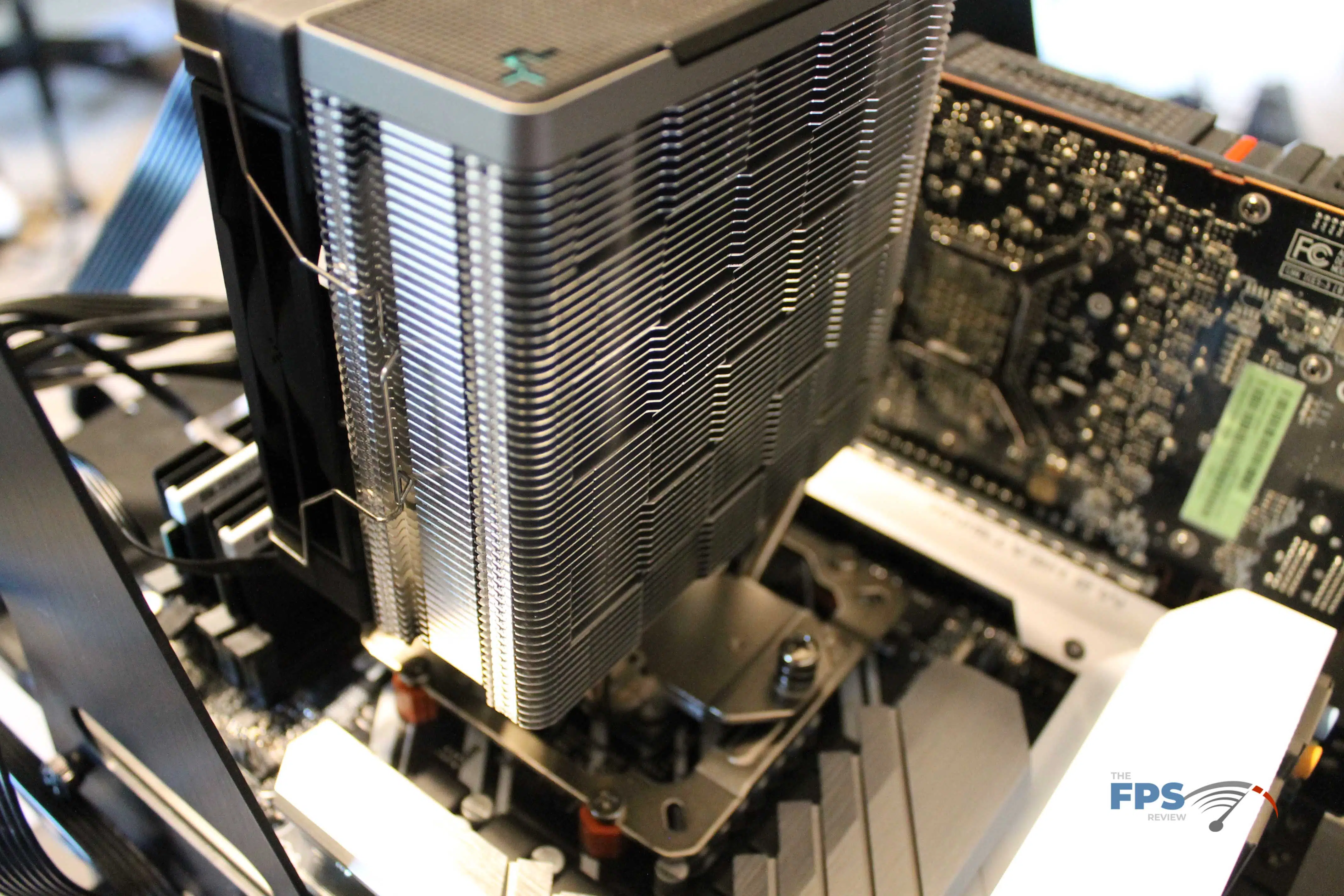

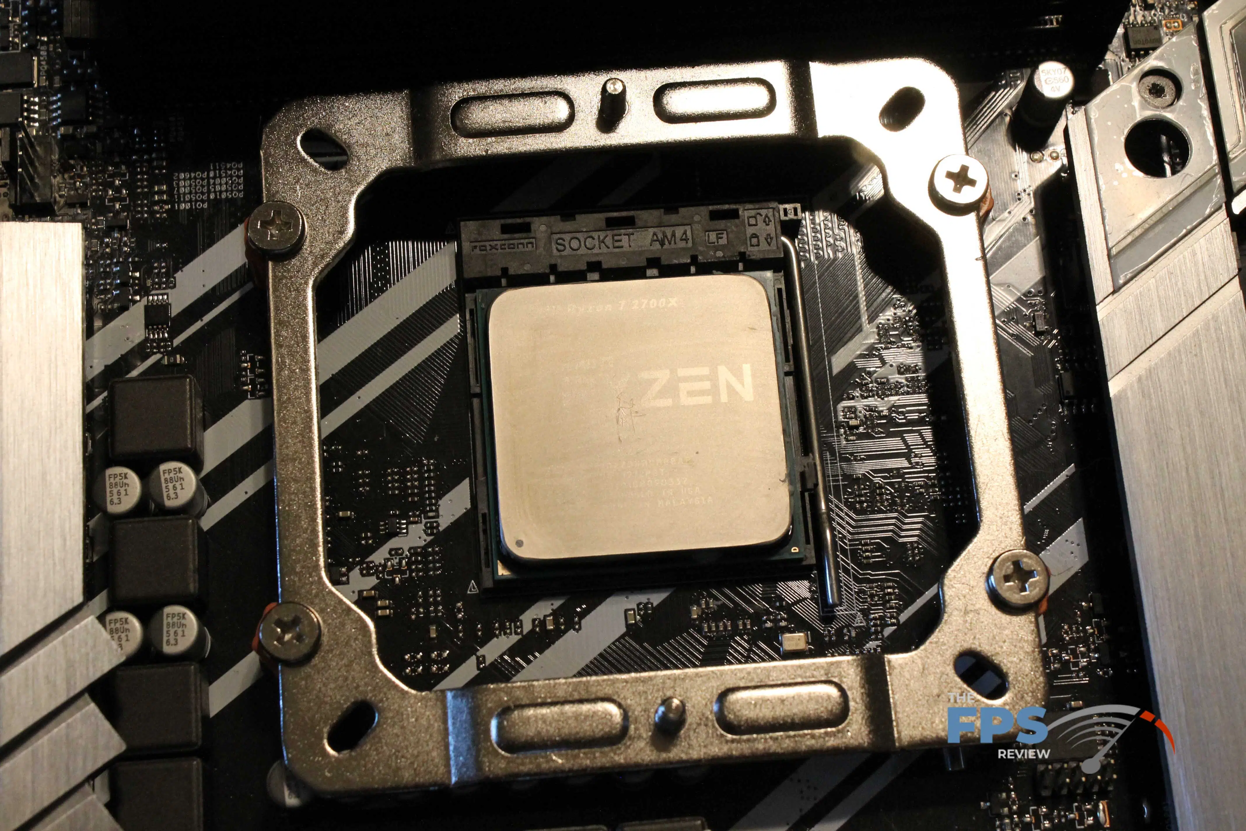

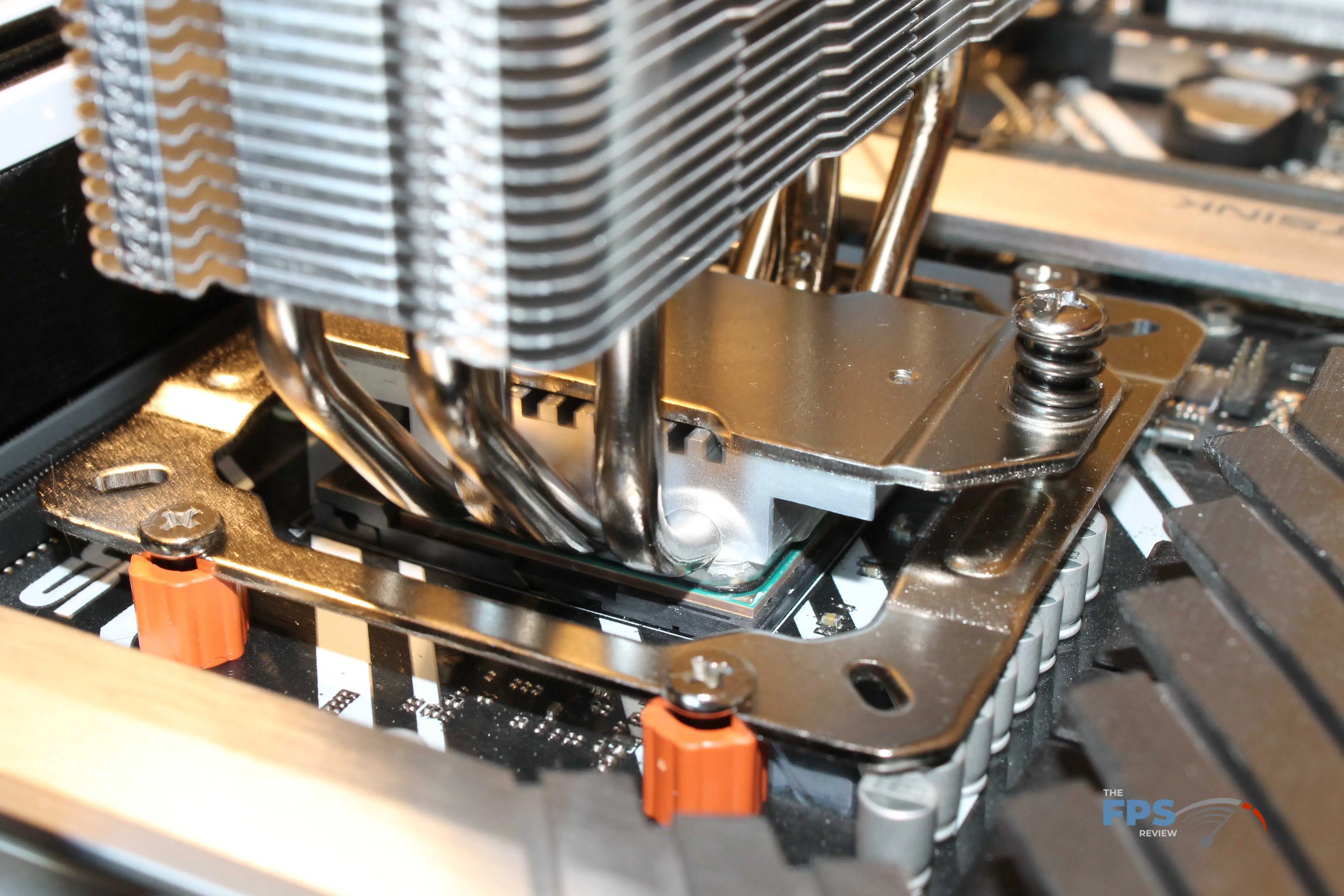

DeepCool AK400 AM4 bracket installed
DeepCool says the AK400 has an improved installation method that is made easy with a sturdy all-metal mounting bracket and a quick five-step process to safely fasten your cooler on multiple platforms. Installation on the AM4 socket utilizes the standard backplate that comes with your motherboard. Overall, we felt like we needed three hands to hold everything together as the spacer that connects the backplate to the mounting bracket doesn’t exactly stick while you’ve got to have all of them in place to get it secured. Once we were able to get that set and put our third hand back in our pocket, it was quite simple to finish the job.
It would have also been nice to have the bags of parts labeled as the bits for Intel and AMD setups look very similar.
With everything comfortably situated, let’s see if the DeepCool AK400 is ready to be cool!
