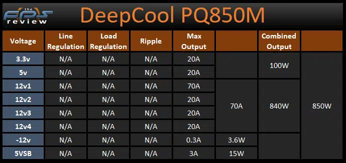

PQ850M power table

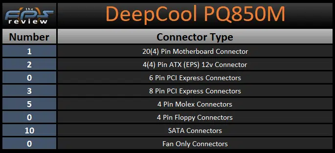

The PQ850M is advertised as being a single 12v rail power supply with a capacity up to 70A (or ~99% of the unit’s capacity) if necessary. The minor rails (5v and 3.3v) have a capacity of 20A each and the combined capacity of those two rails is 100W. Combined with these outputs, we find that this unit has just 3 PCIe connectors, 10 SATA connectors, and 3 Molex connectors. Given the low total 5v and 3.3v capacity, this makes for a strange arrangement. It is like this unit is meant to be used in systems with stacks of hard drives by the connector count but is then chocked by the power available to those drives.

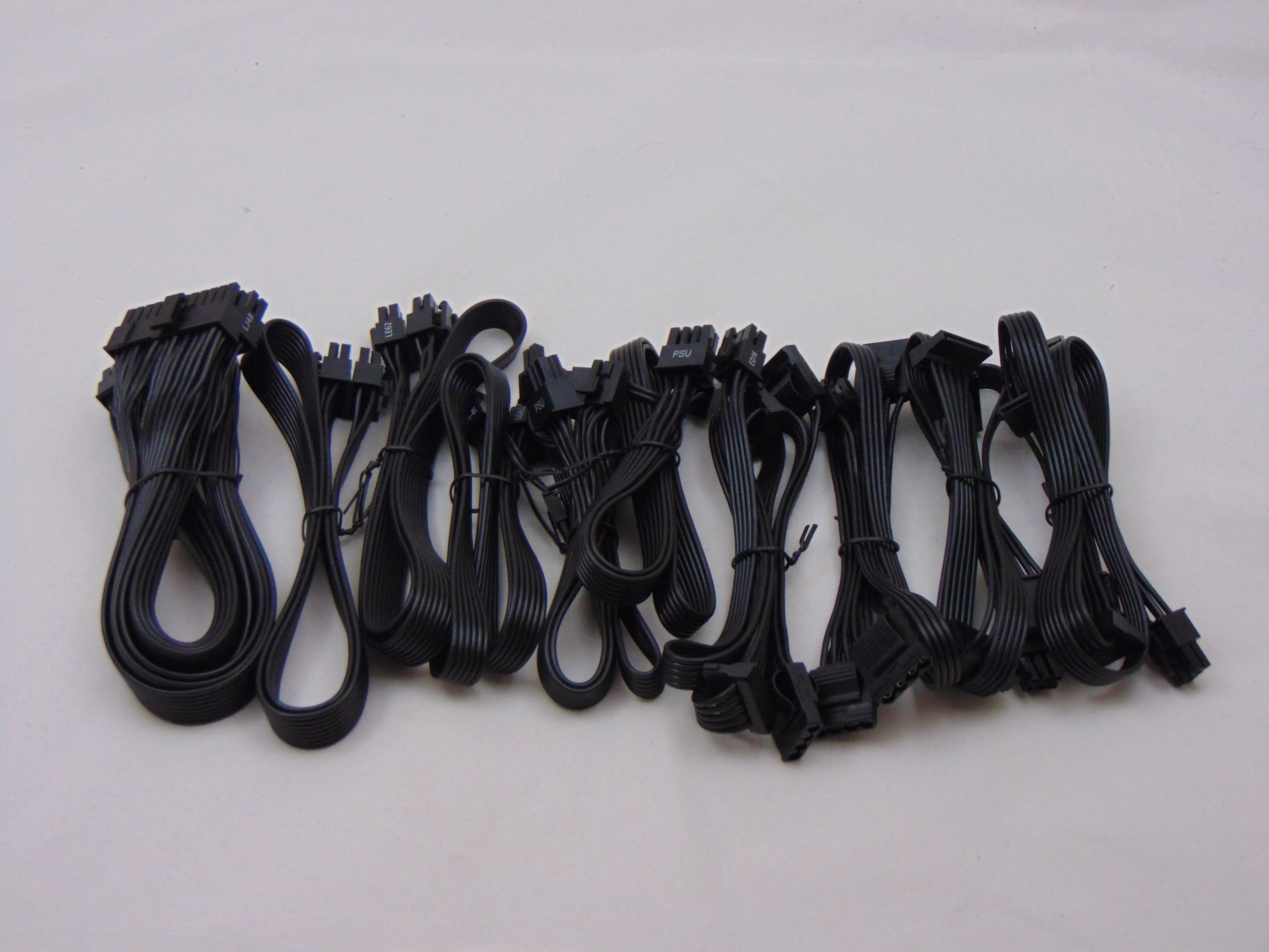

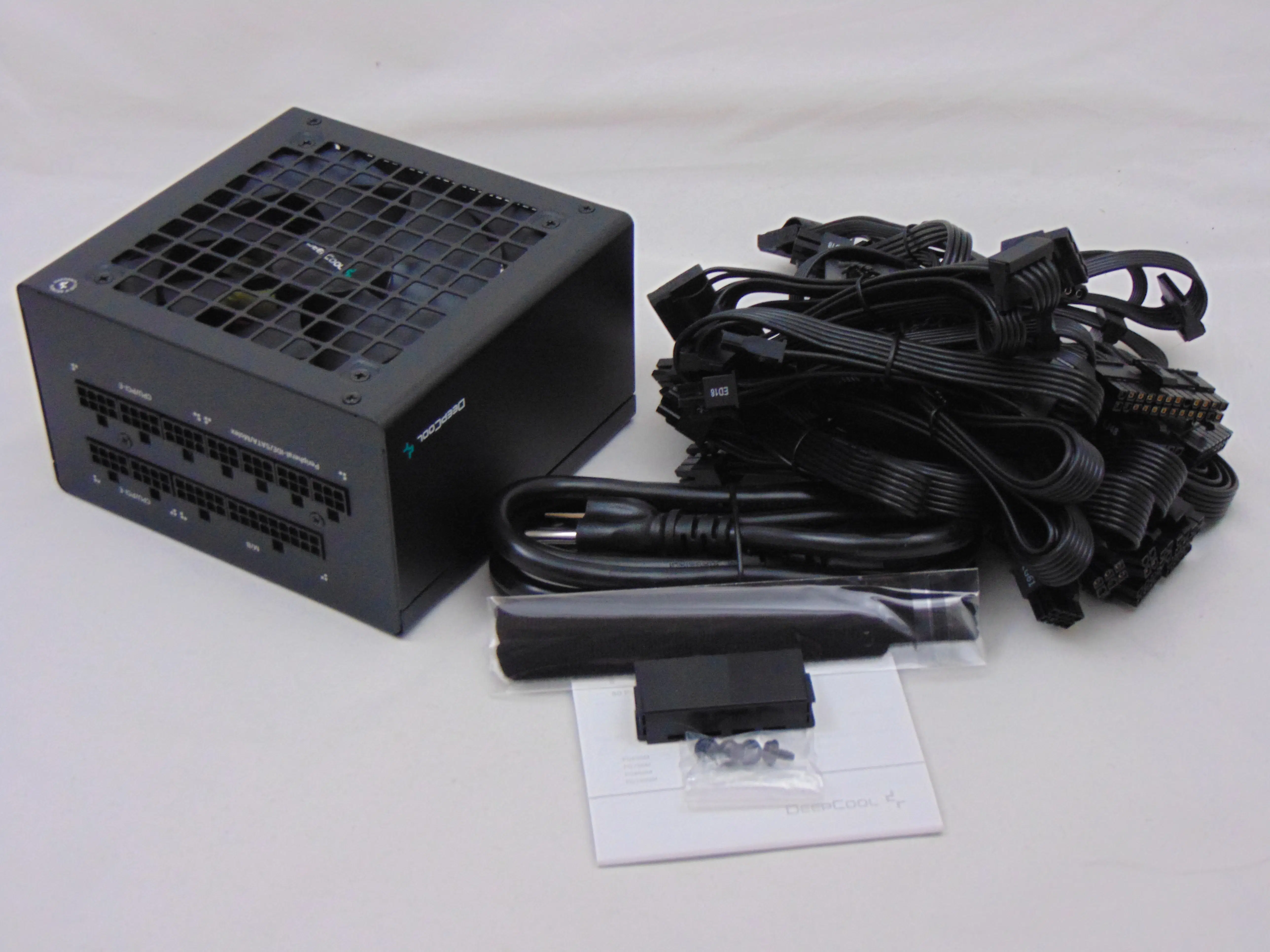

Once we open the DeepCool PQ850M packaging we find the power supply, mounting screws, modular cables, the power cord, some Velcro straps, and the user manual. The user manual is very short and not informative in the least. Let’s move on to the unit itself now.
