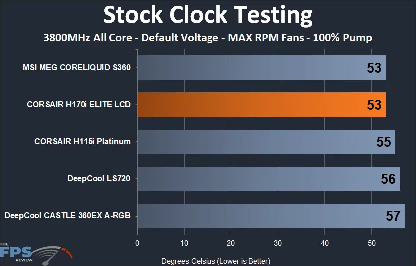

Max Fans – 100% Pump Speed
CORSAIR H170i ELITE LCD stock clock max RPM testing results
One thing to note with the CORSAIR H170i ELITE LCD is that our test sample’s ML140 fans maxed out at 1500RPM, which is in the ballpark of the rated 1600RPM +/- 10%. With that, we will still compare it at its maximum performance against the competition and again with its competition set at 1500RPM. Overall, 140mm fans tend to have a slower maximum speed than 120mm fans.
Starting the bidding at maximum cooling capacity the CORSAIR H170i ELITE LCD draws a tie with the MSI MEG CORELIQUID S360 at 53 degrees Celsius. Of note, the MSI solution was running in the low 2000 RPM range, which helped it level the playing field against the CORSAIR H170i ELITE LCD.

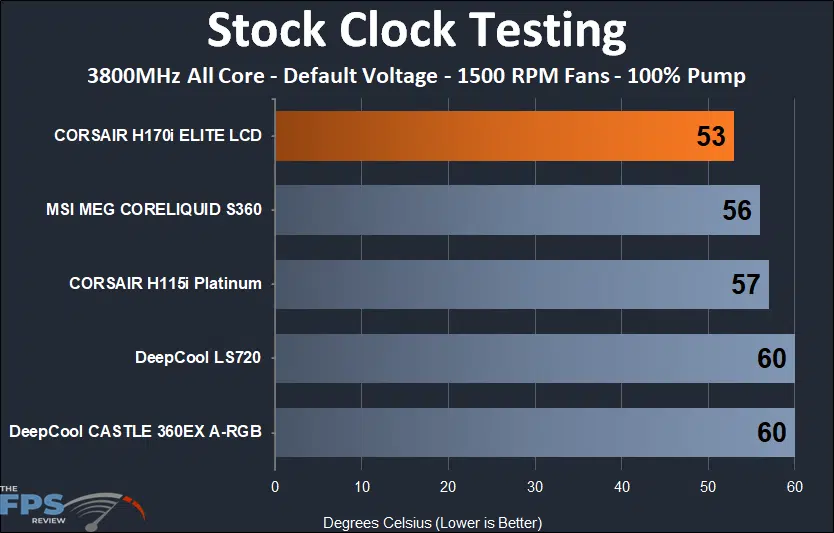

1500 RPM Fans – 100% Pump Speed
CORSAIR H170i ELITE LCD stock clock 1500 RPM testing results
Putting all coolers on the same footing at 1500RPM fan speed, the CORSAIR H170i ELITE LCD is obviously still at 53 degrees Celsius while the MSI MEG CORELIQUD S360 drops back to 56 degrees. The balance of the field turns in 1-4 degrees worse performances than the MSI at this setting.

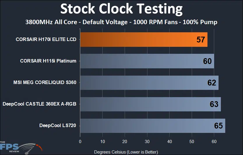

1000 RPM Fans – 100% Pump Speed
CORSAIR H170i ELITE LCD stock clock 1000 RPM testing results
Dropping down to 1000 RPM, we find the CORSAIR H170i ELITE LCD widens its lead over the MSI MEG CORELIQUID S360 to five degrees, however, the CORSAIR H115i Platinum (the only other cooler here with a 140mm fan) jumps up the standings to second place.
