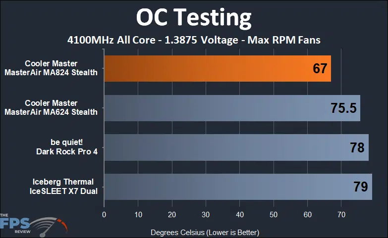

Max Fans
Cooler Master MASTERAIR MA824 STEALTH overclocked max rpm testing
Running our HSFs at full tilt leads to the Cooler Master MASTERAIR MA824 STEALTH posting a temperature of 67 degrees Celsius whoops the competition with the MASTERAIR MA624 up at 75.5 degrees Celsius and the be quiet! Dark Rock Pro 4 at 78 degrees Celsius. The X7 Dual brought up the rear at a temperature of 79 degrees Celsius.
Keep in mind that maximum fan speed varies between the units in this test – the Cooler Master MASTERAIR MA824 STEALTH topped out at 1900 and 1550 RPM, the Iceberg Thermal IceSLEET X7 Dual topped out at 1600 RPM, the be quiet! Dark Rock Pro 4 has the lowest max fan rpm at 1500 RPM and the Cooler Master MASTERAIR MA624 STEALTH tipped in just under 1500 RPM.

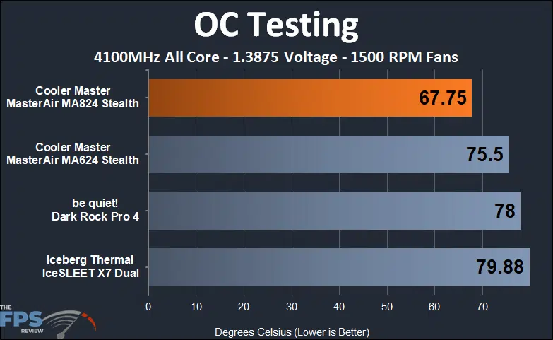

1500 RPM Fans
Cooler Master MASTERAIR MA824 STEALTH overclocked 1500 rpm testing
At the 1500 RPM fan speed, the Cooler Master MASTERAIR MA824 STEALTH leads the charge at 67.75 degrees Celsius with the MASTERAIR MA624 Stealth trailing behind at 75.5 degrees Celsius. The be quiet! Dark Rock Pro 4 landed at 78 degrees Celsius while the Iceberg Thermal IceSLEET X7 Dual was right on its heels at 79.88 degrees Celsius.

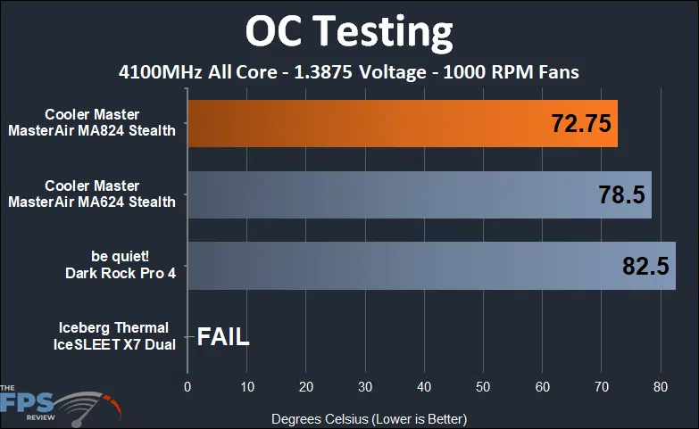

1000 RPM Fans
Cooler Master MASTERAIR MA824 STEALTH overclocked 1000 rpm testing
At the 1000 RPM fan speed, the Cooler Master MASTERAIR MA824 STEALTH posted a temperature of 72.75 degrees Celsius with the MASTERAIR MA624 STEALTH about 6 degrees behind at 78.5 degrees Celsius. The be quiet! Dark Rock Pro 4 posted a value of 82.5 degrees Celsius. Iceberg Thermal IceSLEET X7 Dual failed to keep the temperature in check here and our system crashed.
