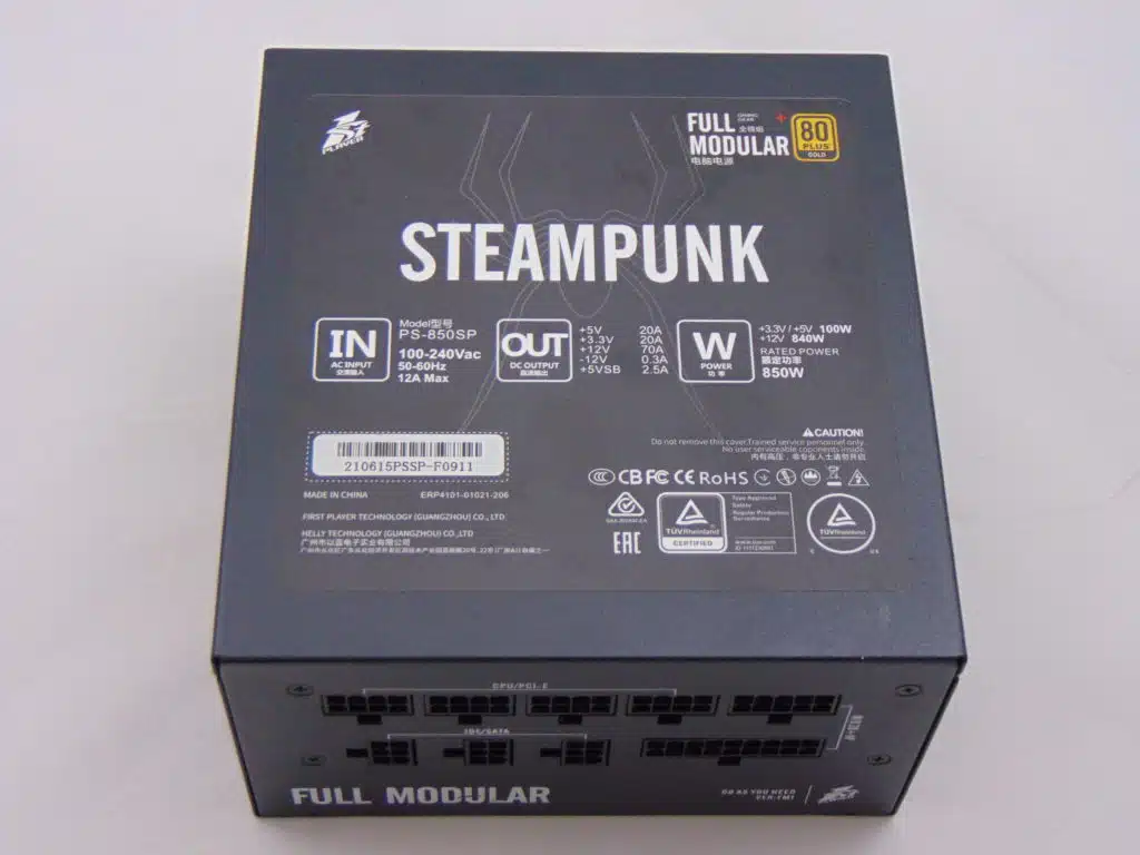

STEAMPUNK 850W Label
STEAMPUNK 850W Top

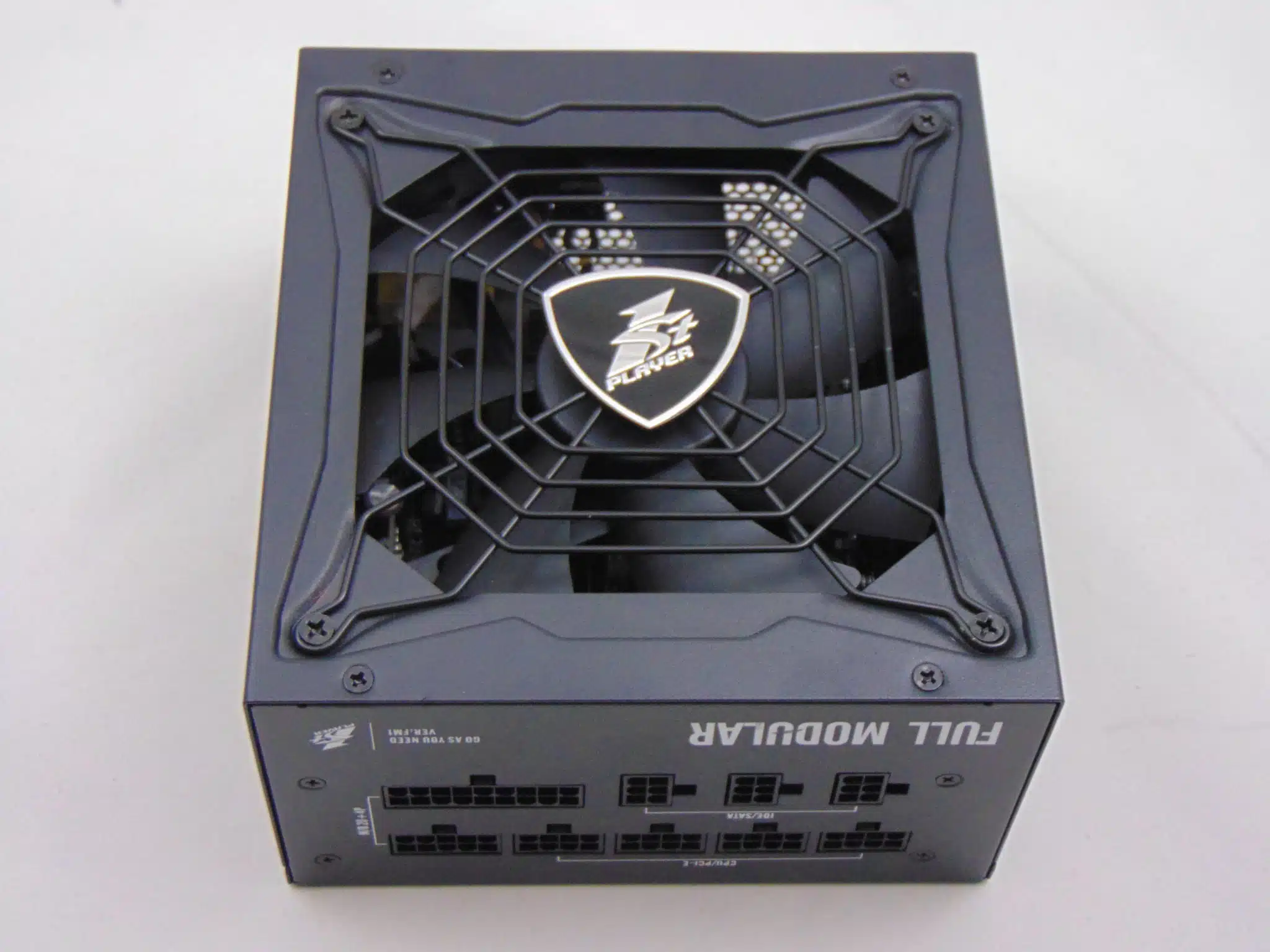

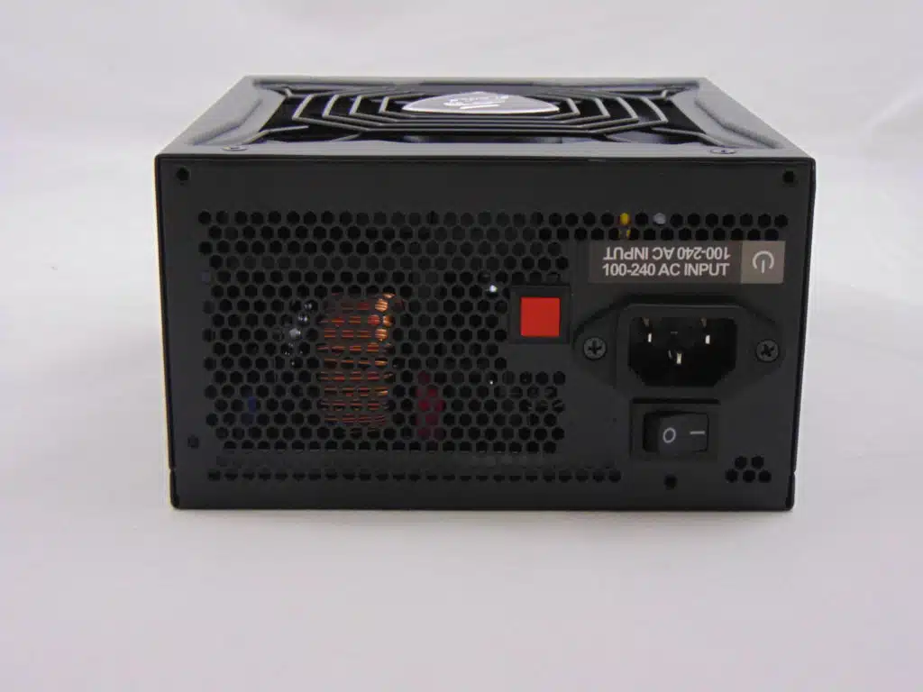

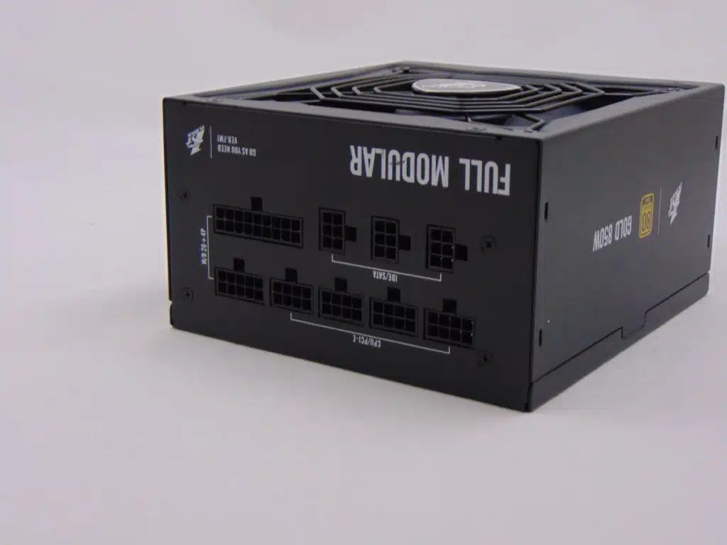

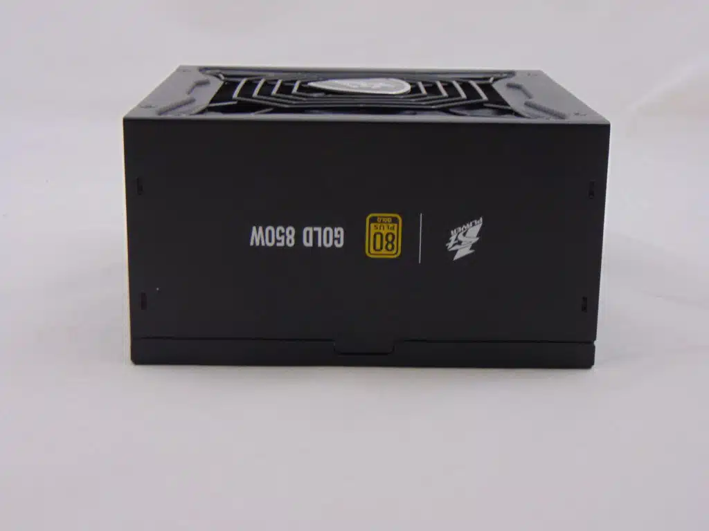

If we had not previously seen the 1STPLAYER SFX 750W Platinum we might say that the exterior of the 1STPLAYER STEAMPUNK 850W is better than expected. However, since we do have a reference point we are not really surprised today. The overall look of the 1STPLAYER STEAMPUNK 850W is generally nice if a bit on the no-frills side of things. Well, except for the spider. (What is the deal with the spider? )
The finish is a typical flat black with accenting text/labels in silver or gold. The modular interface is well-labeled as well which is always nice to see. Other than that, the only standout items are the unique fan guard and 1STPLAYER branding found on it.

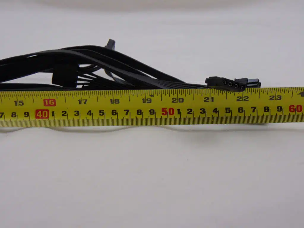

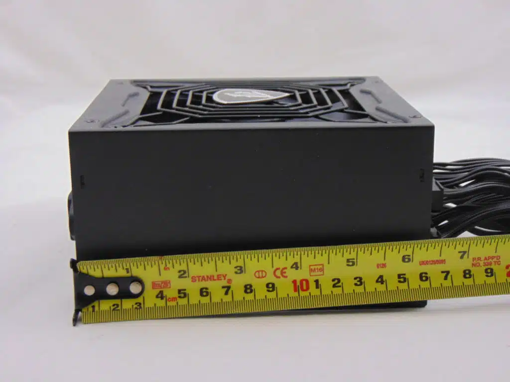

The 1STPLAYER STEAMPUNK 850W comes in at a total length of ~6 1/4 inches while the cables come in at a length of ~16″ to 23″ to the first or only connector. Additionally, the cables are all FlexForce-style cables or standard-sleeved cables.

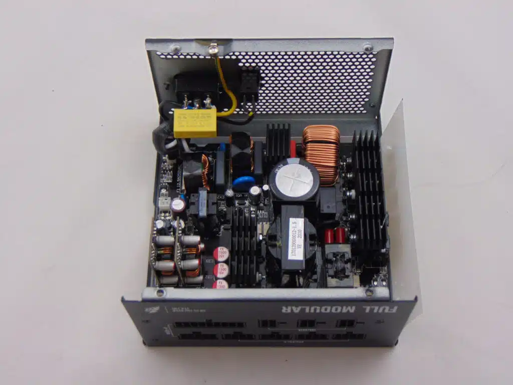

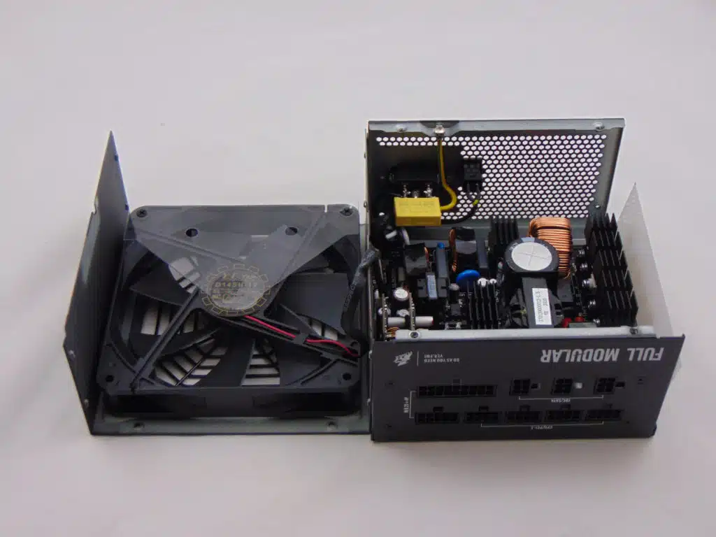

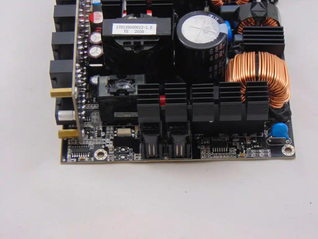

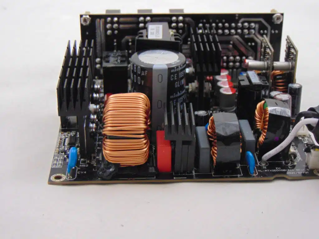

Once we open the top of the 1STPLAYER STEAMPUNK 850W, we see a rather normal-looking modern power supply built by Helly (which seems to be heavily influenced by certain Enhance platforms). Interestingly though, the topology features a a half bridge LLC primary (instead of a full bridge at this power level) with a synchronous rectification secondary and DC-DC VRMs for the minor rails.
The fan cooling this unit today is a 140mm sleeve bearing fan provided by Yate Loon and rated 0.70A at 12v. While sleeve-bearing fans are generally good from a noise standpoint they are not great from a longevity standpoint. On top of that, this is a really high-powered sleeve-bearing fan….so….ehhhhh.

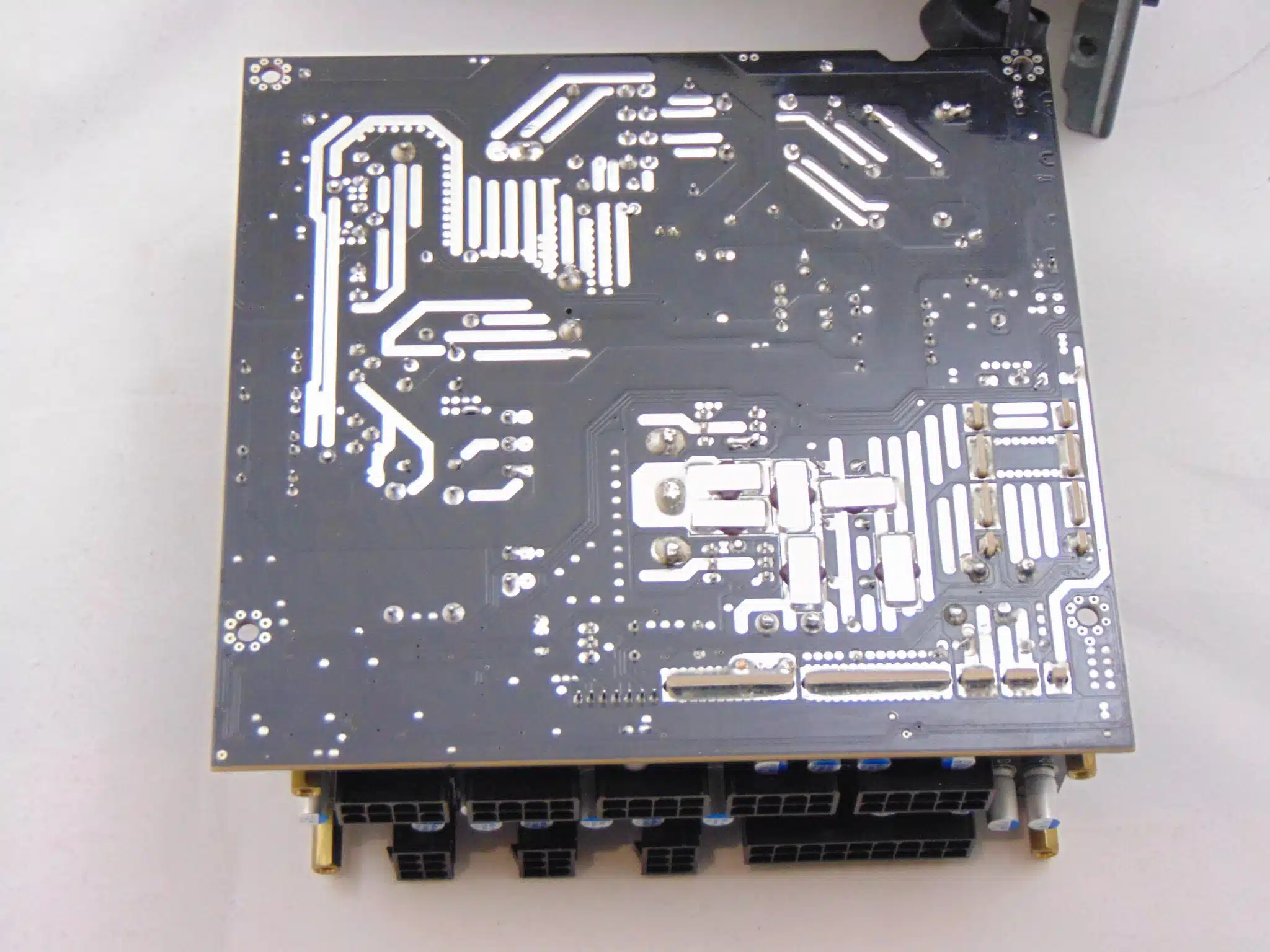

Lastly, the soldering is neat with no major hand touch-ups visible which is new from Helly and may indicate some more automated production processes on this unit.

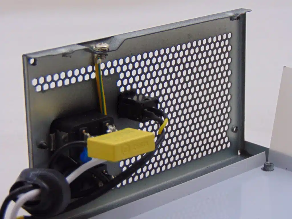

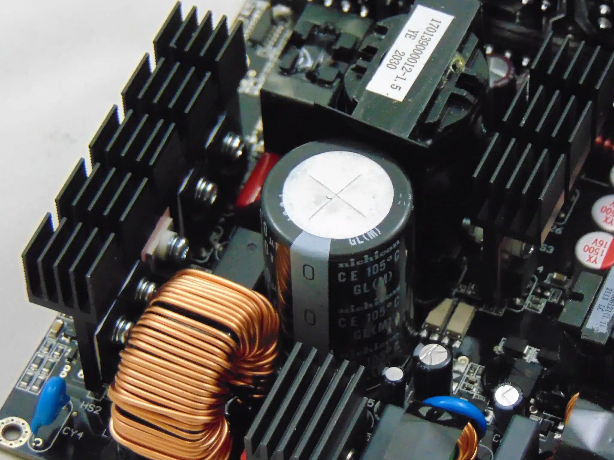

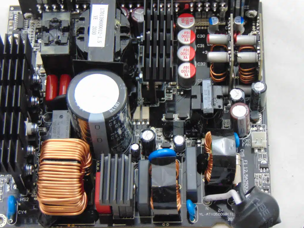

The 1STPLAYER STEAMPUNK 850W input filtering begins upon the housing itself where we find some X capacitors and Y capacitors. The balance of the input filtering is found on the back edge of the main PCB. There are the bridge rectifiers next in line attached to a heatsink. The APFC power components are next and they are followed by the APFC coil. Speaking of this heatsink, the main input capacitor is right next to it and it is provided by Nippon Chemi-con with a rating of 400v 470uF 105C. Next to this are the main switchers attached to another substantial heatsink in the unit.

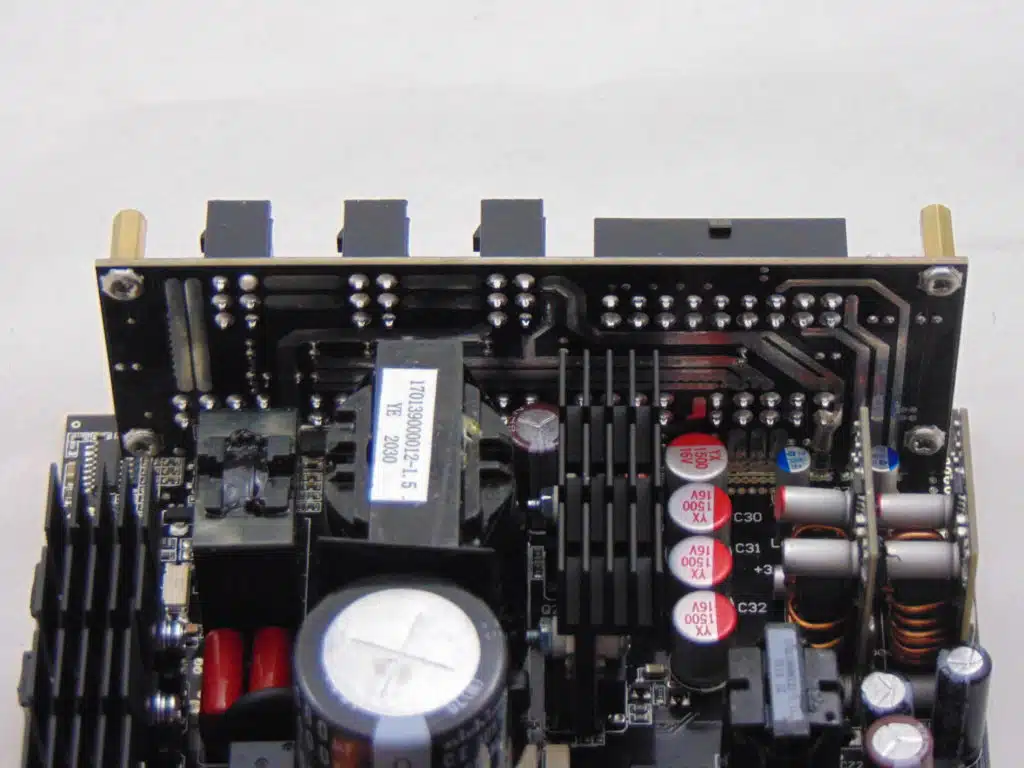

STEAMPUNK 850W Modular PCB Front

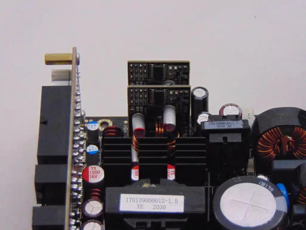

The secondary side of this unit looks a bit crowded, but not insanely so. In the middle of this area, we find the main transformer. Next to this is a heatsink that is attached to the MOSFETs. Surrounding this PCB we find a smattering of various wet electorlytics (Rubycon) and solid electrolytics (APAQ and some unknown brand). Towards the edge of the main PCB, we find the DC-DC VRMs housed on their own PCBs (populated by unidentified solid capacitors just like we see on the main PCB, throw me an email if you know who makes these folks!).

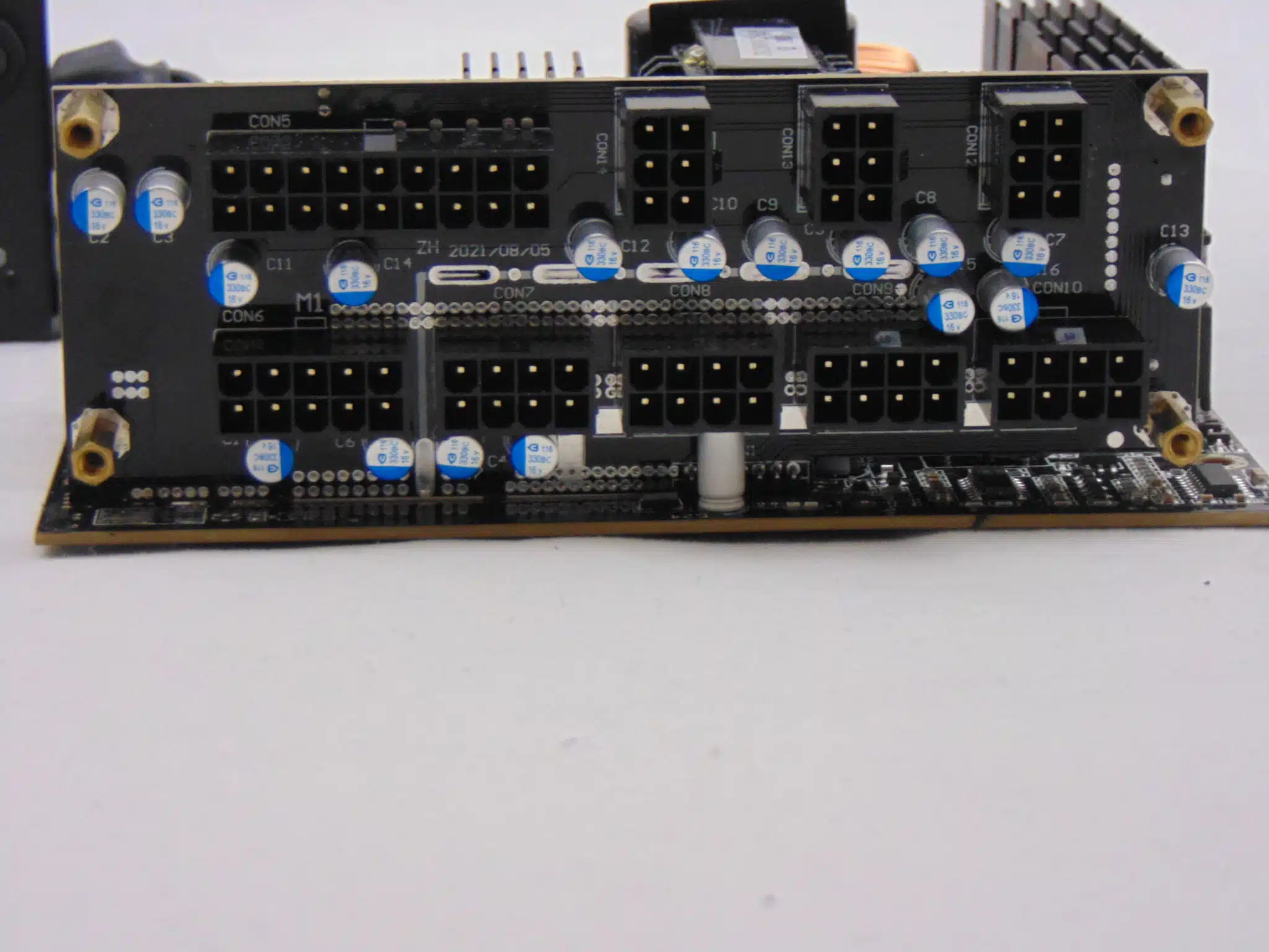

In front of these PCBs, we find the modular PCB. The construction looks very nice here as the soldering is on point. When we look at the front side of the modular PCB we see that the integration is also very good on this side. Throughout the modular PCB, we see more solid capacitors from APAQ.
