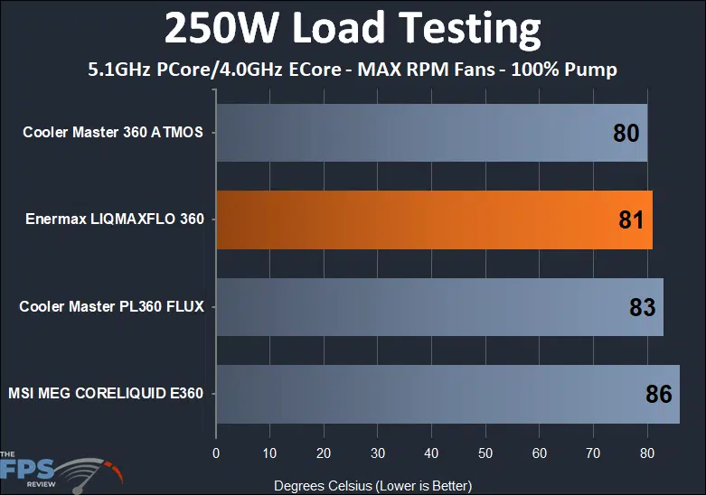

For our 250W TDP clock testing, we have configured our CPU to run at a fixed all-core speed of 5.1GHz on the performance cores and 4.0GHz on the efficiency cores. This yields a fairly steady 250w CPU package power draw when running Cinebench. Stock settings were set for voltage (and all other defaults), and configured memory to XMP mode.
Max Fans – 100% Pump Speed
At the 250W level, we find the Enermax LIQMAXFLO 360 ringing in at 81 degrees Celsius with its fans at full speed. This is just a degree warmer than the 360 ATMOS, but 2 and 5 degrees better than the PL360 FLUX and CORELIQUID E360, respectively.
Note that at this speed, the Enermax LIQMAXFLO 360 is running at 1900RPM, the MSI MAG CORELIQUID E360 at 1800 RPM, the PL360 FLUX at around 2300 RPM, and the Cooler Master MASTERLIQUID 360 ATMOS at around 2500 RPM.

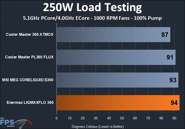

1000 RPM Fans – 100% Pump Speed
At 1000 RPM, the Enermax LIQMAXFLO 360 moves to the back of the bus at 94 degrees Celsius, with each of its competitors outperforming it by 1 to 7 degrees Celsius.
