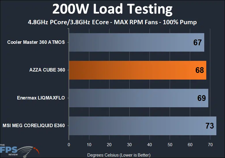

Max Fans – 100% Pump Speed
AZZA Cube 360 200W thermal testing at max RPM fans
Starting our testing with a 200W load found the AZZA Cube 360 delivered a 68-degree Celsius result, which was right in between the Cooler Master 360 ATMOS at 67 degrees and the Enermax LIQMAXFLO at 69 degrees. The MEG CORELIQUID E360 picked up the rear at 73 degrees.
Note that at this speed, the AZZA Cube 360 was running at 1850RPM, the Enermax LIQMAXFLO 360 is running at 1900RPM, the MSI MAG CORELIQUID E360 at 1800 RPM, and the Cooler Master MASTERLIQUID 360 ATMOS at around 2500 RPM.

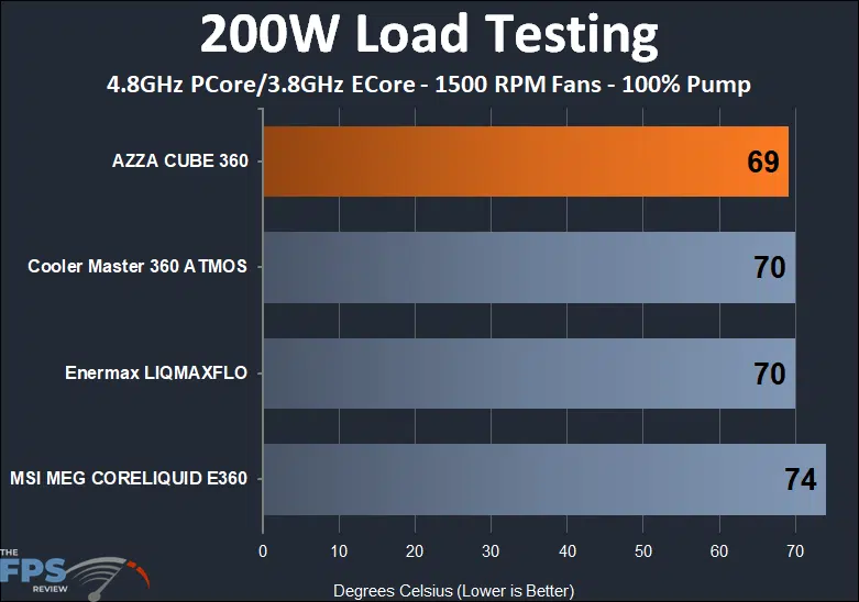

1500 RPM Fans – 100% Pump Speed
AZZA Cube 360 200W thermal testing at 1500RPM fans
Syncing the fan speeds up at 1500 RPM allows the AZZA Cube 360j to take the lead at 69 degrees Celsius. At a single degree hotter, we find the 360 ATMOS and LIQMAXFLO with the MEG CORELIQUID 360 bring up the rear at 74 degrees.

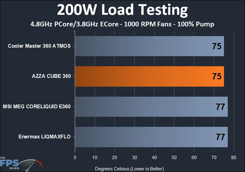

1000 RPM Fans – 100% Pump Speed
AZZA Cube 360 200W thermal testing at 1000RPM fans
Dropping the fan speeds down to 1000RPM I found the AZZA Cube 360 tied with the 360 ATMOS at 75 degrees Celsius. The MEG CORELIQUID and LIQMAX flow came in both second and last place with a 77-degree tie.

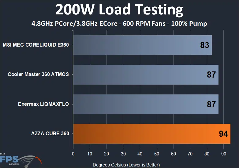

600 RPM Fans – 100% Pump Speed
AZZA Cube 360 200W thermal testing at 600 RPM fans
Finally, at 600RPM, the AZZA Cube 360 drops into last place at 94 degrees Celsius. The MEG CORELIQUID reverses its losses from the higher RPM tests and shines at 83 degrees Celsius with the 360 ATMOS and LIQMAXFLO tying in the middle at 87 degrees Celsius.
