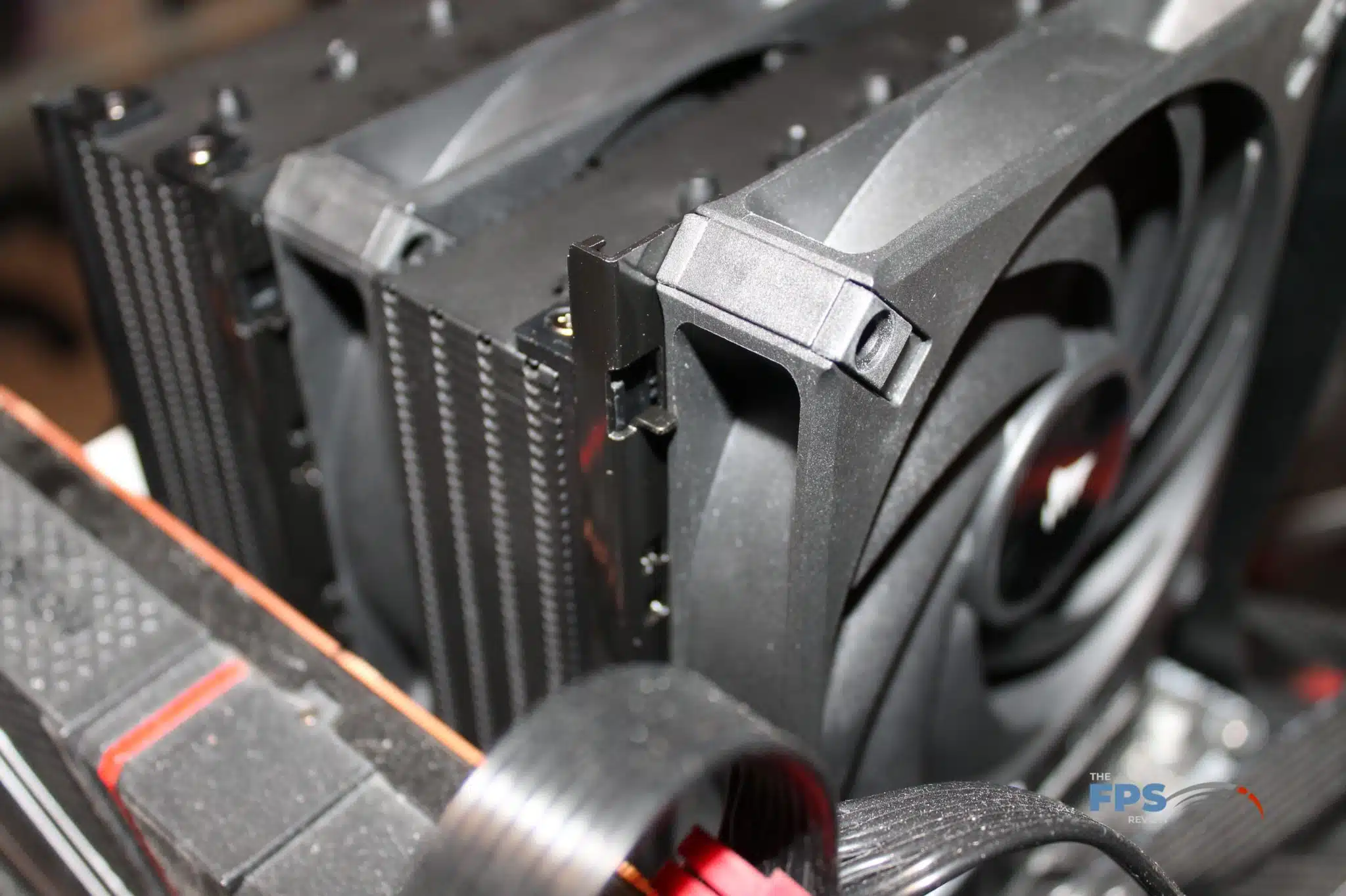

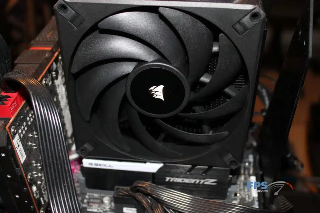

Installation was a relatively straightforward event – add the cross bars and drop the cooler on it and tighten the screws on the top assuming you can find a screw driver in your toolbox with sufficient reach.

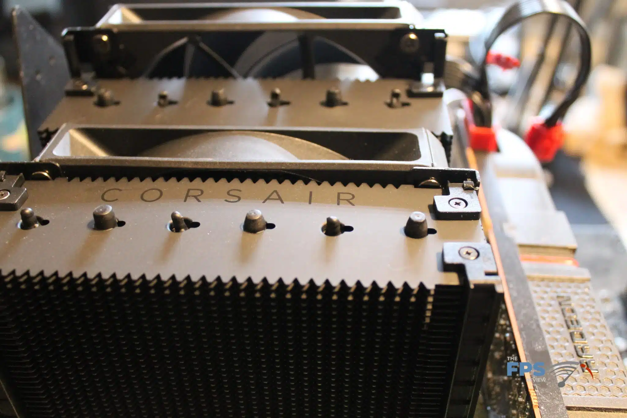

The fan installation was interesting as the rails had to be installed on the fans and then they could be slid down into the tower assembly. This allowed us to bump the height of the fan a few millimeters if it happened to get in the way of the memory below it.
Of note, CORSAIR does not include printed instructions within the box but provides an online installation guide that runs you through each of the steps. I’m a bit old school in that printed manuals are quite helpful for main system components like coolers and motherboards.
The other part of the packaging that was less than ideal was the use of paper pouches for the various parts for installation. It makes the part organization a one way street which is challenging in the review world when I need to put it back in the box with all the parts in a way I won’t lose them.
