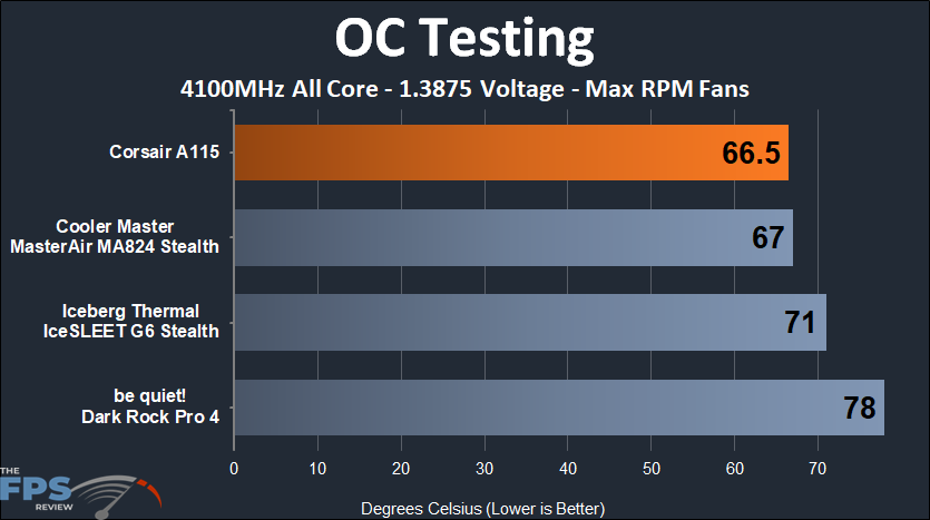

Max Fans
CORSAIR A115 overclocking temperature testing at max rpm
Running our HSFs at full tilt leads to the CORSAIR A115 posting a temperature of 66.5 degrees Celsius which is just ahead of the MasterAir 824 at 67 degrees Celsius. In third place we found the IceSLEET G6 Stealth at 71 degrees and the Dark Rock Pro 4 brought up the rear at 78 degrees Celsius.
We noted that the max fan speed on the CORSAIR A115 topped out at 1600 RPM, the MasterAir 824 topped out at 1900/1550 RPM, the IceSLEET G6 Stealth topped out at 1450 RPM and the Dark Rock Pro 4 at 1300/1500 RPM.

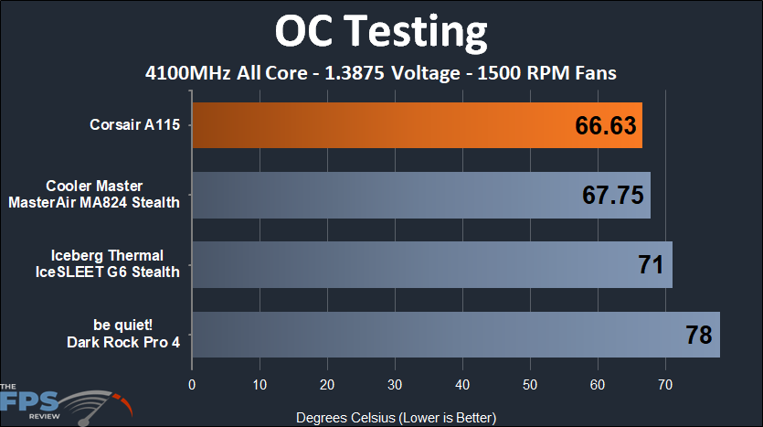

1500 RPM Fans
CORSAIR A115 overclocking temperature testing at 1500 rpm
At the 1500 RPM fan speed, the CORSAIR A115 maintained its lead by about a single degree Celsius at 66.63 degrees compared to the MasterAir MA824’s 67.75 degree result. The IceSLEET G6 Stealth slipped back a bit to 71 degrees Celsius and the Dark Rock Pro 4’s temperature remained the same as it was still running at maximum fan speeds.
