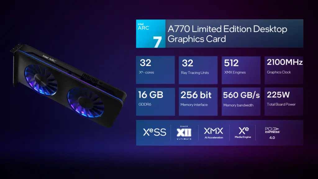

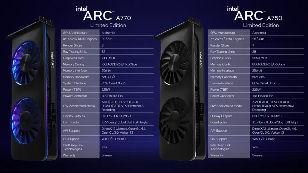

We have a breakdown of the architecture and all deep dive architecture press slides posted on page 2. The Intel Arc A770 (A7 or Arc 7) is based on Intel’s DG2-512 GPU and ACM-G10 variant. It is built on a TSMC N6 node and contains 21.7 Billion transistors with a die size of 406mm2. It has 32 Xe-Cores, 4,096 FP32 Cores, 32 Ray Tracing Units, 512 Matrix Cores, 512 Xe Vector Engines, 256 TMUs, and 128 ROPs. It has a Base Clock of 2100MHz and will boost up to 2400MHz. It has 16GB of GDDR6 VRAM at 17.5GHz on a 256-bit memory bus providing 560GB/s of memory bandwidth. The TDP is 225W.

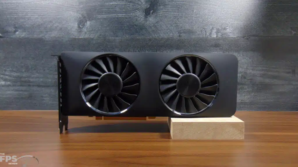

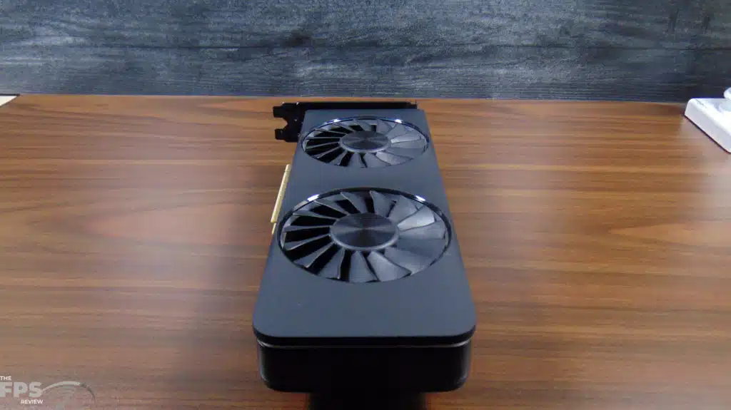

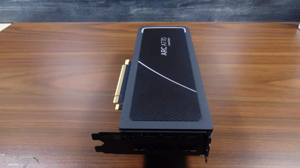

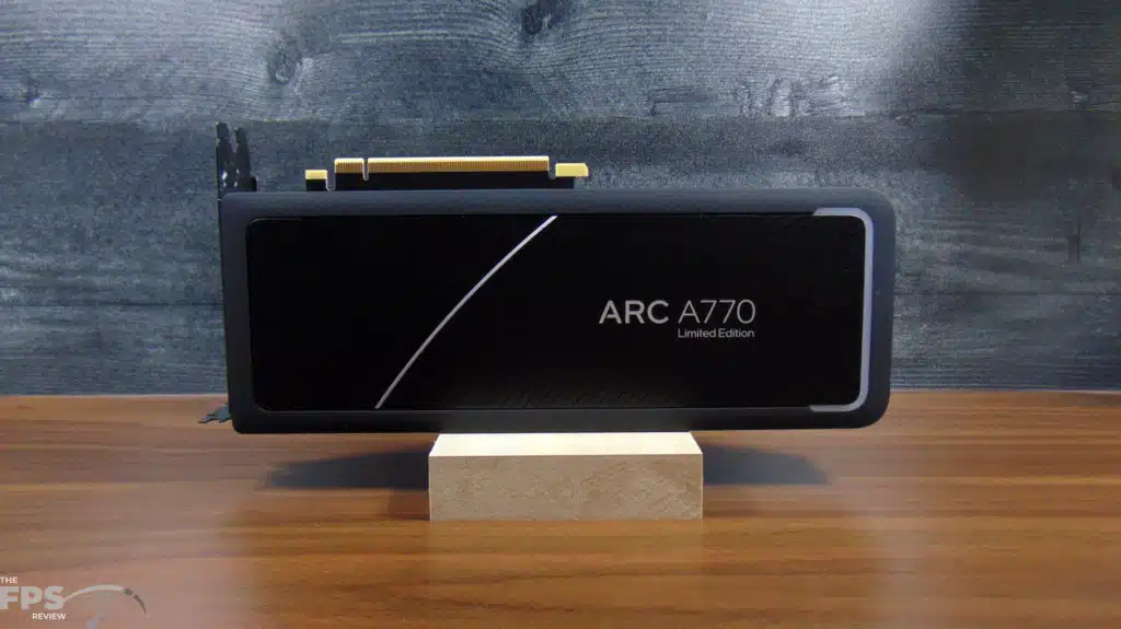

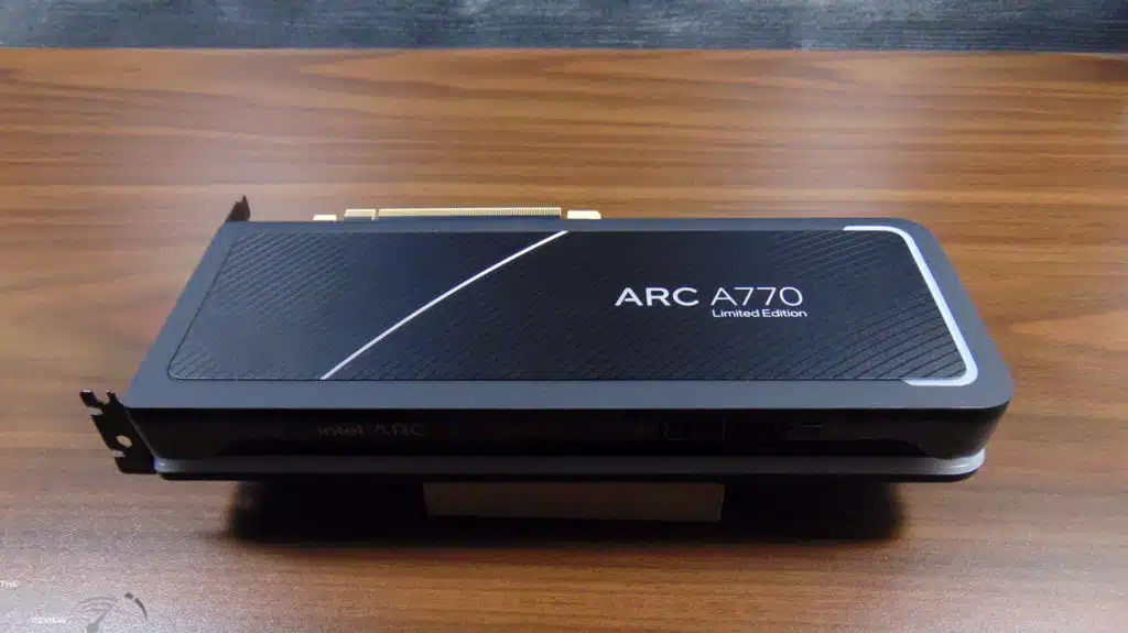

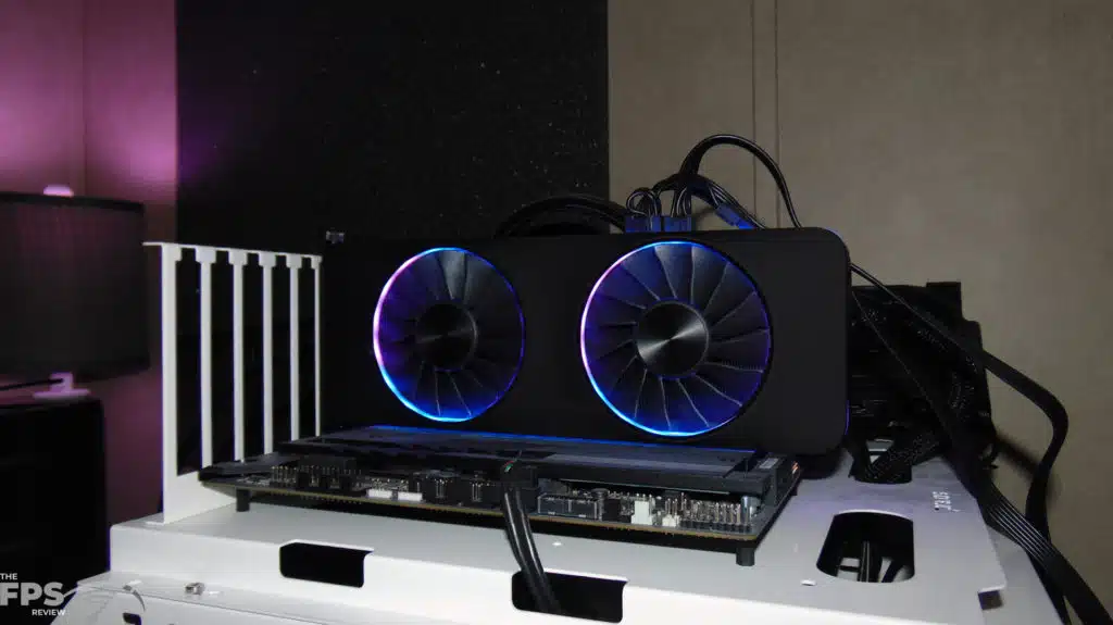

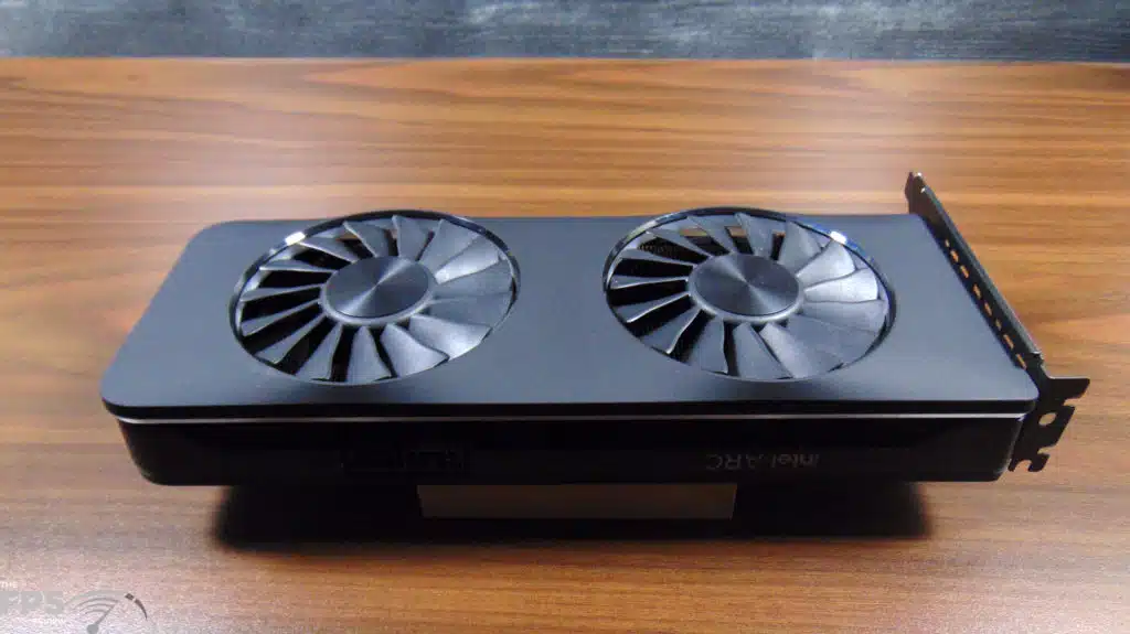

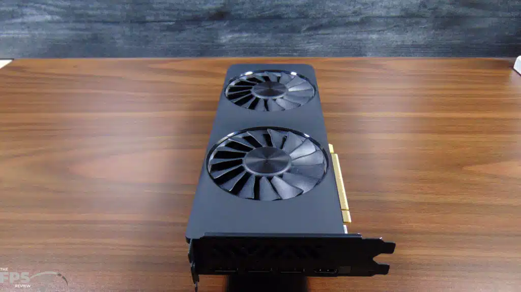

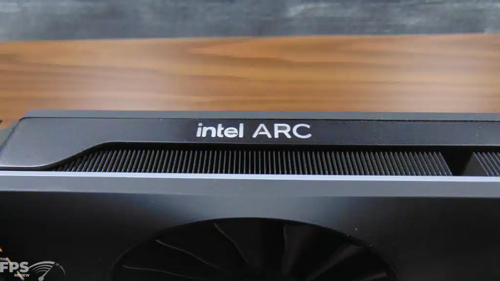

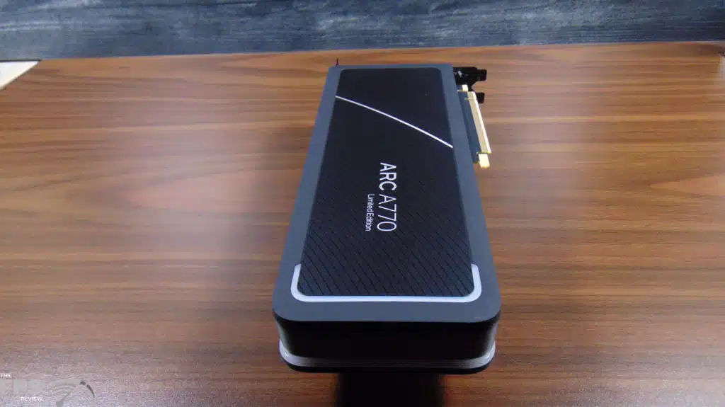

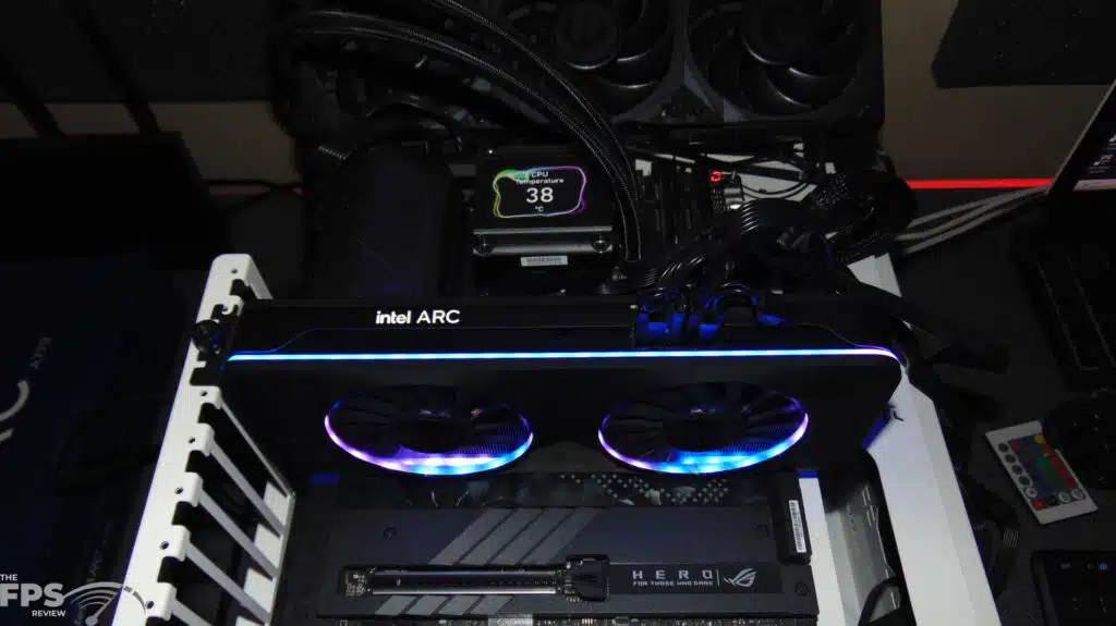

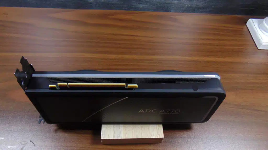

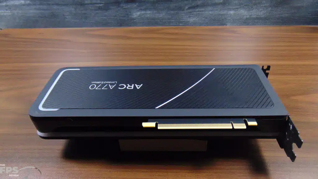

We are specifically reviewing the Limited Edition Intel Arc A770 video card today, so this design is unique from Intel. There really is a lot to like here, the design is pleasing to touch and pleasing to see, and the package size is one you can handle. The video card measures 10.57″ inches in length, 3.87″ inches in width, and only 1.6″ inches in height. This is a very thin video card and will fit in a lot of small builds.

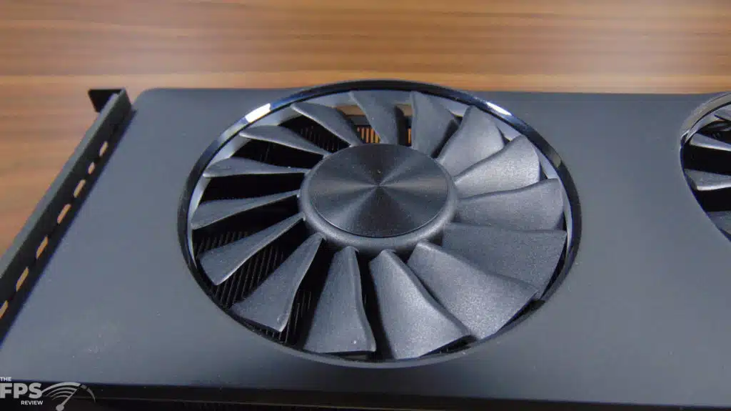

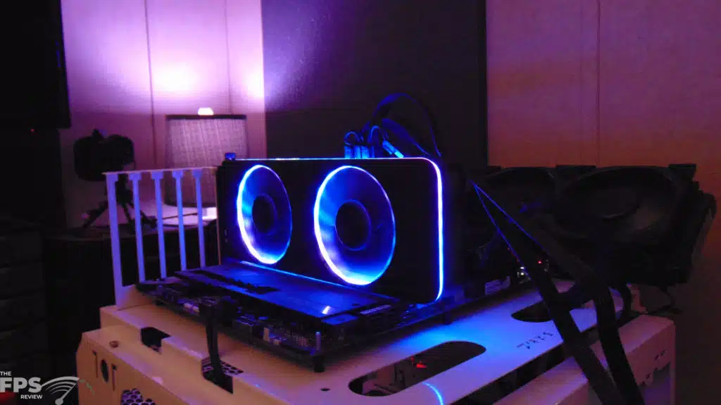

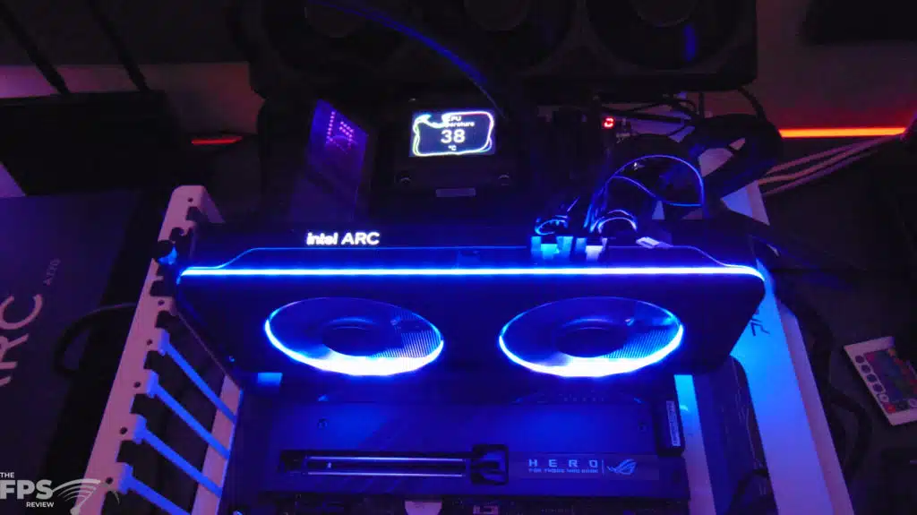

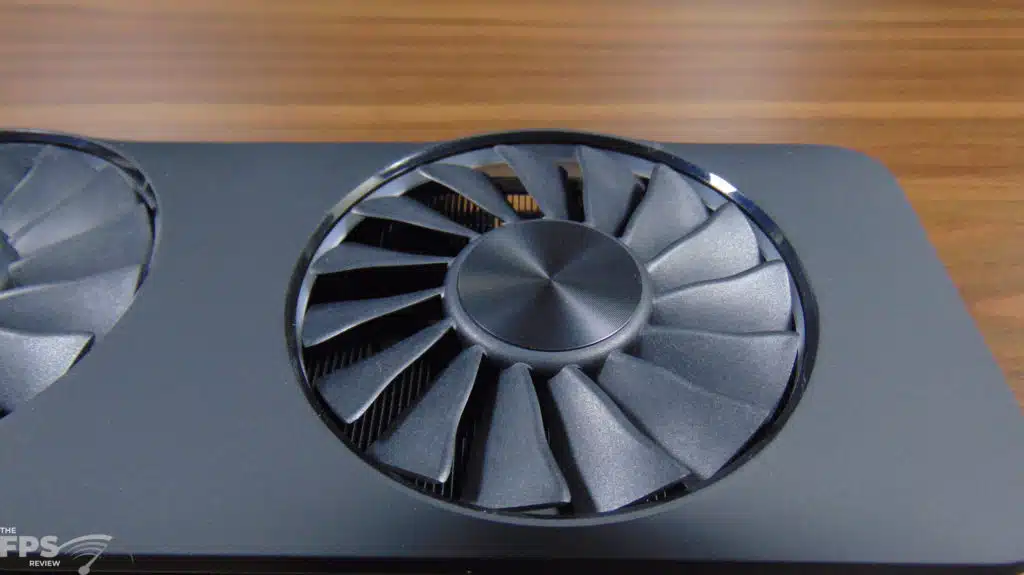

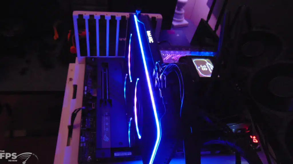

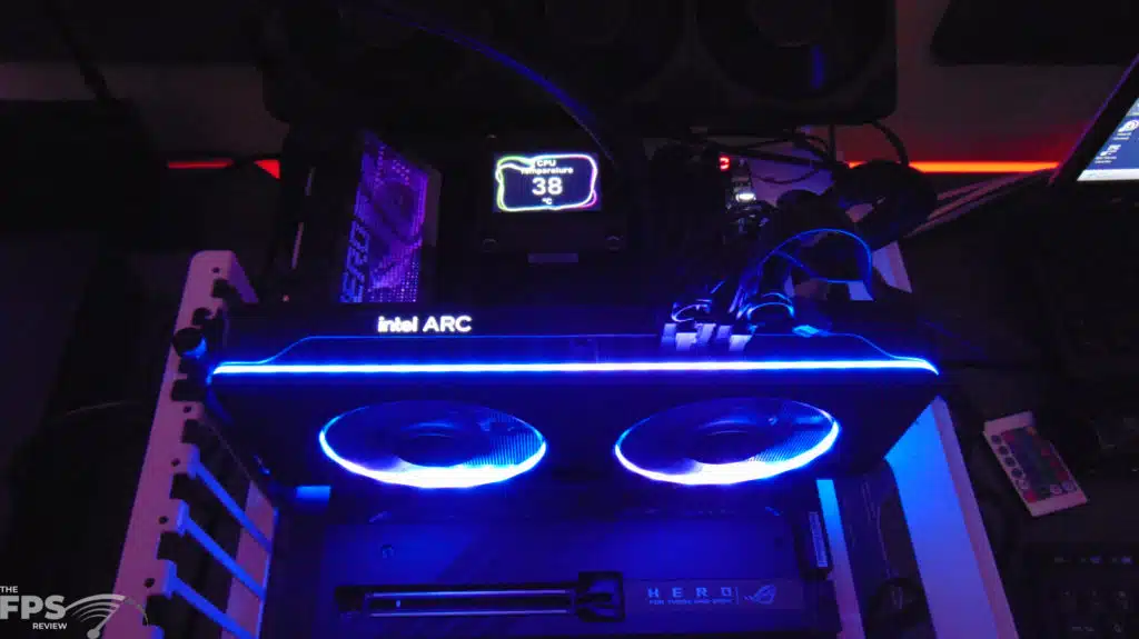

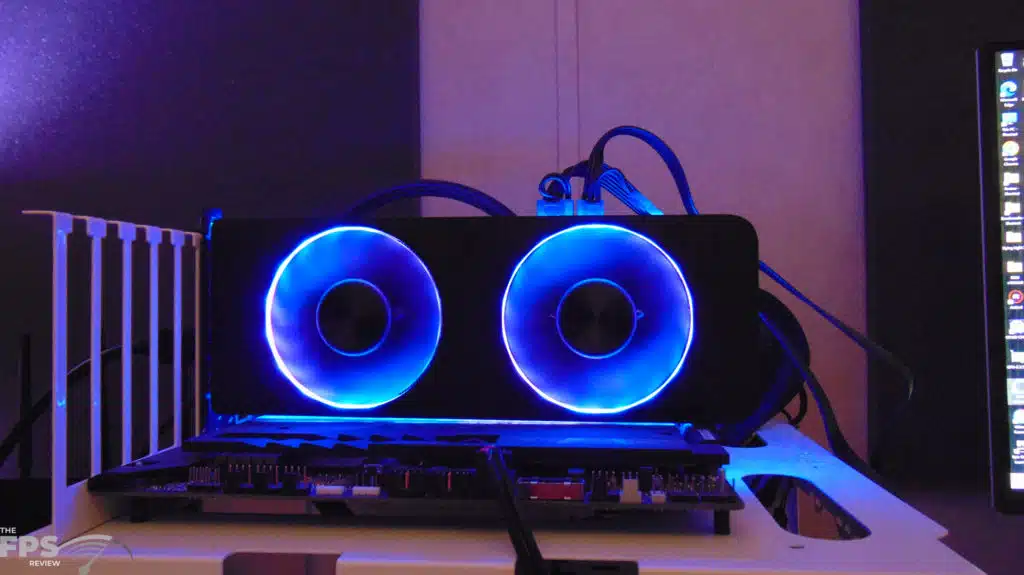

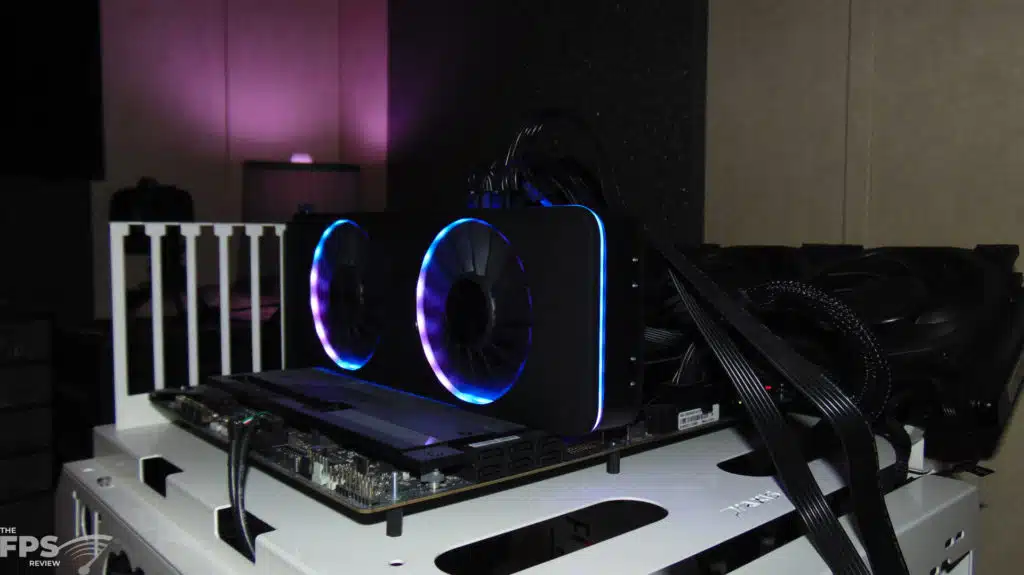

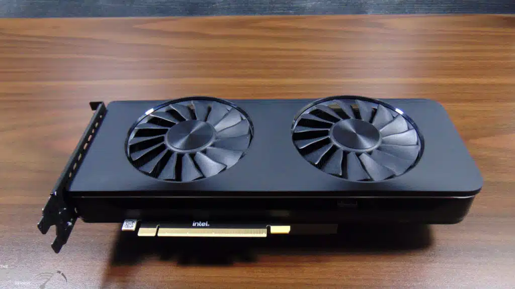

Intel’s design solution is based on a two-fan 15-blade axial design with a screwless shroud that does not constrain the venting of heat from the top or bottom. The video card has a die-cast aluminum frame with a full backplate with matte accents. The cut-outs for the fans have chamfered edges, for an elegant look. Even the I/O bracket is stealthily colored. Of course, Intel has adorned the Limited Edition with no less than 90 fully controllable diffused RGB LEDs. They accent the outline of the video card and the inside of the fan housing.
The thermal solution is a copper vapor chamber design with flattened 10mmx3mm heat pipes. On top of that are an array of high-density aluminum fins, then the bracket and shroud and fans. The memory and GPU die make direct contact with the vapor chamber for cooling.

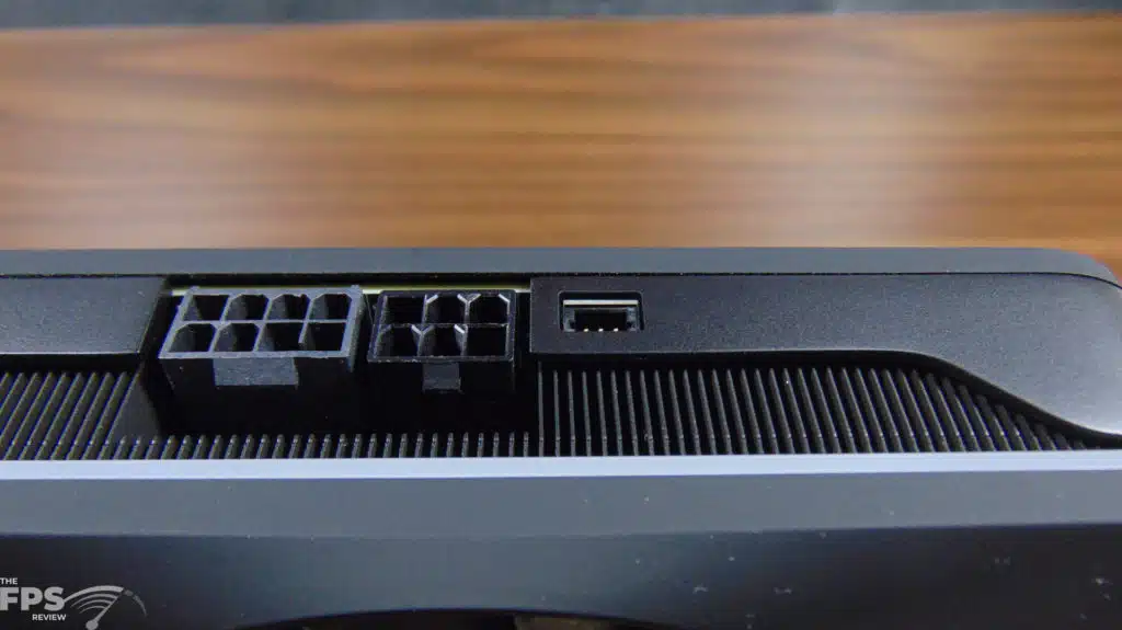

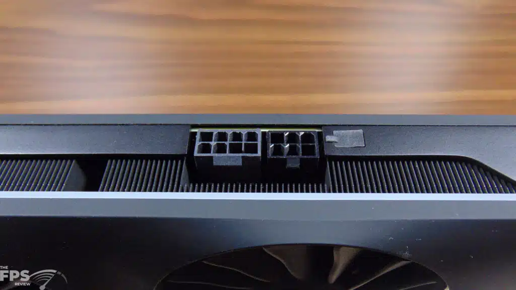

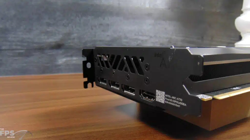

The PCB is not oversized and is based on a 6 VRM phase design, and standard 8-pin and 6-pin PCIe power connectors. It supports PCIe Gen 4.0 x16, and you will find three DisplayPort 2.0 and one HDMI 2.1 port. Intel claims the fans are built for quiet acoustics at about the volume of a soft whisper.
Even the RGB diffusion has special attention paid to it to create an enjoyable RGB experience. You will find the fans, ring, back, and logo lights up and all are customizable in Intel’s software.
