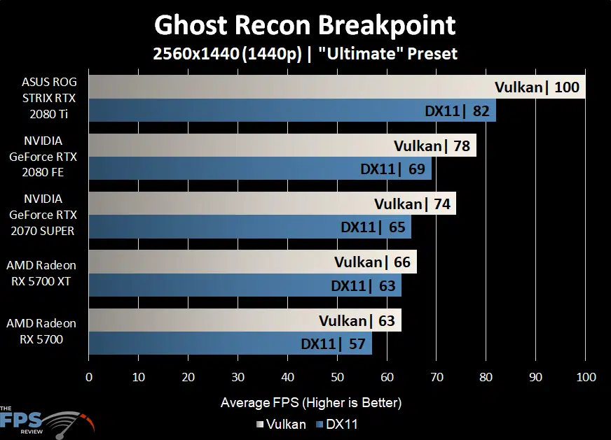

1440p “Ultimate”
Ghost Recon Breakpoint Graph
Here are all the AMD and NVIDIA video cards compared to each other at 1440p with “Ultimate” graphics settings.  Naturally, the GeForce RTX 2080 Ti is going to take the cake here and provides the best gameplay experience.  Let’s look below that.
It seems the GeForce RTX 2080 FE and even the GeForce RTX 2070 SUPER are faster than the Radeon RX 5700 XT in this game.  All three are reference video cards, no factory overclocks, and this is how it lines up.
Interestingly the DX11 performance between the Radeon RX 5700 XT and GeForce RTX 2070 SUPER are very close.  However, once you factor in Vulkan the GeForce RTX 2070 SUPER boosts well over the Radeon RX 5700 XT under Vulkan and gives us more performance.  Though the Radeon RX 5700 is the slowest, it is still playable as long as you run in Vulkan.
