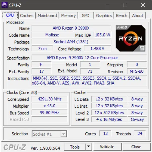

However, you can run a 3900X or even a 3950X on ths board. I will say that this motherboard did seem to do much worse on automatic overclocking. That is, PB2+AutoOC or PBO+AutoOC did less than usual here. We generally go right for the manual overclocking as it stresses the system harder. That said, boost clocks sometimes seemed a bit lower here and it showed in some of the benchmark tests.
Given the motherboard was the variable here, I have to conclude that it was the GIGABYTE X570 Gaming X that held the CPU back, but only by the tiniest margin. For all I know, this was due to the firmware more than by design. In any case, the performance was close enough to the other test systems that I doubt most people would give it much thought.
Even if that is the case, we know the VRM is capable as it can handle a full 4.3GHz overclock on a 3900X. Therefore, the rest comes down to potential firmware issues or manual tuning to get more out of this board. I think it can certainly be done as the board is good enough to do it.
