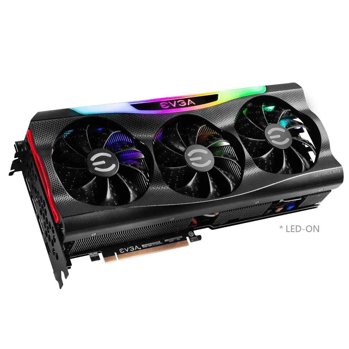

What we can see from the get-go is that EVGA was not shy in the design of this video card.  It is a complex, very busy, design.  EVGA took a lot of creative liberties with this video cards design, this isn’t your standard cardboard rectangle box, indeed EVGA stepped out of the box on this one.  The video card is completely custom, from PCB to cooling, to RGB.

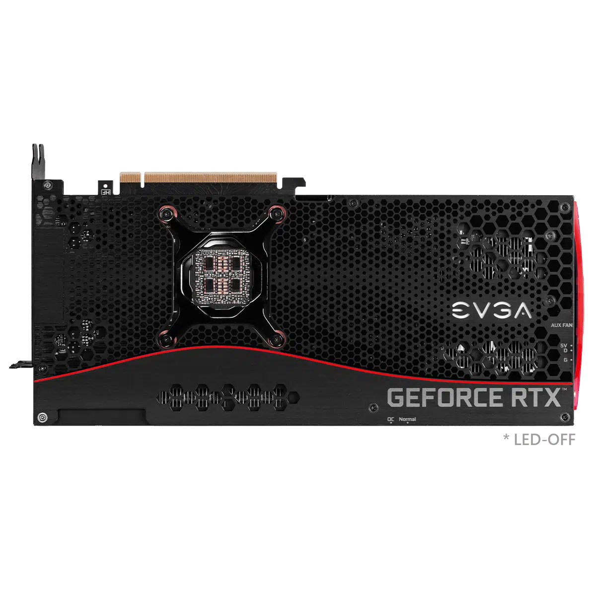

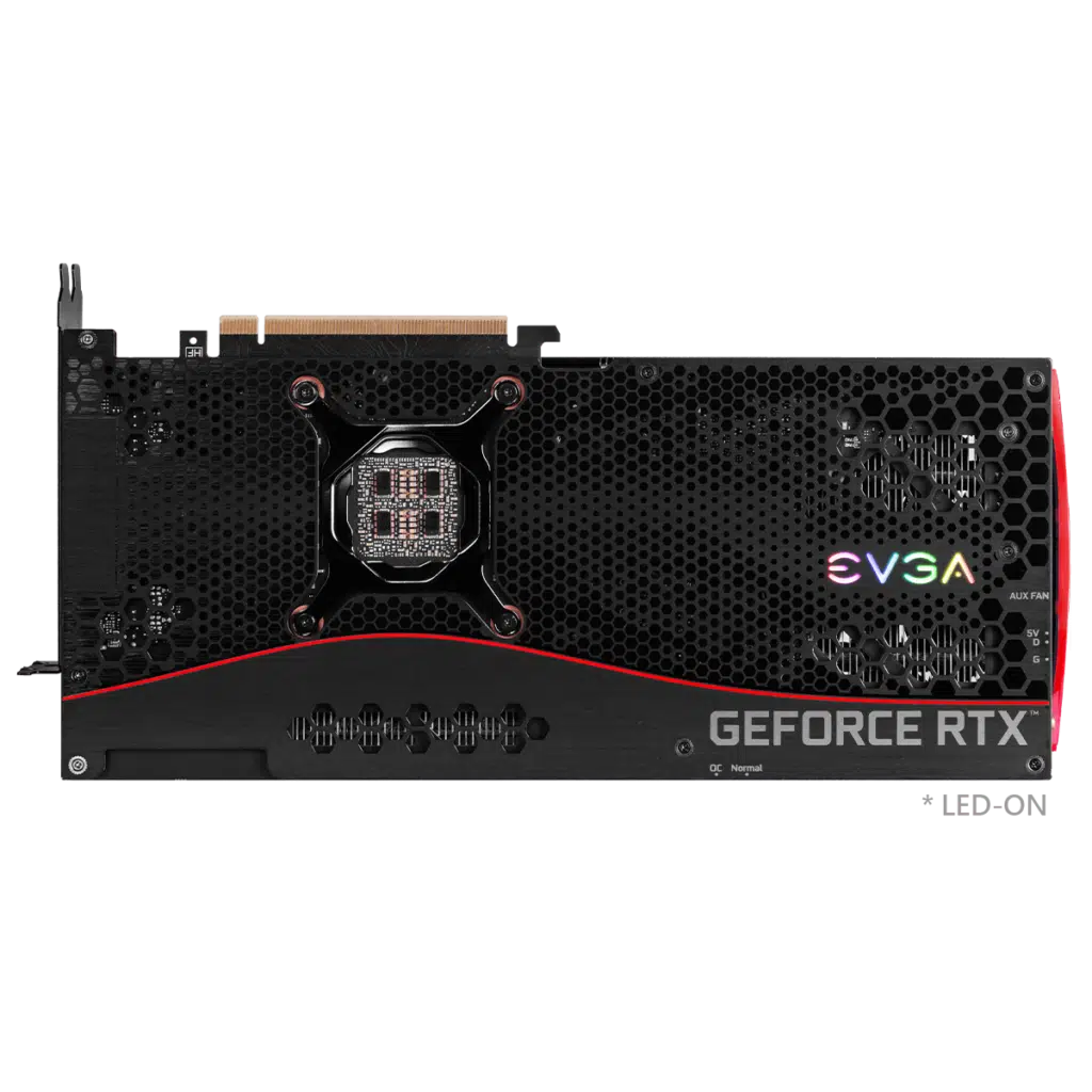

Even the full metal backplate is part of the iCX3 Technology with smart cut-outs in the PCB and backplate that improve airflow and reduce exhaust recovery.  That’s right, the PCB has actual cut-outs that allow air-flow to flow through it and through the backplate, in a fashion that is similar in nature to NVIDIA’s Founders Edition cooling design.

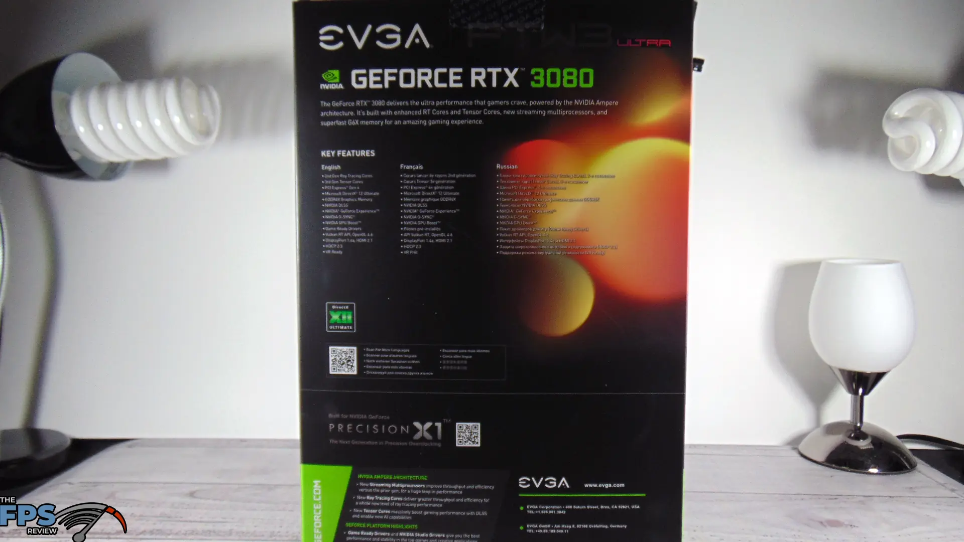

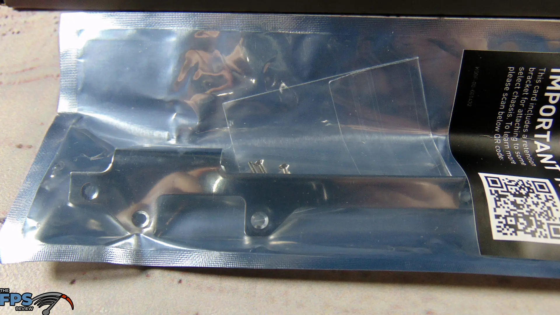

The video card comes in a tall box, with the part number on the back. Once you open it up inside it is packaged well, and includes a badge and a sag bracket.

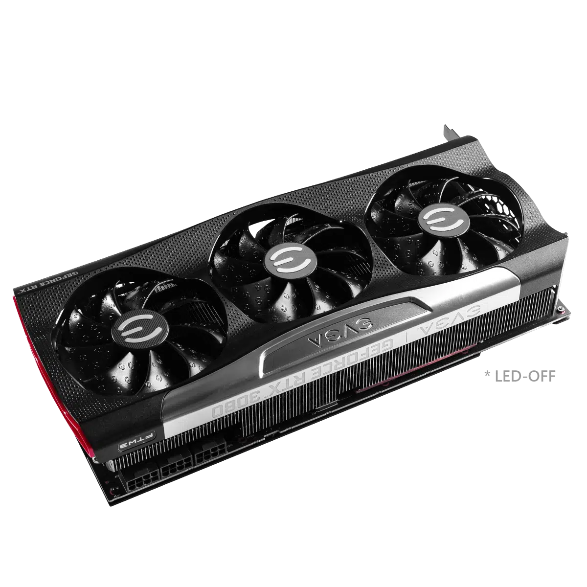

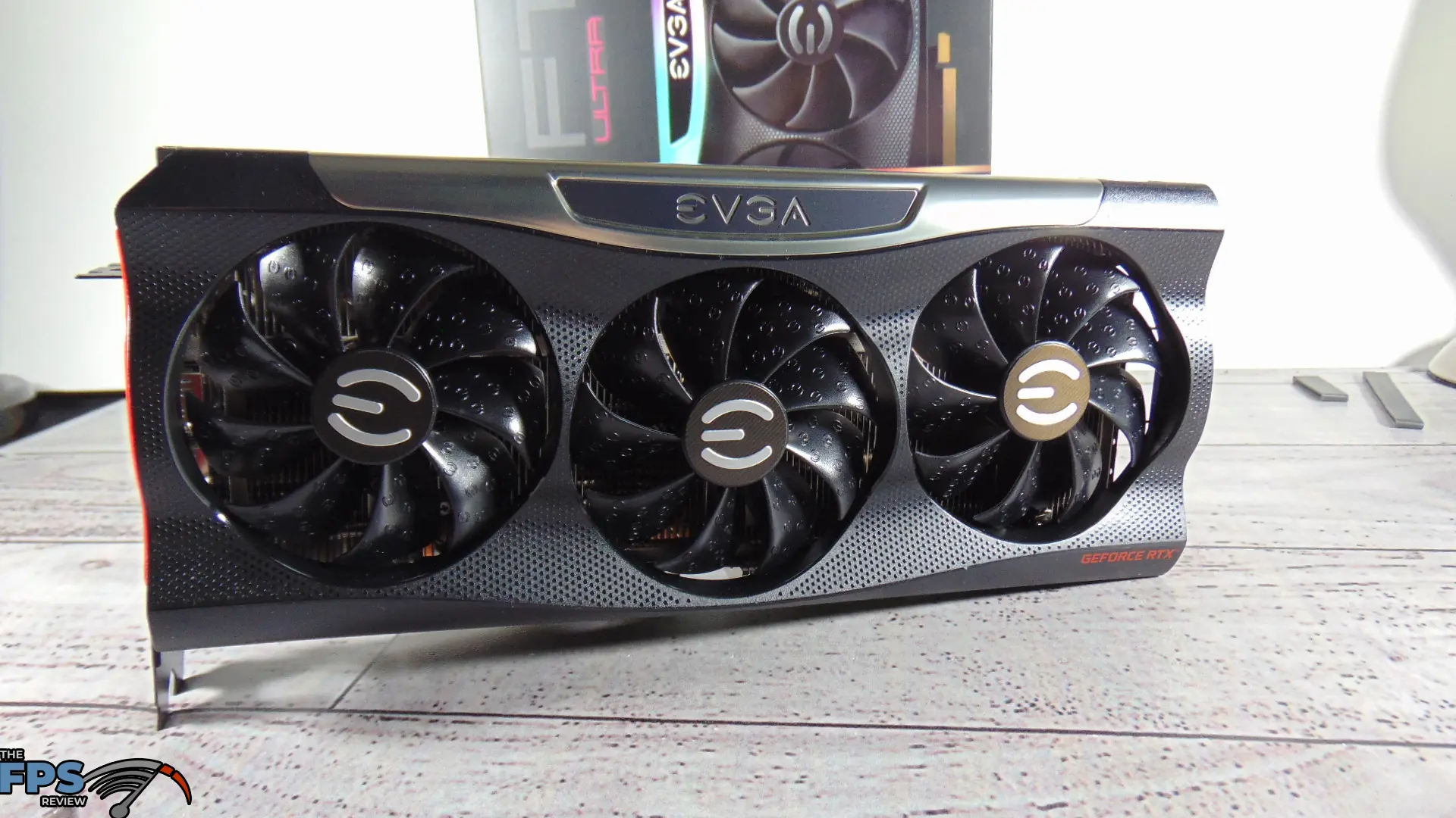

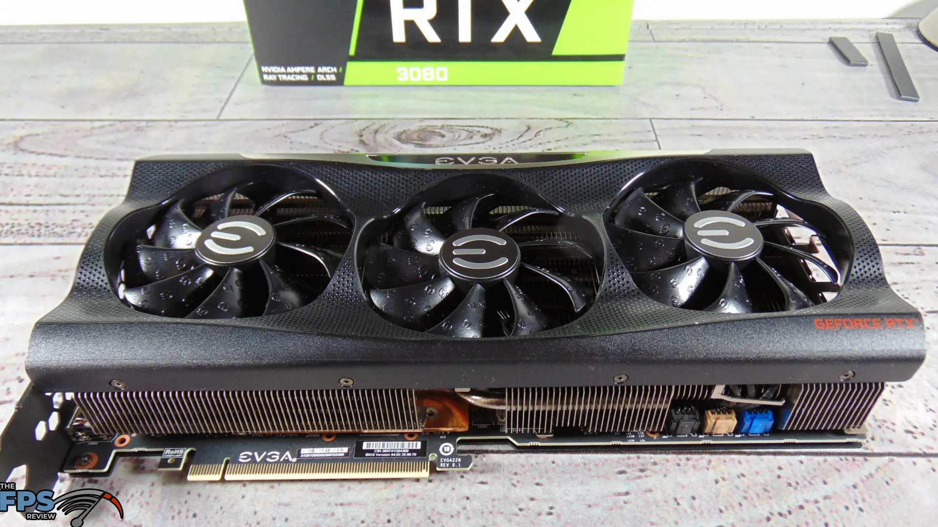

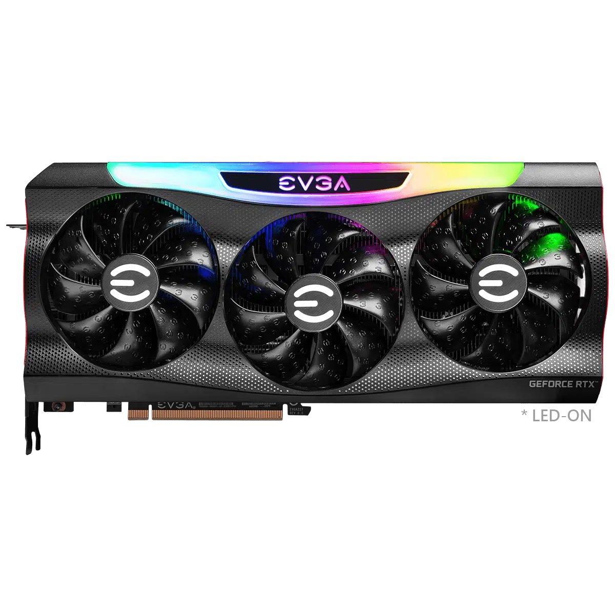

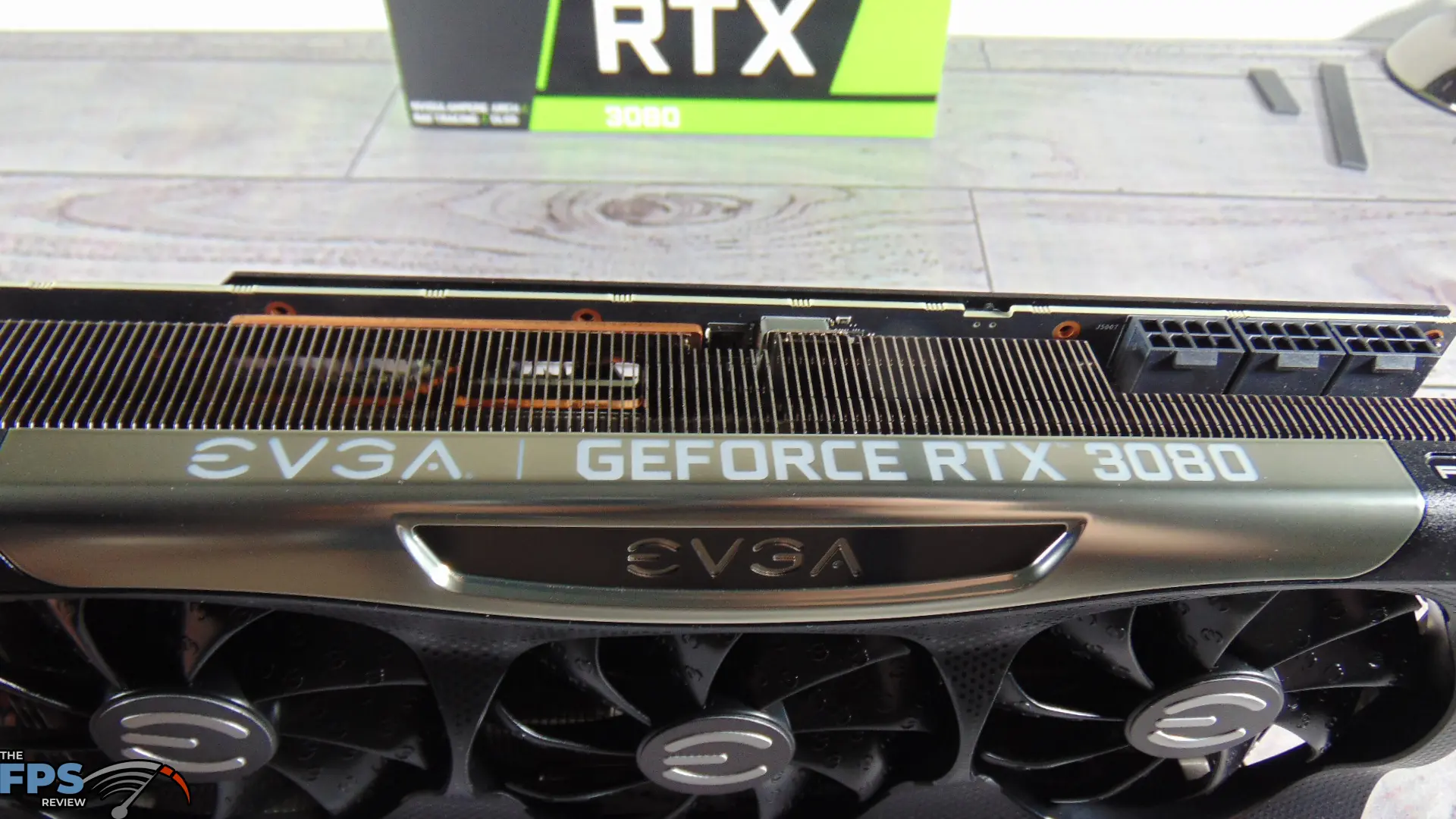

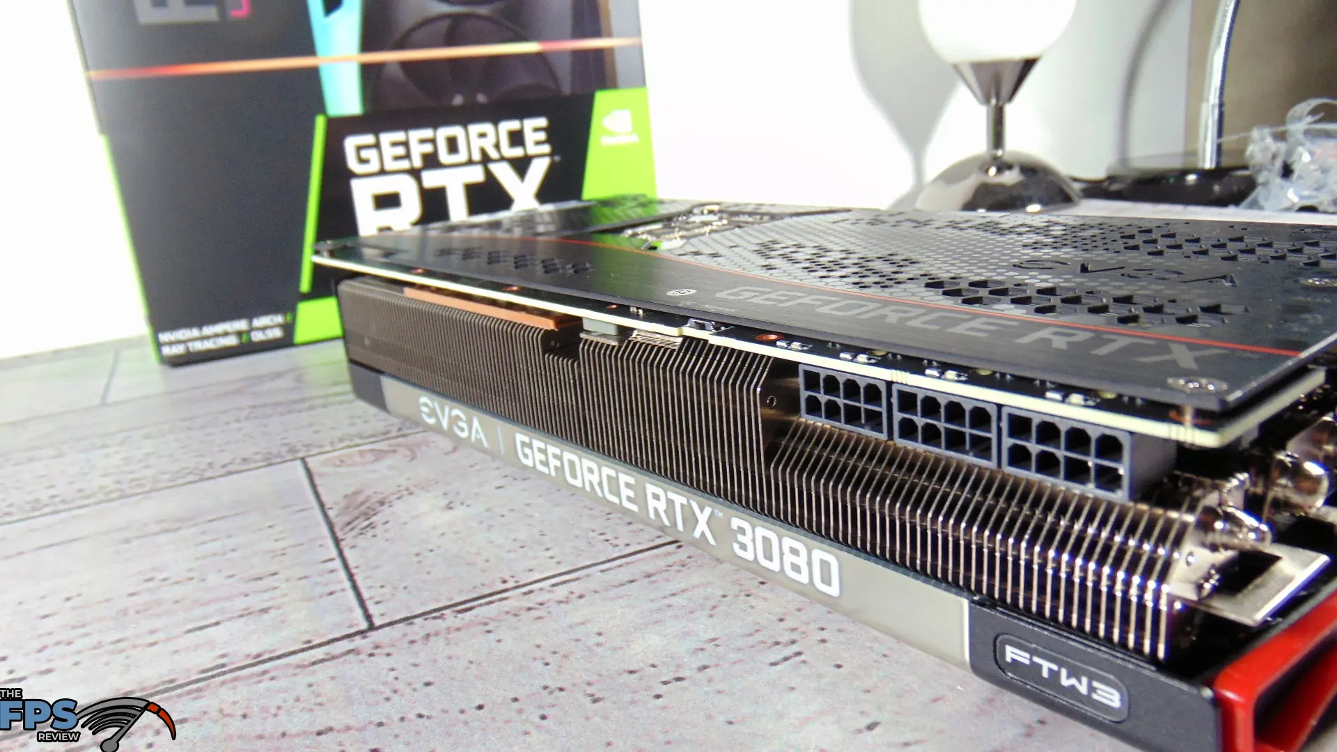

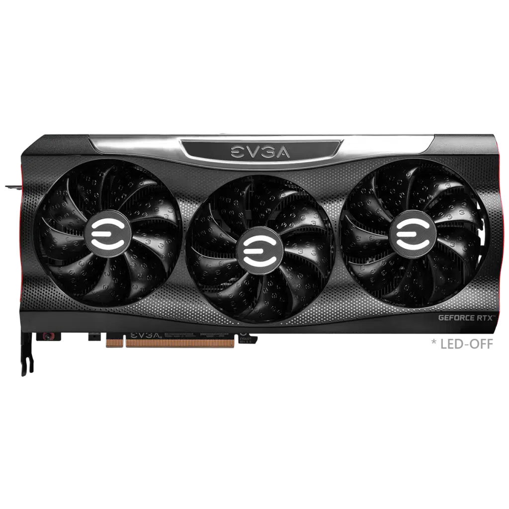

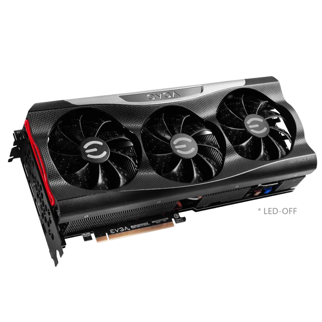

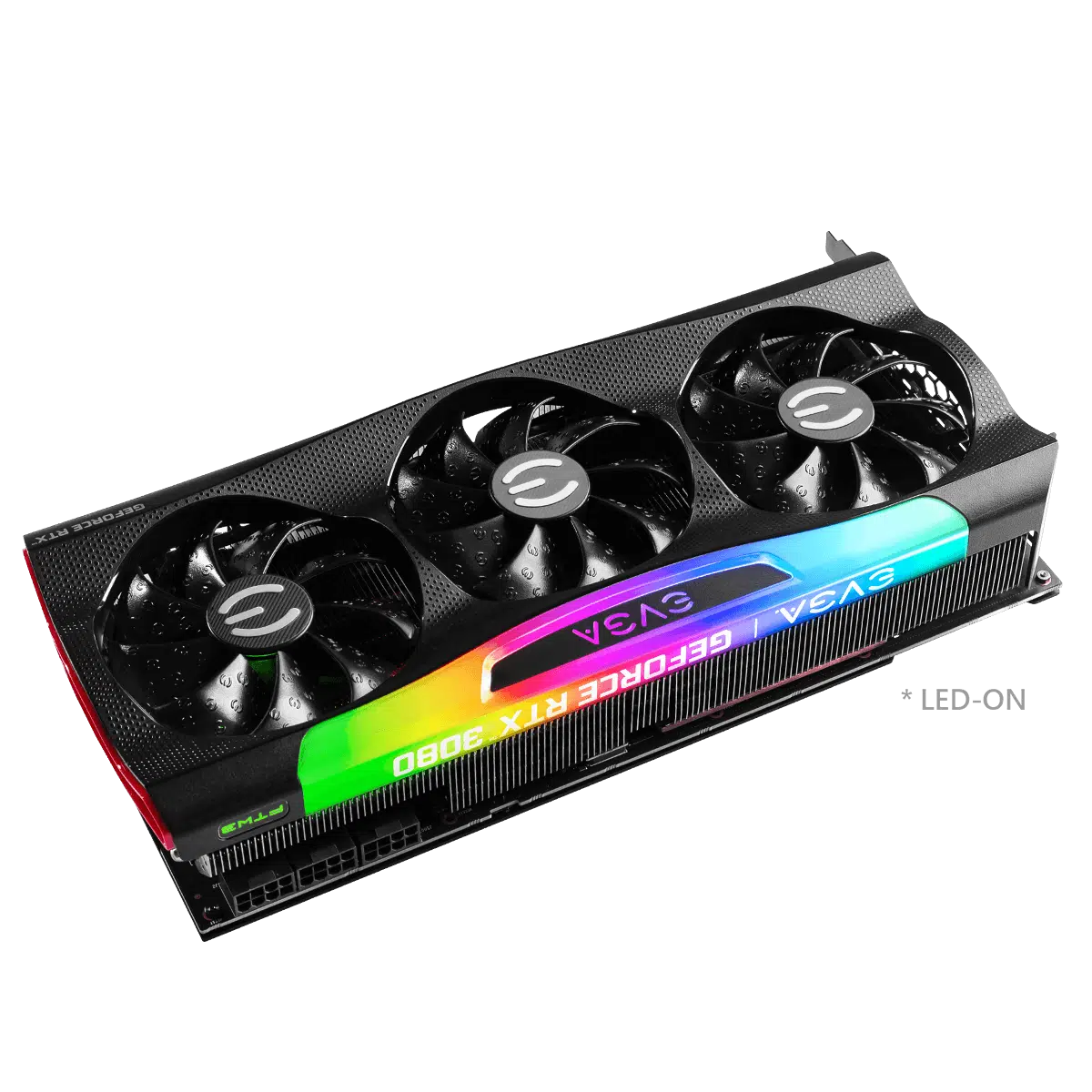

Right off the bat, you can see the unique design, it has a very “wavy” fan shroud with three large fans, the shroud is textured and the fans also. The shroud extends just past the PCB, but the PCB is full-length, unlike the Founders Edition. The power delivery is customized, and 3 8-pin PCI-Express power connectors are required.

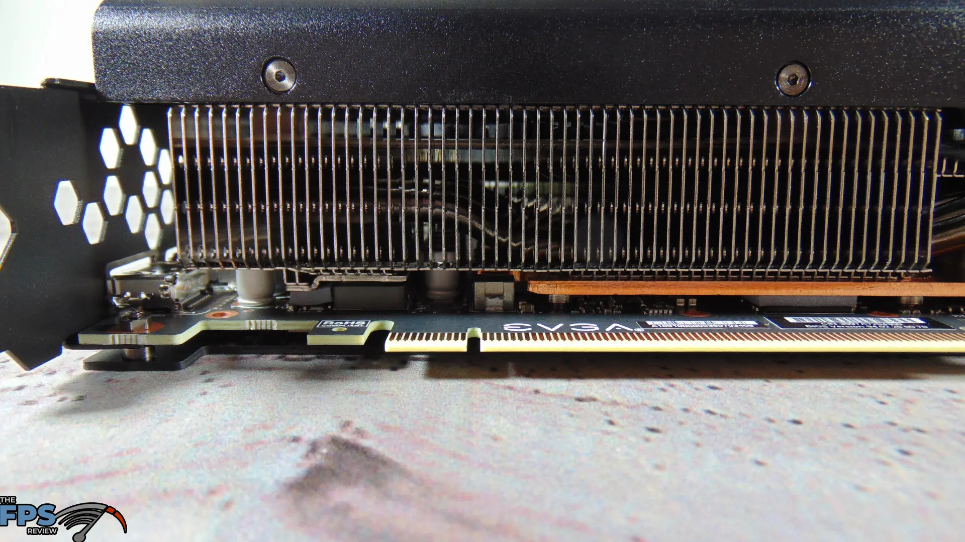

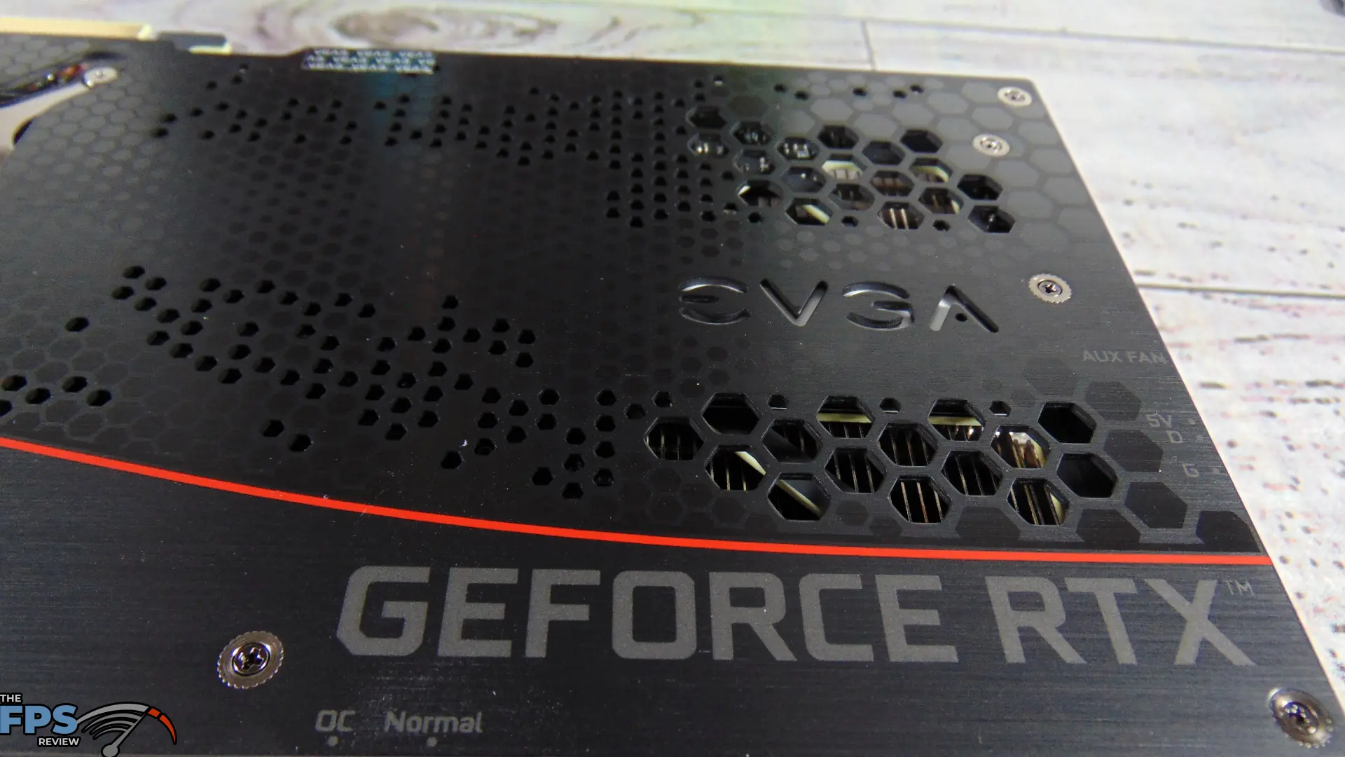

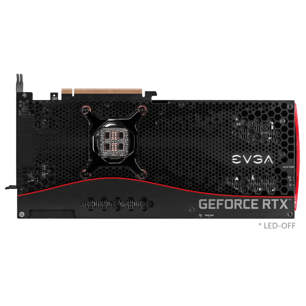

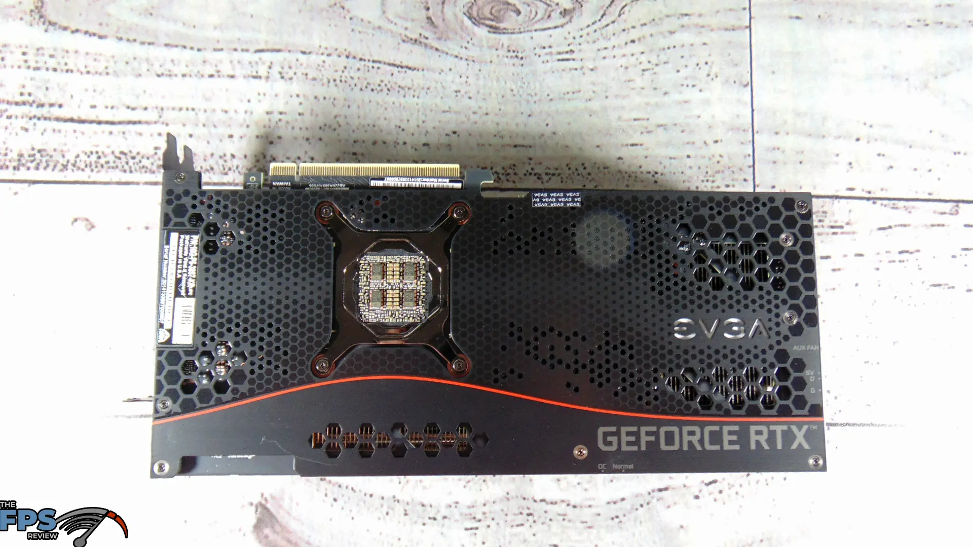

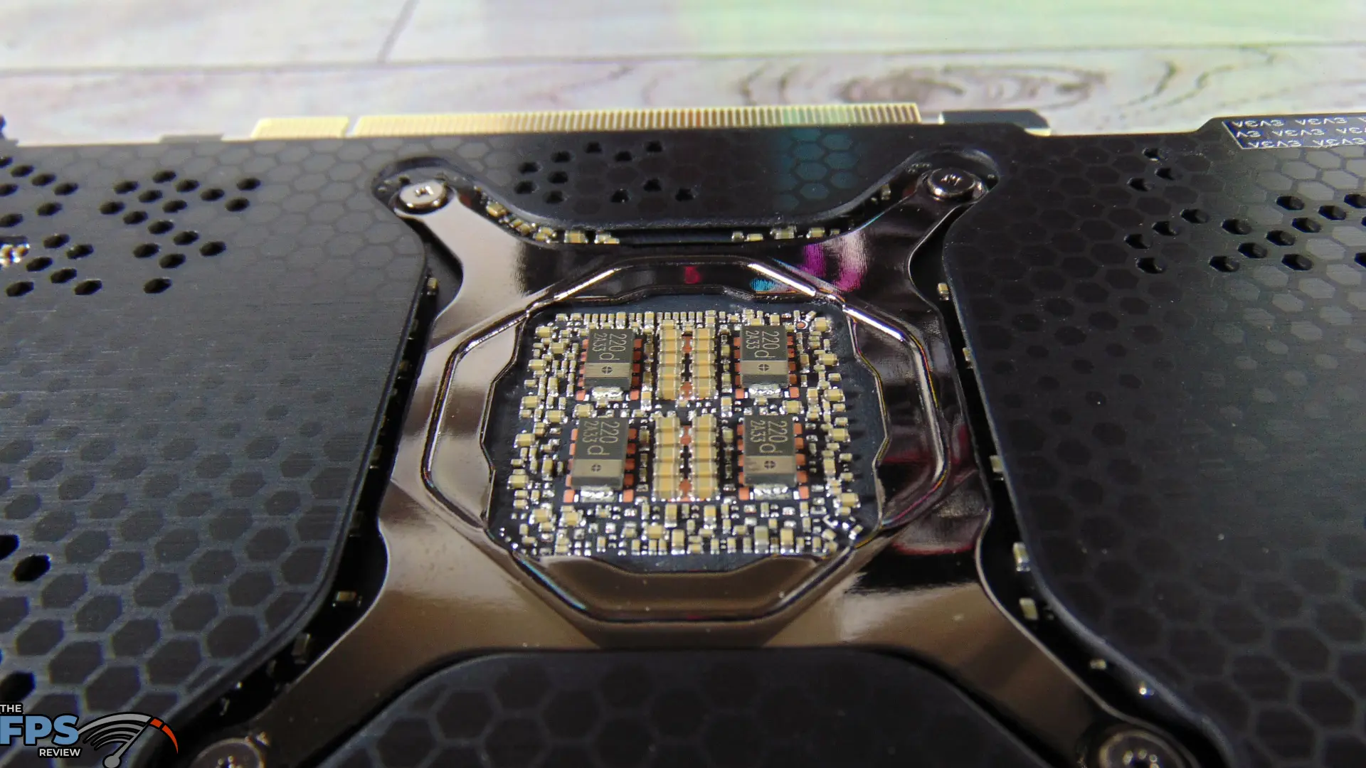

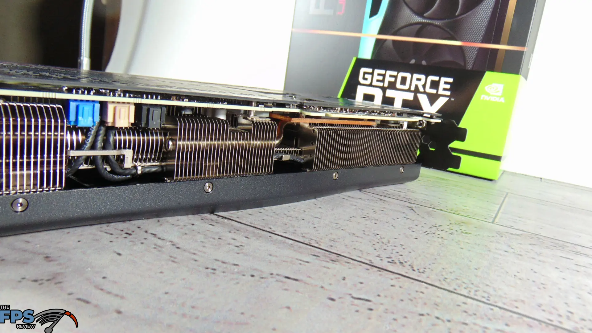

What is a bit hard to see here is that the PCB does have cut-outs that allow air to pass through the PCB and backplate. We notice ample thermal pads on the VRMs, VRAM, and a large copper heat plate on the GPU. The backplate also has thermal pads for passive cooling, it does not act as a heat damper, it is well vented. You can see on the back of the GPU this video card uses four SP-CAP capacitors and 20 MLCC capacitors.

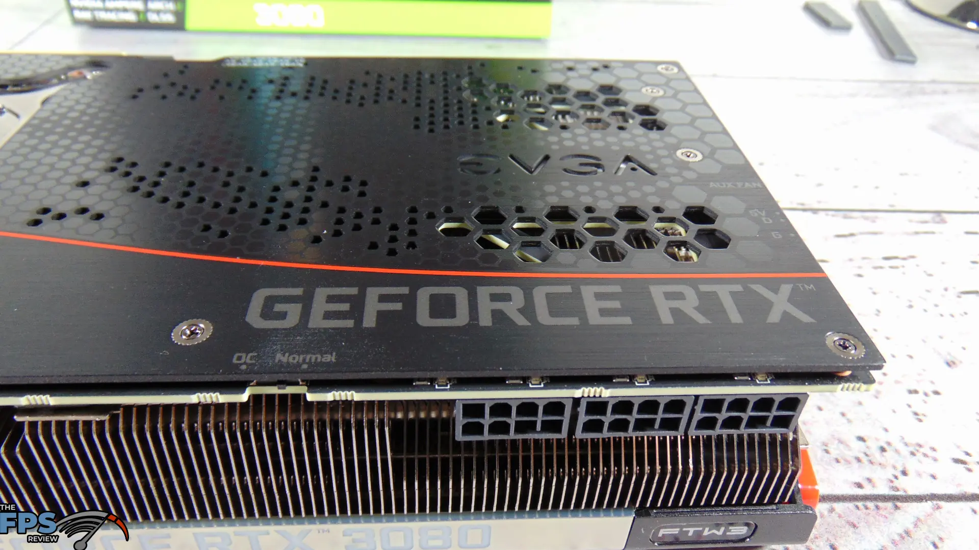

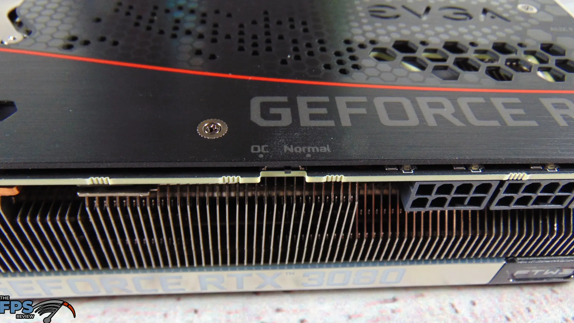

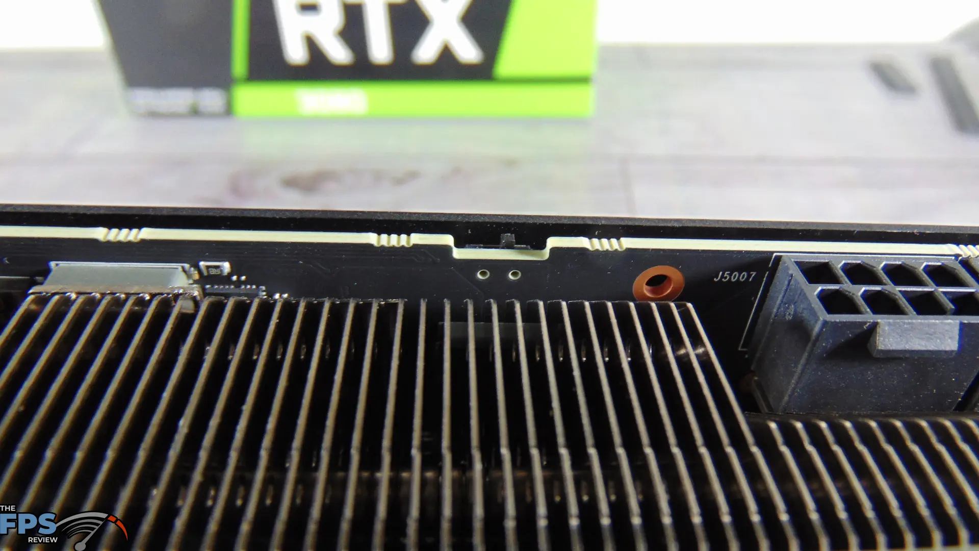

There is a BIOS switch on the video card to switch from Normal to OC mode. Normal is the default shipping mode. Both BIOS’s run at the same clock speeds, voltages, and power targets, however. The only difference is that the fan profile is more aggressive on the “OC” mode and the fans won’t shut off. However, with this BIOS switch being there, EVGA can release custom BIOS’s to use that you can flash in the “OC” mode and not affect the normal BIOS. It’s a good backup.

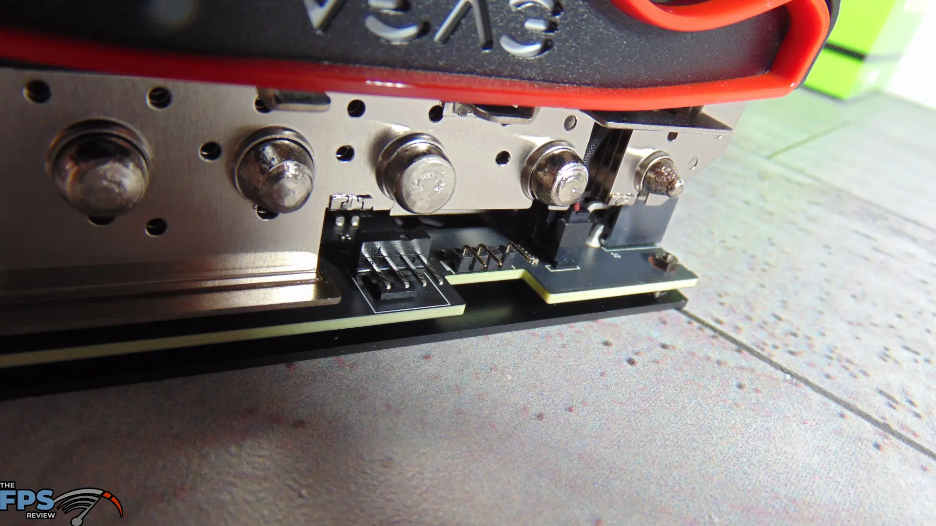

Uniquely this video card supports an RGB header on it. This lets you plugin other RGB things into your video card to sync it with the cards RGB. There is also an Aux Fan connector to allow a fan to be synced and controlled by the GPU.

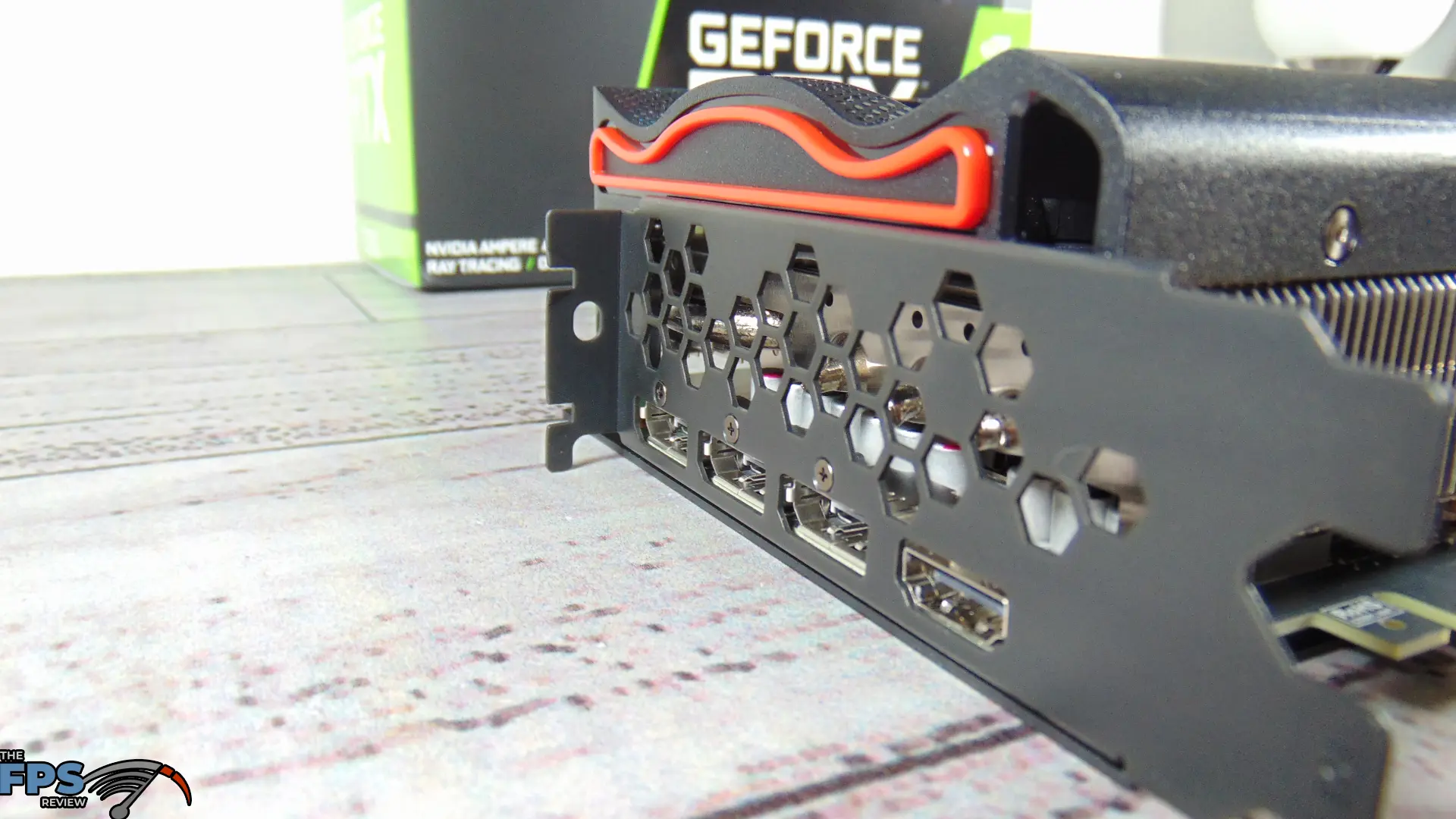

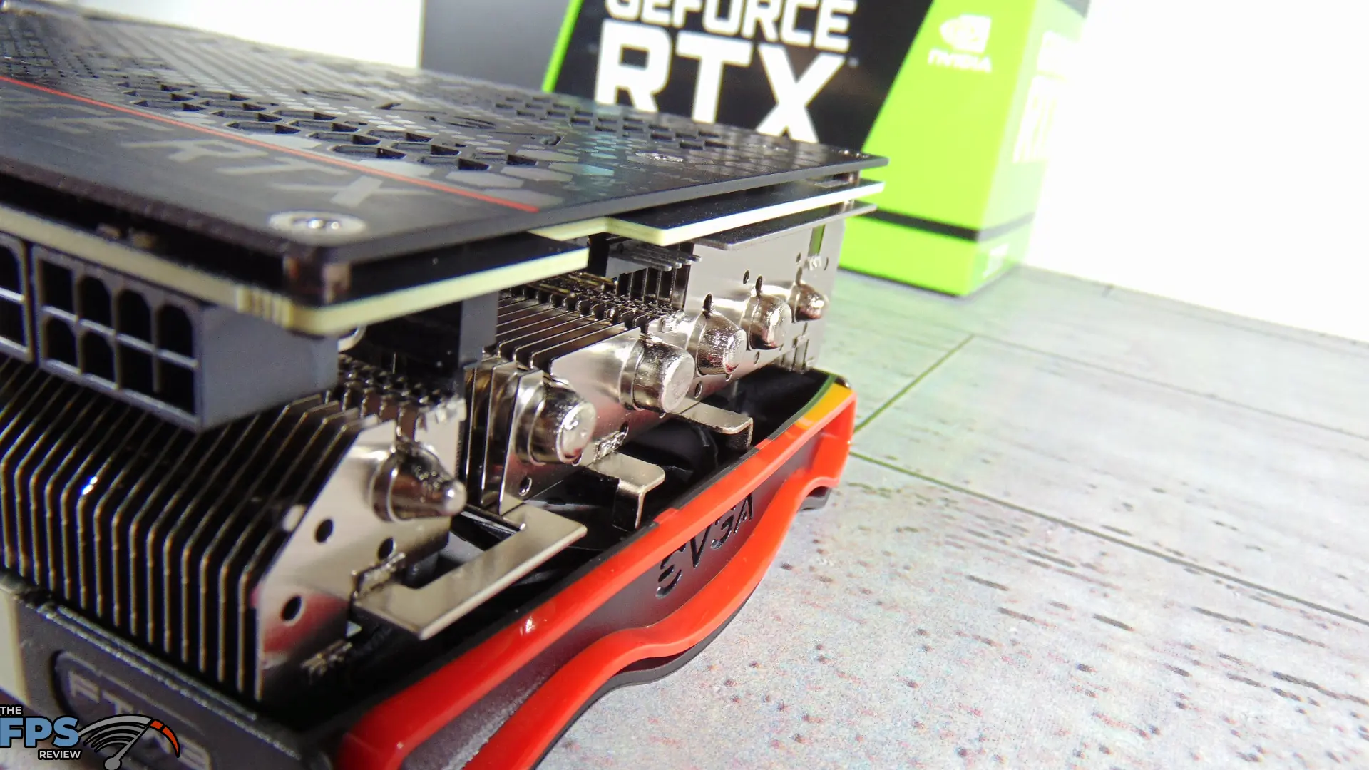

The EVGA GeForce RTX 3080 FTW3 ULTRA GAMING has one HDMI port, and three DisplayPorts.  It also requires 3 8-pin power connectors, yes 3, so make sure your PSU has 3 available PCIe power cables, some don’t, especially lower Wattage PSUs.  A minimum 750W PSU is required, and the Total Power Draw is rated at 320W for this card.

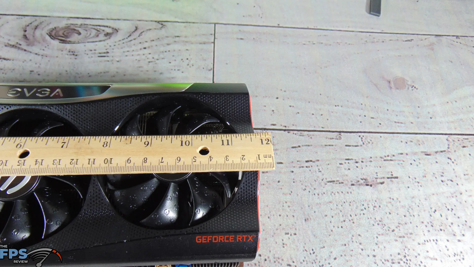

In terms of size, the video card measures exactly 11.81 inches in length.  This is longer than the Founders Edition which was 11.2” long.  It is also 5.38” in height and a 2.75 Slot video card in width.  The Founders Edition is narrower at 4.4” in height, so this EVGA card is much wider and requires more slot width.  This is a big and heavy video card, do not underestimate that.  It’s so big and heavy in fact, the packaging includes a sag bracket.

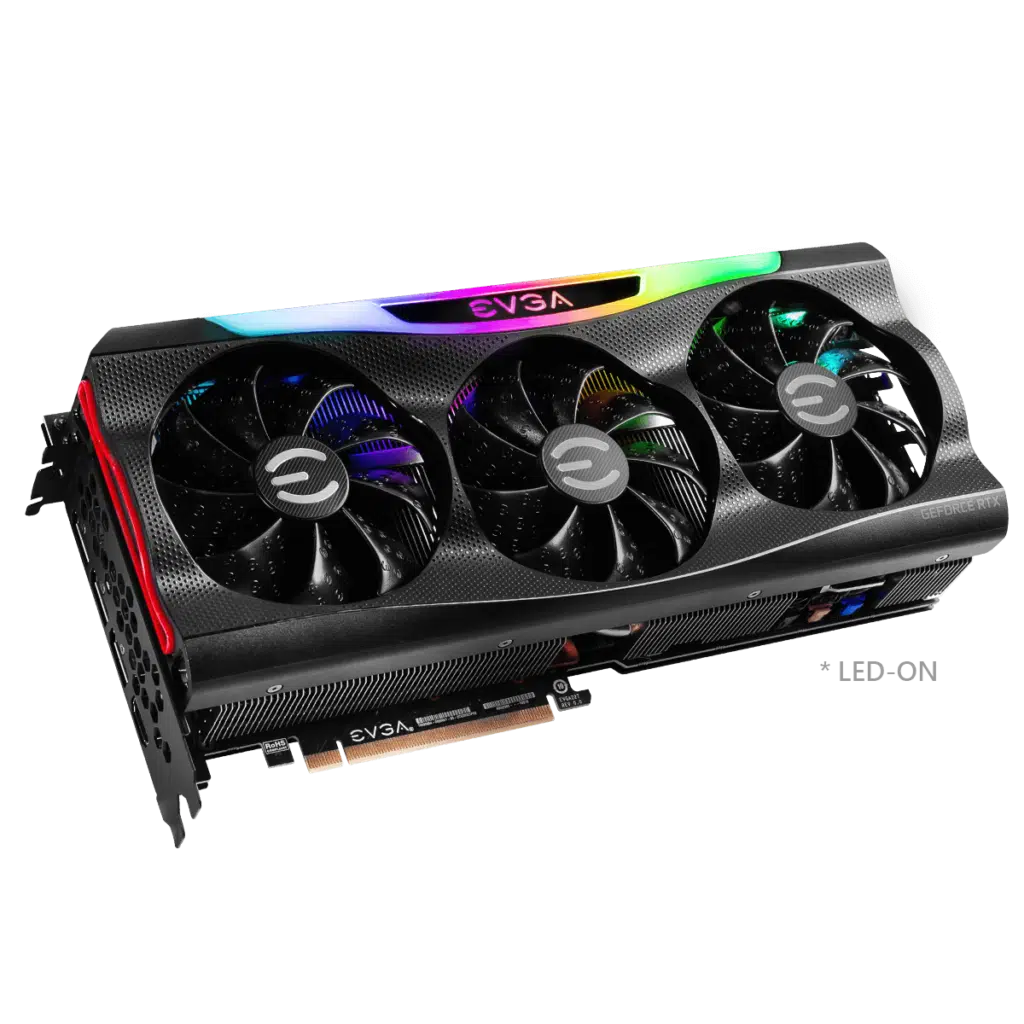

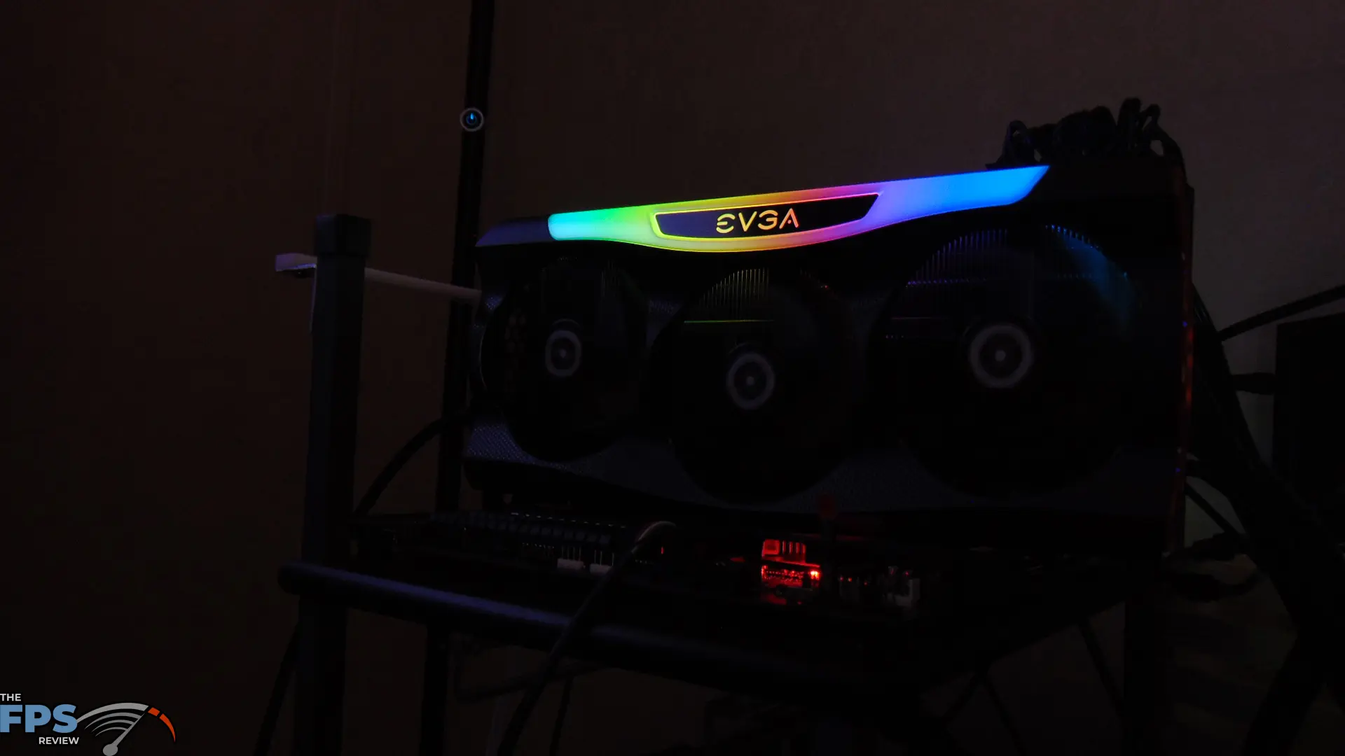

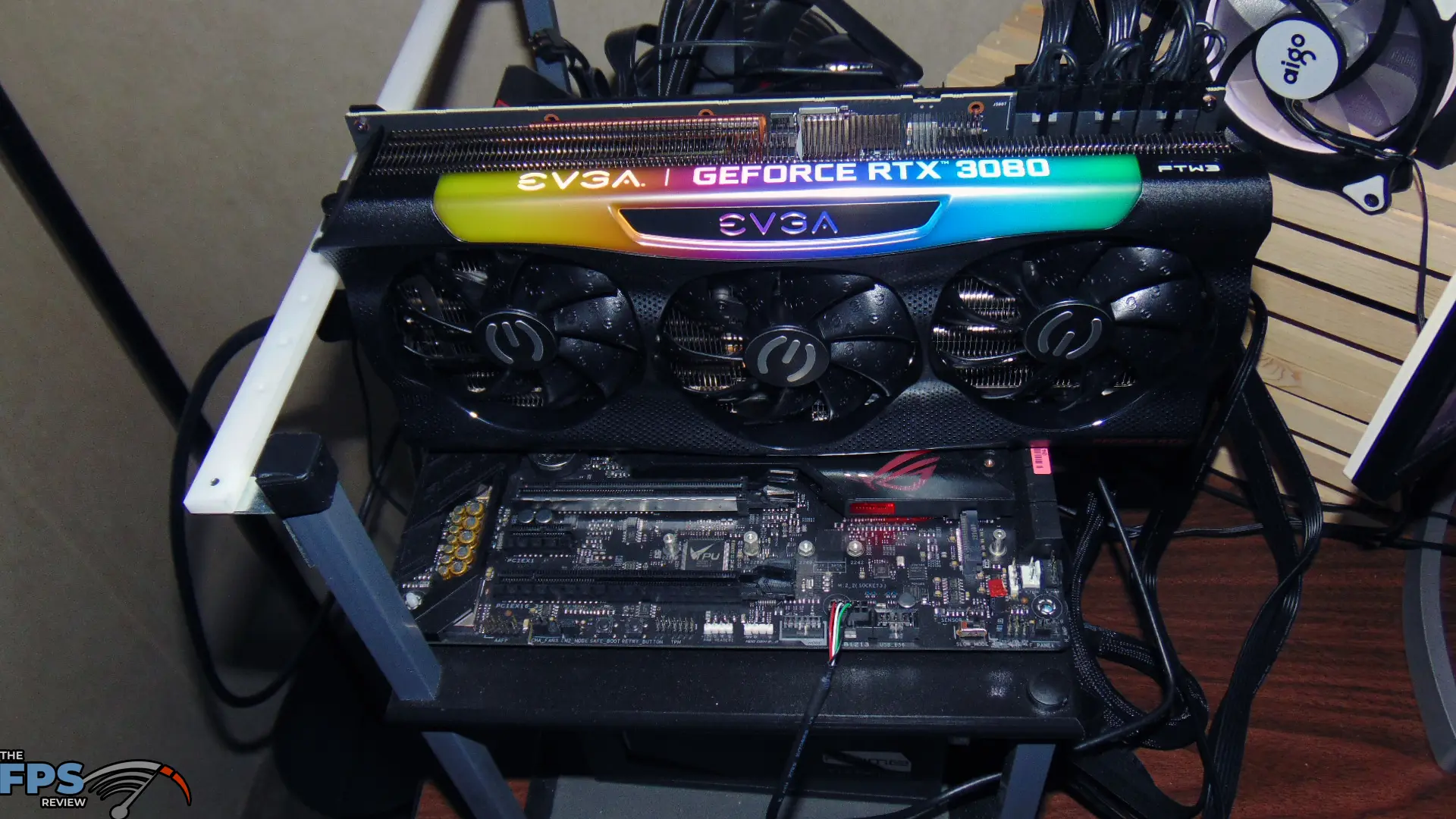

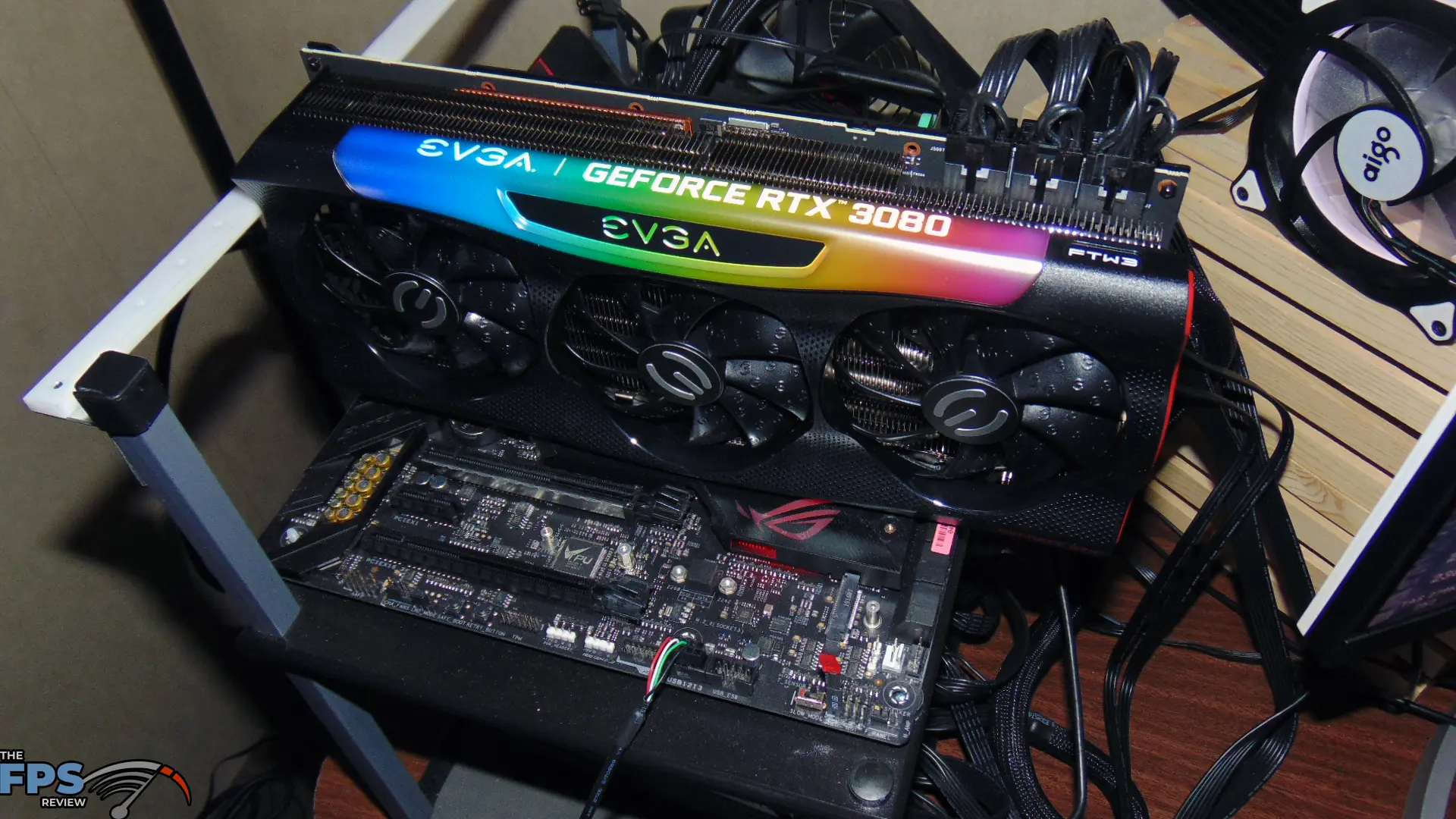

The EVGA GeForce RTX 3080 FTW3 ULTRA GAMING video card also has adjustable ARGB LED lighting.  You can use EVGA Precision X1 to customize the lighting in multiple ways. EVGA includes a 3-year warranty.
