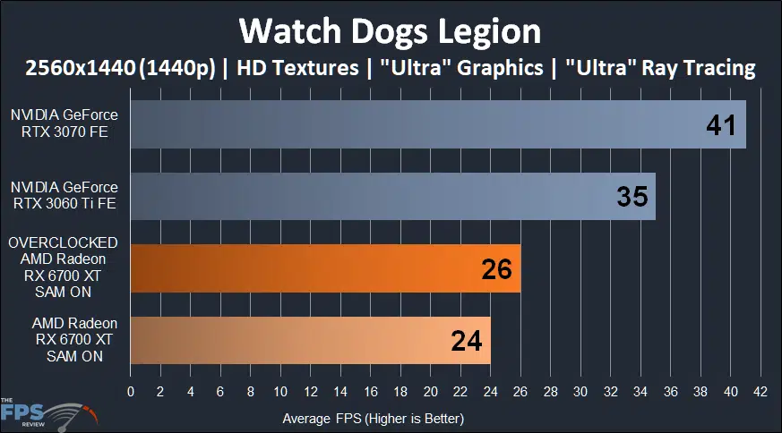

Watch Dogs Legion
For Watch Dogs Legion we are running at 1440p and “Ultra” quality and we have enabled “Ultra” Ray Tracing.
AMD Radeon RX 6700 XT Overclocked Watch Dogs Legion 1440p Ray Tracing Performance Graph
Overclocking the AMD Radeon RX 6700 XT in Watch Dogs Legion with Ray Tracing improved performance by 8%. This sounds like a lot, but in reality, we are talking 2FPS on average, and at 26FPS the game is nowhere near playable. Both GeForce RTX video cards are beating it by a lot, the RTX 3070 is 58% faster.

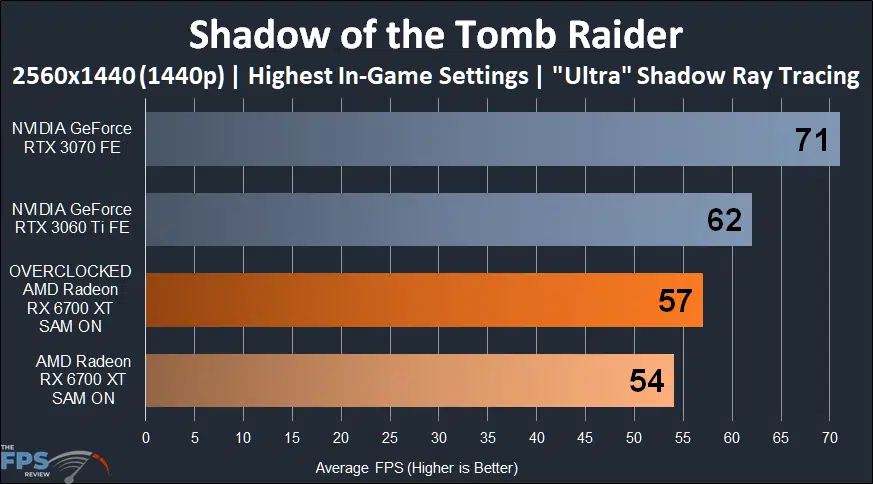

Shadow of the Tomb Raider
In Shadow of the Tomb Raider we are running at 1440p with SMAA 2TX enabled and the highest in-game settings. We have enabled “Ultra” Shadow Ray Tracing.
AMD Radeon RX 6700 XT Overclocked Shadow of the Tomb Raider 1440p Ray Tracing Performance Graph
Overclocking the AMD Radeon RX 6700 XT in Shadow of the Tomb Raider with Ray Tracing improved performance by 6%. With the card overclocked the game is much more playable with Ray Tracing enabled at 1440p, it’s smooth and enjoyable. The GeForce RTX 3060 Ti is still faster though, and the GeForce RTX 3070 is 25% faster.

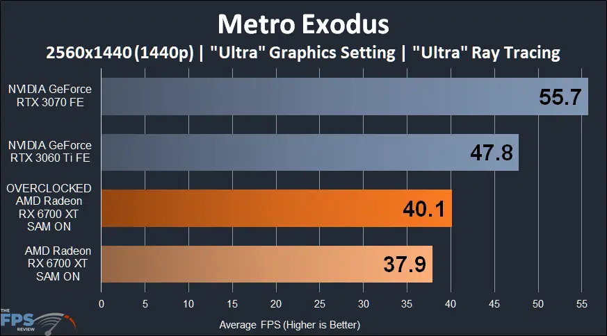

Metro Exodus
In Metro Exodus we are running at 1440p but instead of using the “Extreme” quality setting, we have set it down one level to the “Ultra” quality level. The reason being, we tried “Extreme” and with Ray Tracing enabled all the video cards were just way too slow, and very unplayable. Therefore by lowering the quality to “Ultra” quality level we can at least get a good feel for how the cards compare with Ray Tracing. The Ray Tracing quality itself is on the “Ultra” setting.
AMD Radeon RX 6700 XT Overclocked Metro Exodus 1440p Ray Tracing Performance Graph
Overclocking the AMD Radeon RX 6700 XT in Metro Exodus with Ray Tracing improved performance by 6%. Unfortunately this still did not make the game playable at 1440p. The GeForce RTX 3060 Ti is still faster, and the GeForce RTX 3070 is 39% faster.
