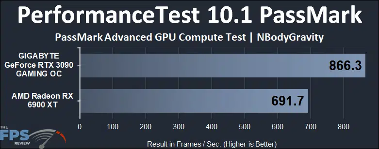

Radeon RX 6900 XT vs GeForce RTX 3090 Compute Benchmarks PerformanceTest PassMark NBodyGravity
NBodyGravity is a physics simulation of gravity and motion. It seems the RTX 3090 is faster at this compute performance by 25%.

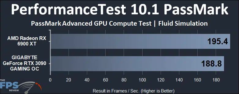

Radeon RX 6900 XT vs GeForce RTX 3090 Compute Benchmarks PerformanceTest PassMark Fluid Simulation
This test performs a fluid simulation using the MacCormack method to simulate a fire reaction in an enclosed volume. The AMD Radeon RX 6900 XT seems to be just slightly faster at this fluid simulation by 3% over the RTX 3090.

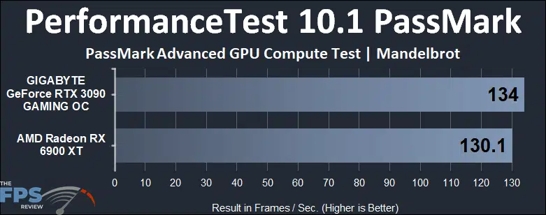

Radeon RX 6900 XT vs GeForce RTX 3090 Compute Benchmarks PerformanceTest PassMark Mandelbrot
This test continuously zooms onto a particular point in a two-dimensional Mandelbrot fractal set, generating various shapes and patterns. The RTX 3090 is faster here just slightly by 3%.

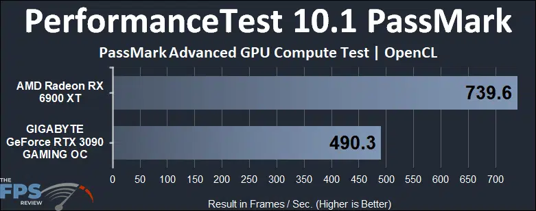

Radeon RX 6900 XT vs GeForce RTX 3090 Compute Benchmarks PerformanceTest PassMark OpenCL
In the OpenCL physics testing the AMD Radeon RX 6900 XT is a lot faster than the RTX 3090 by 51%.
