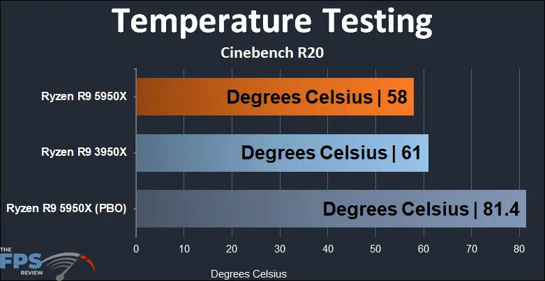

Temperature
From a temperature perspective, the Ryzen 9 5950X registered 3 degrees Celsius cooler than the Ryzen 9 3950X while running loops of Cinebench R20. Turning on PBO pushed the temperature up to 81.4 degrees Celsius which is a bit warmer than we’d want to run the chip on a full-time basis. Keep in mind the PBO temperature was achieved on an open test bench with a 360MM radiator – anything less will report higher temperatures.
