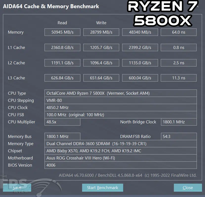

We are now going to use AIDA64’s Cache and Memory benchmark to look at RAM memory bandwidth and RAM and cache latencies between both CPUs.
The Ryzen 7 5800X3D and Ryzen 7 5800X have the same memory read and write bandwidth and latency as expected. What is most interesting is the L3 cache, the latencies are very similar between both CPUs so AMD has done great things in keeping latencies low on the new 3D V-Cache on the Ryzen 7 5800X3D.
