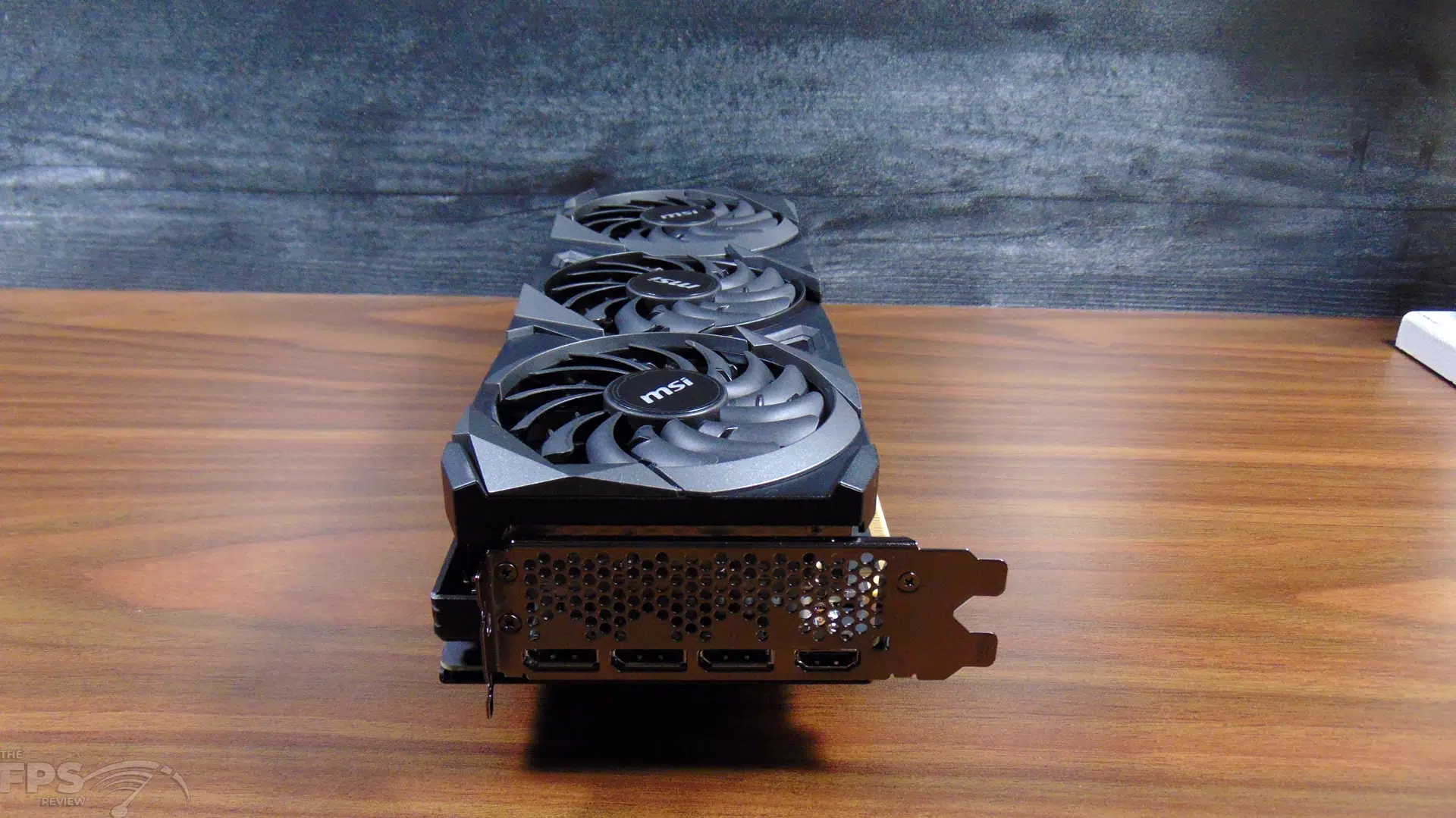

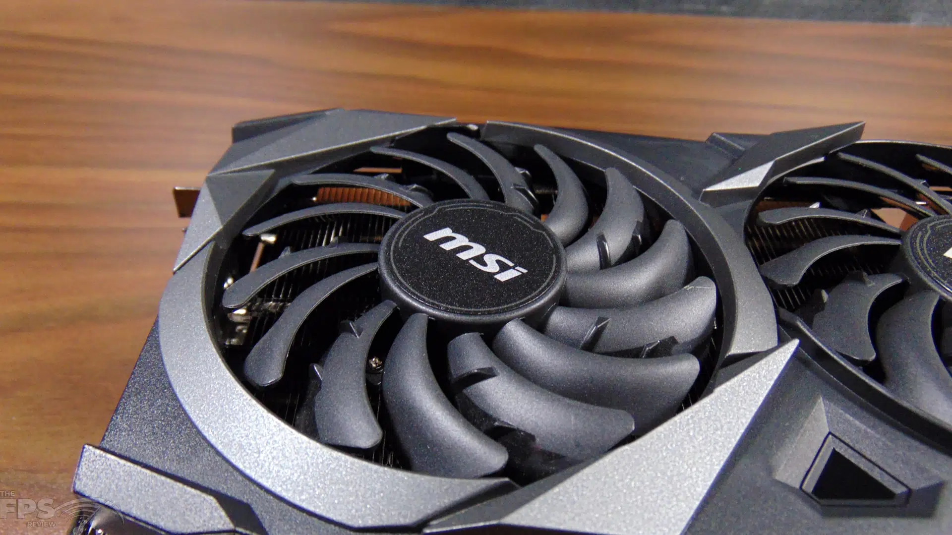

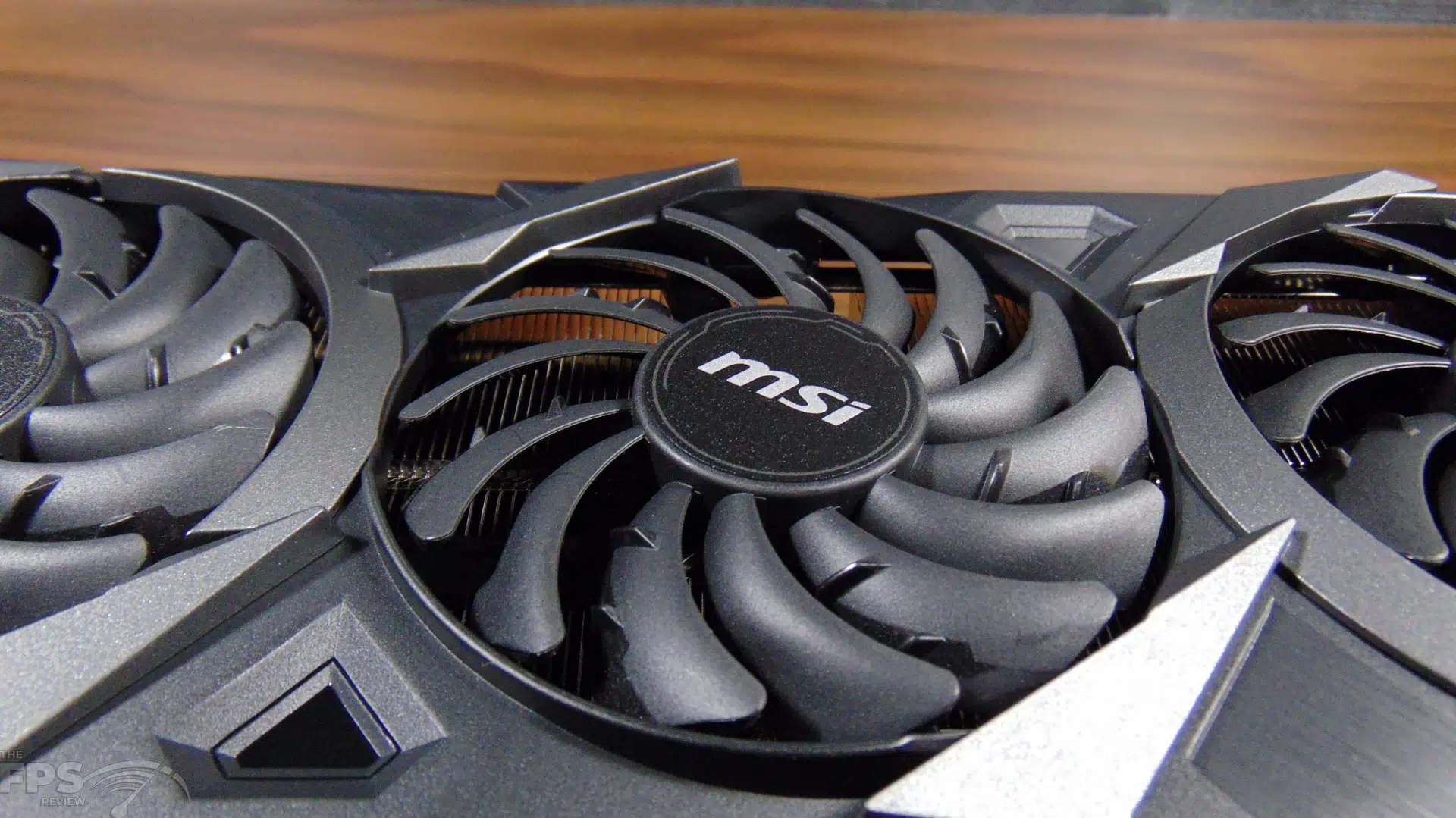

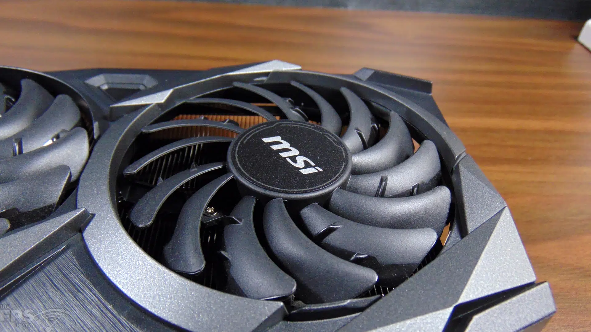

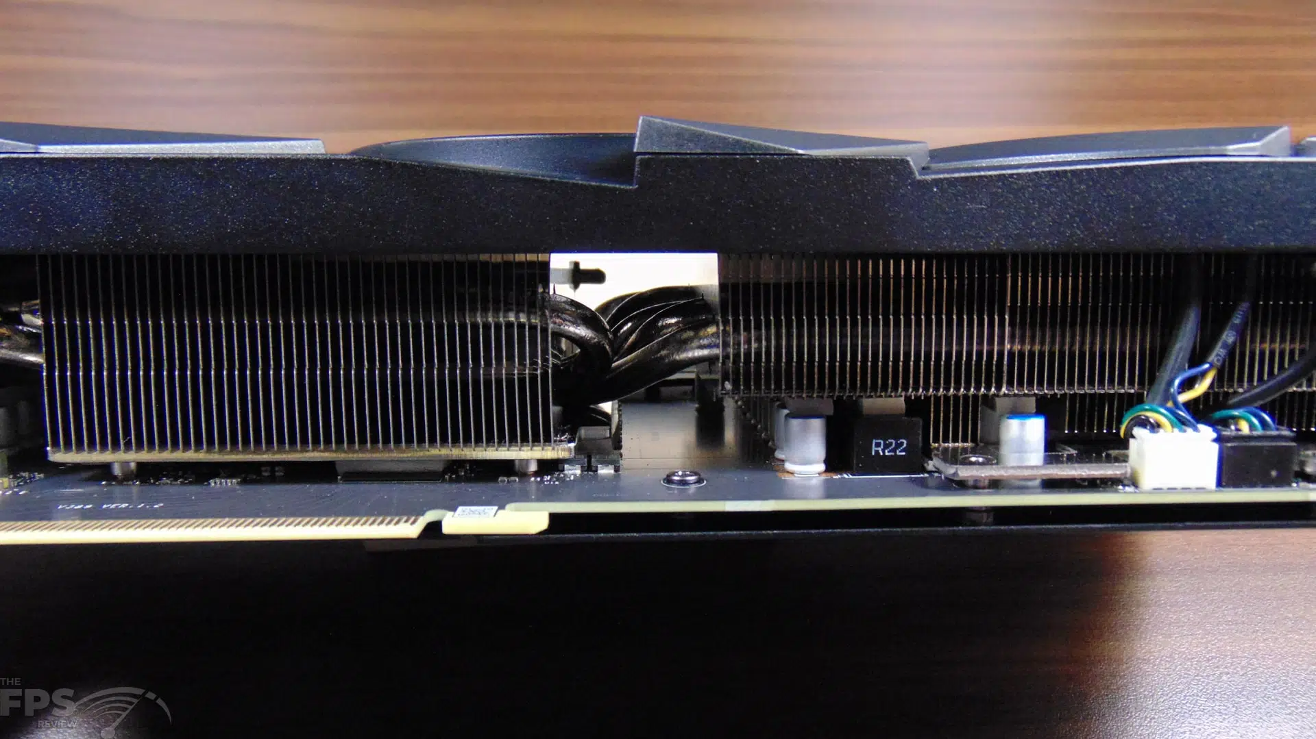

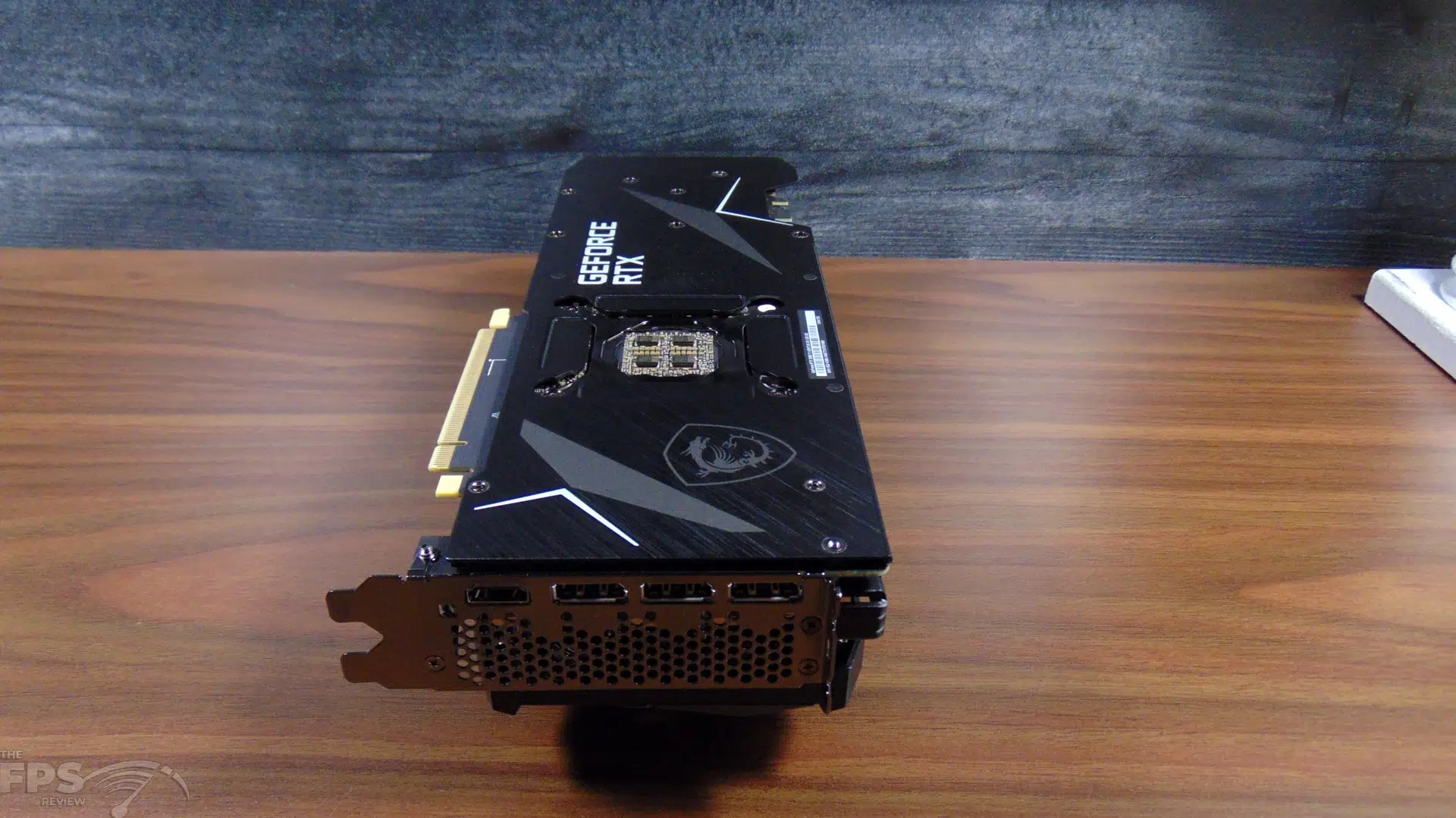

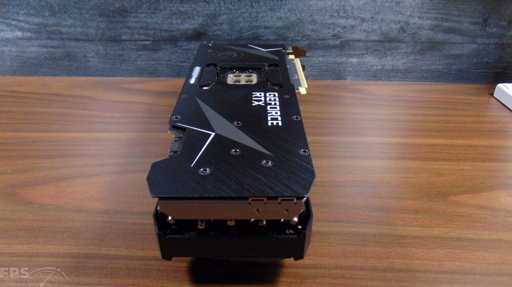

The MSI GeForce RTX 3080 Ti VENTUS 3X 12G OC video card denotes “3X” in the title for its 3 MSI TORX Fan 3.0 design shroud.  The fan blades alternate between traditional blades and dispersion blades that focus and accelerate airflow into the heatsink.  They also support Zero Frozr technology which stops the fans at low loads and temps.  The heatsink uses Core Pipes that are precision-machined for maximum contact over the GPU to spread heat along the full length of the heatsink.  Ample thermal pads are used on various board components to transfer heat.

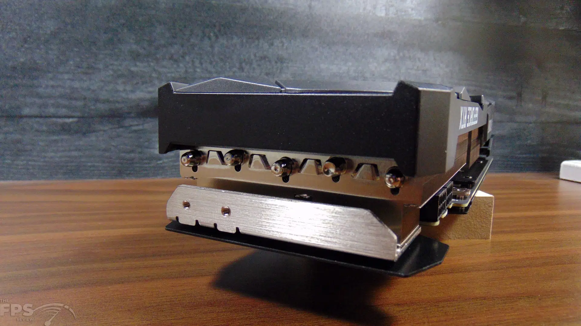

The MSI GeForce RTX 3080 Ti VENTUS 3X 12G OC uses a custom PCB design created by MSI to provide greater reliability with beefed-up power circuitry.  Along the PCB is an Anti-bending bracket installed to reinforce the video card to keep it from sagging, bending, or twisting.  There is also a full brushed aluminum backplate to reinforce the full length of the video card and provide passive cooling by applying thermal pads.

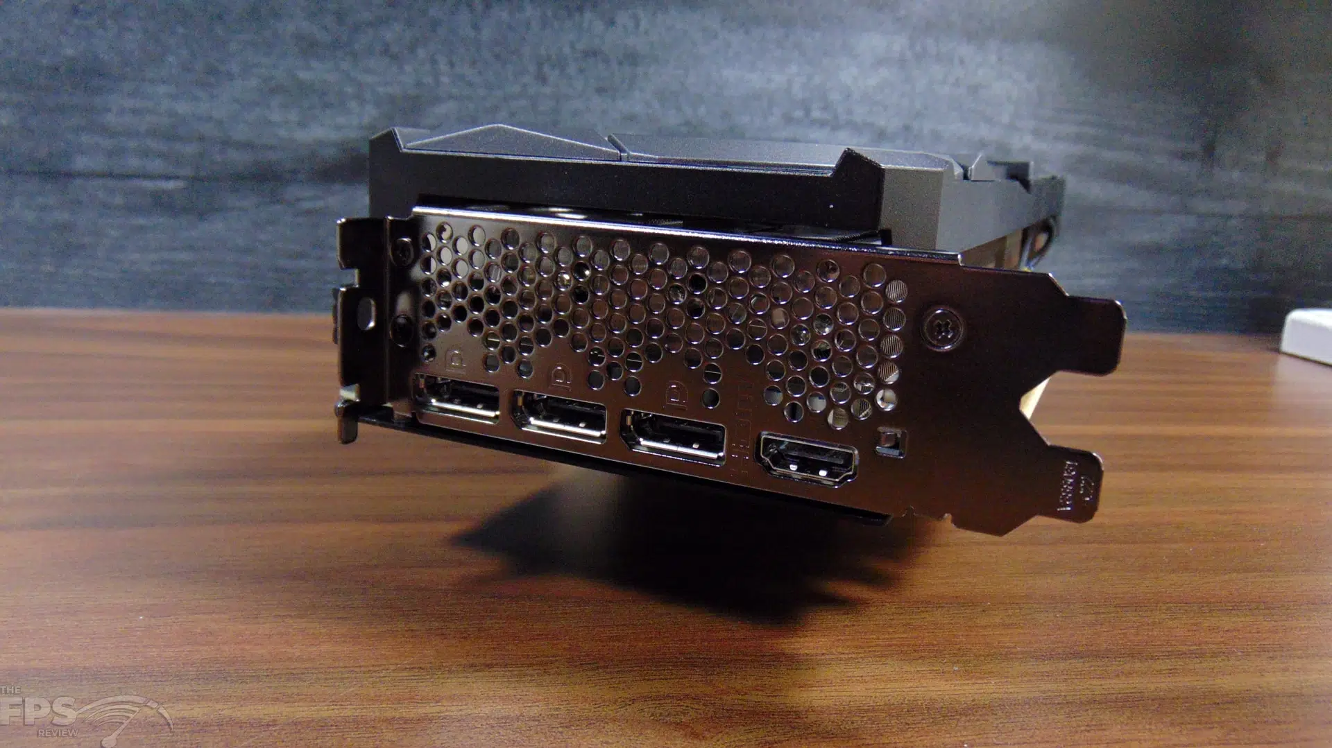

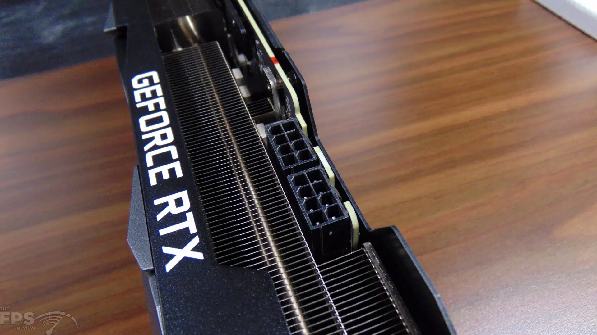

The video card measures 12” inches in length, 4.7” inches in width, and 2.2” inches in height.  It has 3x DisplayPort v1.4a and 1x HDMI 2.1 ports.  It requires two 8-pin power connectors and the TDP is 350W and MSI recommends a 750W PSU.

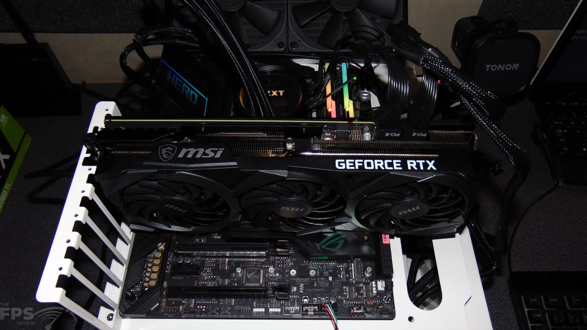

This is an RGB-less video card, there is no lighting of any kind.  It supports MSI Center and MSI Afterburner for tweaking and overclocking.
