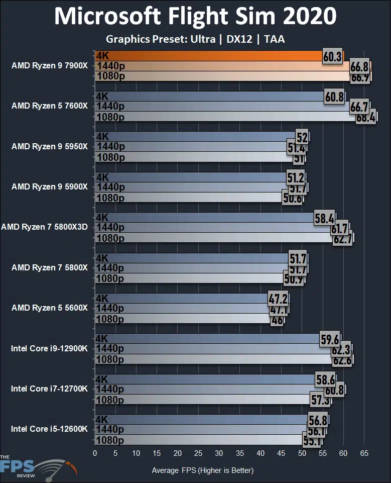

Microsoft Flight Simulator 2020
Ryzen 9 7900X Review Microsoft Flight Simulator 2020
Microsoft Flight Simulator 2020 is a notoriously CPU-driven game, and you can see that above with the performance being so close in each resolution. We are using the latest patch in the game, and DX12 is enabled. The first thing that you can clearly see is how much faster the new Zen 4 CPUs are in this game. The Ryzen 9 7900X and 7600X simply blow away every CPU here, including all the Alder Lake CPUs.
Firstly, Alder Lake is superior in performance over the Ryzen 5000 series, they offer a lot of performance, and the Ryzen 7 58003D is also a champion in this game. But as much as Alder Lake improved performance over the Ryzen 5000 series, the new Ryzen 7000 CPUs blow away Alder Lake in this game. They just truly allow the best experience at every resolution, 4K included.
The Ryzen 9 7900X is 18% faster at 4K compared to the 5900X, and 29% faster at 1440p and 32% faster at 1080p. Even compared to the Intel Core i9-12900K the 7900X is slightly faster at 4K, 7% faster at 1440p and 7% at 1080p.

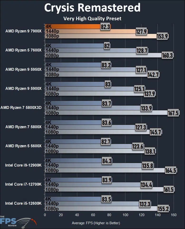

Ryzen 9 7900X Review Crysis Remastered
We have included Crysis Remastered because this game is also very CPU-driven. At 4K, we can see it is not so much, but at 1440p and below it is. The Ryzen 9 7900X is 2% faster than the 5900X at 1440p and 12% faster at 1080p. However, the Intel Core i9-12900K is faster at 1440p and 1080p compared to the 7900X. At 1440p it is 6% faster and at 1080p it is 7% faster.

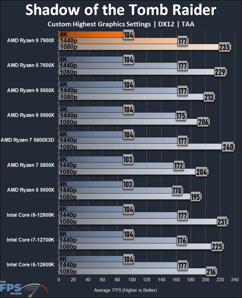

Shadow of the Tomb Raider
Ryzen 9 7900X Review Shadow of the Tomb Raider
We decided to throw in an older game, which we used to use for GPU benchmarks quite a bit because this game was used in AMD marketing for performance, it was in one of their graphs for gaming performance. We thought it would be good to have some validated tests done so you can validate their results as well and compare against it. But this game actually turned out to be quite good for the 1080p results. At 4K it’s GPU bound, and also at 1440p. At 1080p though we can see the Ryzen 9 7900X is 14% faster than the Ryzen 9 5900X. The 7900X also beats out the 12900K a bit at 1080p.
