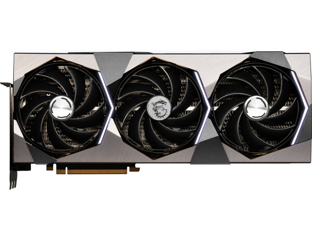

Our review of the MSI GeForce RTX 4090 SUPRIM X gave us a nice opportunity to evaluate the best of the best MSI has to offer. This video card represents the fastest GPU NVIDIA offers in a beautifully appointed package. The cooling performance is excellent as well. We tested at 4K with and without Ray Tracing enabled and also overclocked the video card. Our comparison was the AMD Radeon RX 7900 XTX a very good performer as you can see.

This MSI GeForce RTX 4090 SUPRIM X 24G video card lives up to the billing. It hits all the marks. It looks amazing, is very well built, and is superbly cooled. It rips through gameplay and is more than competent at Ray Tracing. It’s big and has a price tag to match.
