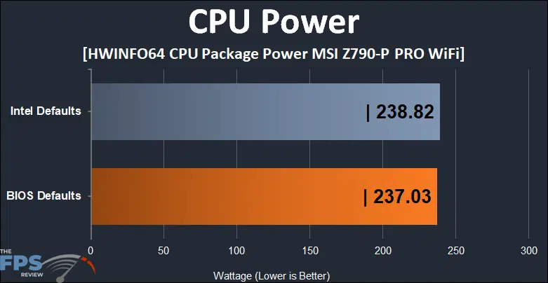

MSI Z790-P PRO WiFi CPU package power.
Functionally, the CPU package power is the same between both power limit settings. Despite being uncapped, the BIOS default settings from MSI don’t really help here. This is in part due to the fact that the CPU simply runs too hot to take advantage of the additional headroom.

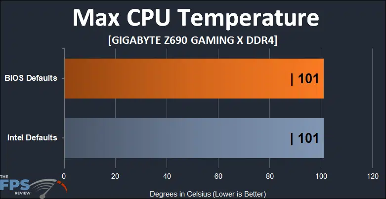

MSI Z790-P PRO WiFi maximum CPU temperature.
CPU temperatures are identical for both Intel and MSI default power limit values. At 101c, the CPU will end up throttling down. As you can see from the data below, the average clock speeds are well below the maximum values.
