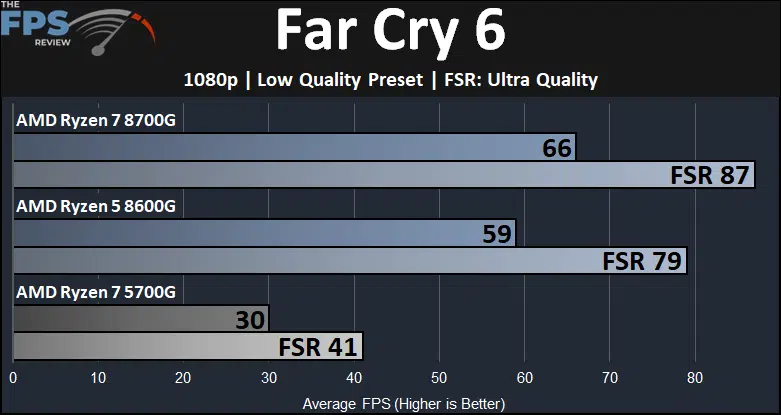

Far Cry 6 came out in 2021, about 3 years ago now, but this game does have involved graphics, though typically not the most intensive to run now. The AMD Ryzen 7 8700G and Ryzen 5 8600G are able to provide a playable experience at the “Low” quality preset without needing upscaling. The 8700G is 120% faster than the 5700G and the 8600G is 97% faster. The difference between the 8700G and 8600G is 12%. Turning on FSR does add to the performance, on the 8700G it improves performance by 32%, and on the 8600G 34%.

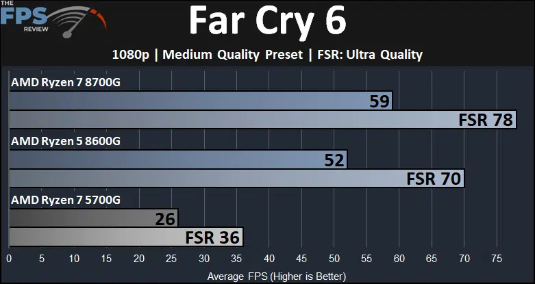

Far Cry 6 Ryzen 7 8700G and Ryzen 5 8600G and Ryzen 7 5700G Game Performance Graph
The game is still playable on Medium quality preset on the 8700G without upscaling, and playable on the 8600G as well and more so with FSR. The 8700G is 127% faster than the 5700G and the 8600G is 100% faster. The difference between the 8700G and 8600G is 13%. Turning on FSR improves performance by 32% on the 8700G and 35% on the 8600G.

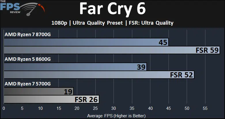

At Ultra quality only the 8700G with FSR is really playable here. The 8700G is 137% faster than the 5700X and the 8600G is 105% faster. The difference between the 8700G and 8600G is 15%.

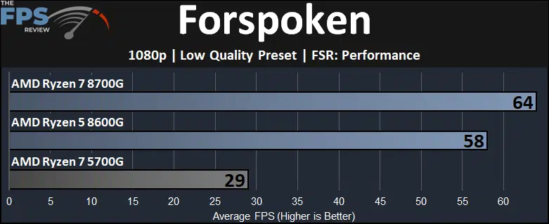

Forspoken came out at the beginning of 2023 and is a very demanding game, so we aren’t surprised with the results beyond the Low setting in this game. In the above graph, we are using the “Low” preset, which also inherently turns on FSR Upscaling at the Performance setting, not quality, so this is the lowest form of FSR upscaling image quality, but to use the preset it is always enabled. With it enabled, we can see that the 8700G and 8600G are playable. The 8700G is 121% faster than the 5700G and the 8600G is 100% faster. The difference between the 8700G and 8600G is 10%.

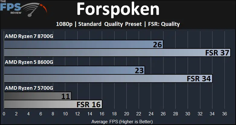

Now, when we move just one step above the low-quality setting, which is the “Standard” quality setting, it tanks performance big time, even when we enable quality FSR. This game is not playable on these new APUs beyond low quality in this game. The 8700G is 137% faster than the 5700G and the 8600G is 109% faster.

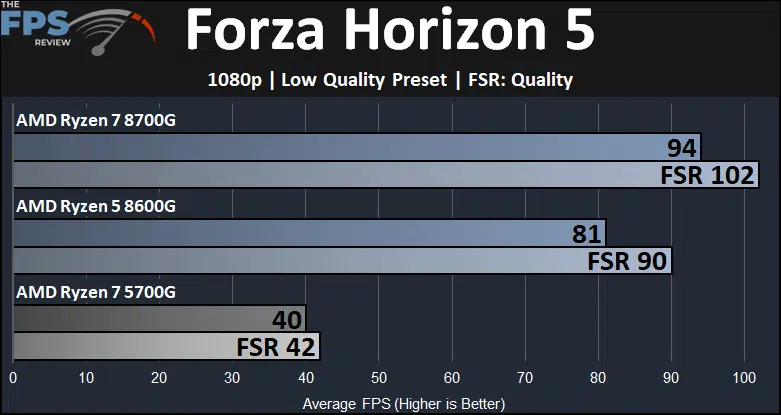

Forza Horizon 5 Ryzen 7 8700G and Ryzen 5 8600G and Ryzen 7 5700G Game Performance Graph
Forza Horizon 5 came out in 2021 but is still receiving updates, and does support all the upscaling techniques. This game performs extremely well on the new Ryzen 8000G APUs. It is not playable on the 5700G at Low but it is more than playable on the 8700G and 8600G at Low. The 8700G is 135% faster than the 5700G and the 8600G is 103% faster. The difference between the 8700G and 8600G is 16%. FSR adds small improvements at this lower setting.

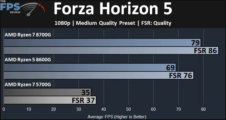

Moving up to “Medium” quality the 8700G and 8600G are both again still playable in this game, and above 60FPS. The 8700G is 126% faster than the 5700G and the 8600G is 97% faster. The difference between the 8700G and 8600G is 15%, and FSR adds a small 9% bump in performance.

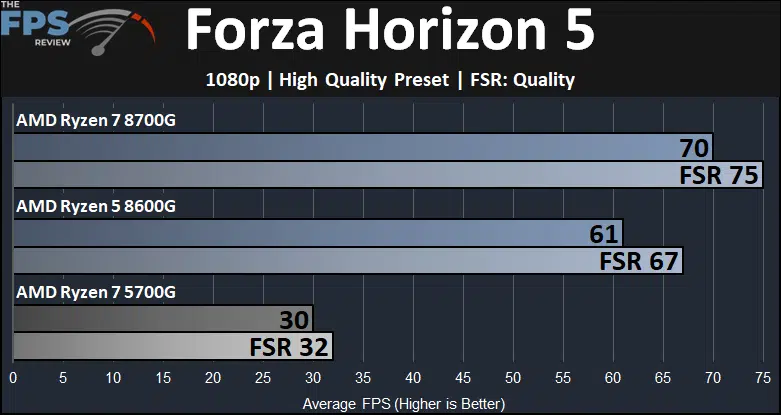

Even at “High” quality Forza Horizon 5 is playable on the 8700G and 8600G with smooth performance. The 8700G is 133% faster than the 5700G and the 8600G is 103% faster. The difference between the 8700G and 8600G is 15% and FSR is once again a small factor.
