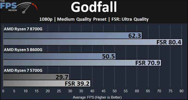

Godfall was released in 2020, so this represents a bit of an older game at this point, but the game does have a lot of moving graphics and effects on screen at one time. We are starting at the “Medium” quality for this one since it ran very well and the game is playable with lower framerates. At Medium quality, the 8700G is playable at 60FPS without upscaling, but the 8600G needs FSR to be playable at Medium settings. The 8700G is 110% faster than the 5700G and the 8600G is 70% faster. The difference between the 8700G and 8600G is 23%. FSR does add to performance and for the 8700G it makes it 29% faster and for the 8600G it is 40% faster.

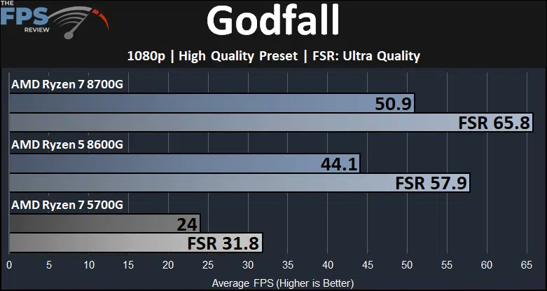

At “High” quality this game is not playable without FSR, for both the 8700G and especially the 8600G. The 8700G is 112% faster than the 5700G and the 8600G is 84% faster. The difference between the 8700G and 8600G is 15% and FSR adds 30% more performance.

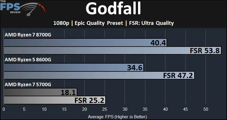

Trying to play this game on Epic quality is not really the best experience. The 8700G is 123% faster than the 5700G and the 8600G is 91% faster. The difference between the 8700G and 8600G is 17%. FSR adds about 33% more performance to the 8700G.

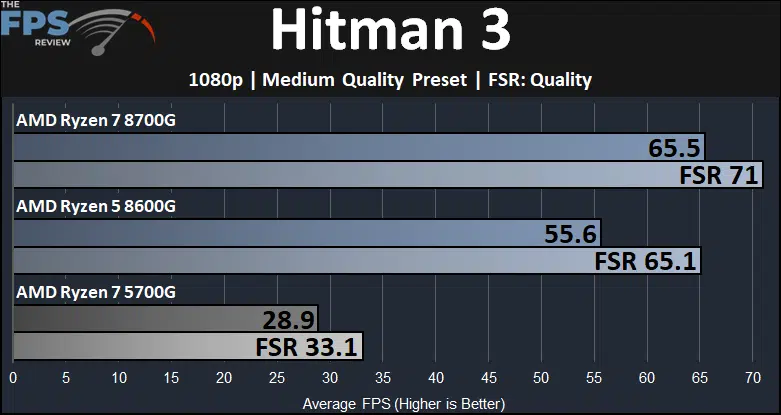

Hitman 3
Hitman 3 Ryzen 7 8700G and Ryzen 5 8600G and Ryzen 7 5700G Game Performance Graph
Hitman 3 came out about 3 years ago, but can still be demanding on the higher settings for these APUs. We started at the “Medium” setting above, and you can see that the 8700G and 8600G are playable, and especially with FSR they have playable framerates at medium quality. The 8700G is 127% faster than the 5700G and the 8600G is 92% faster. The difference between the 8700G and 8600G is 18%. FSR doesn’t add much to performance at this quality setting.

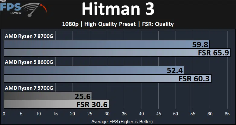

Turning this game up to “High” quality settings is still viable, especially on the Ryzen 7 8700G without upscaling. With the 8600G, using FSR can bring it up to 60FPS. The 8700G is 134% faster than the 5700G and the 8600G is 105% faster. The difference between the 8700G and 8600G is 14%. FSR adds about 10% more performance.

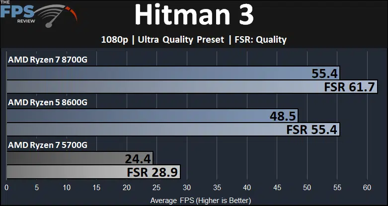

The performance starts to struggle at “Ultra” quality, especially on the 8600G. However, the 8700G is still playable, especially with FSR enabled. The 8700G is 127% faster than the 5700G and the 8600G is 99% faster. The difference between the 8700G and 8600G is 14%. FSR adds about 11% more performance.

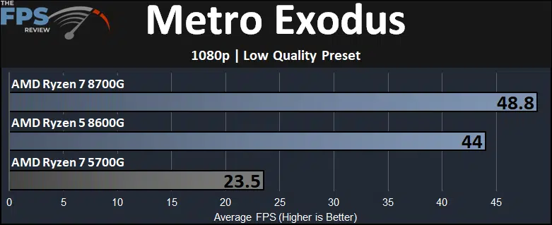

Metro Exodus Ryzen 7 8700G and Ryzen 5 8600G and Ryzen 7 5700G Game Performance Graph
We are running the original Metro Exodus game here, which came out in 2019, there is an Enhanced Edition but that only runs Ray Tracing, so we are not using it. Metro Exodus is a very demanding game for these APUs to test with. This game doesn’t support FSR, so we are just using native resolution. At the “Low” quality preset, this game is very demanding still, and only the 8700G is only barely playable. The 8700G is 108% faster than the 5700G and the 8600G is 87% faster. The difference between the 8700G and 8600G is just 11%.  

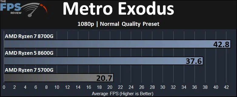

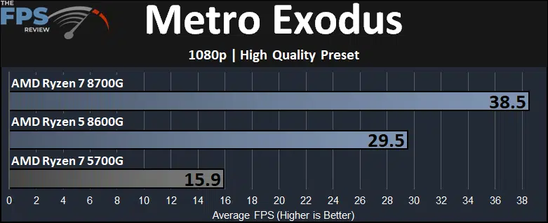

Turning the game up to “Normal” preset definitely is not playable, except again only barely on the 8700G. The 8700G is 107% faster than the 5700G and the 8600G is 82% faster. The difference between the 8700G and 8600G is 14%.

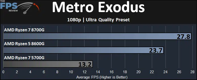

Just to round out the benchmarks, at “Ultra” settings the 8700G is 111% faster than the 5700G and the 8600G is 80% faster. The difference between the 8700G and 8600G is 17%.
