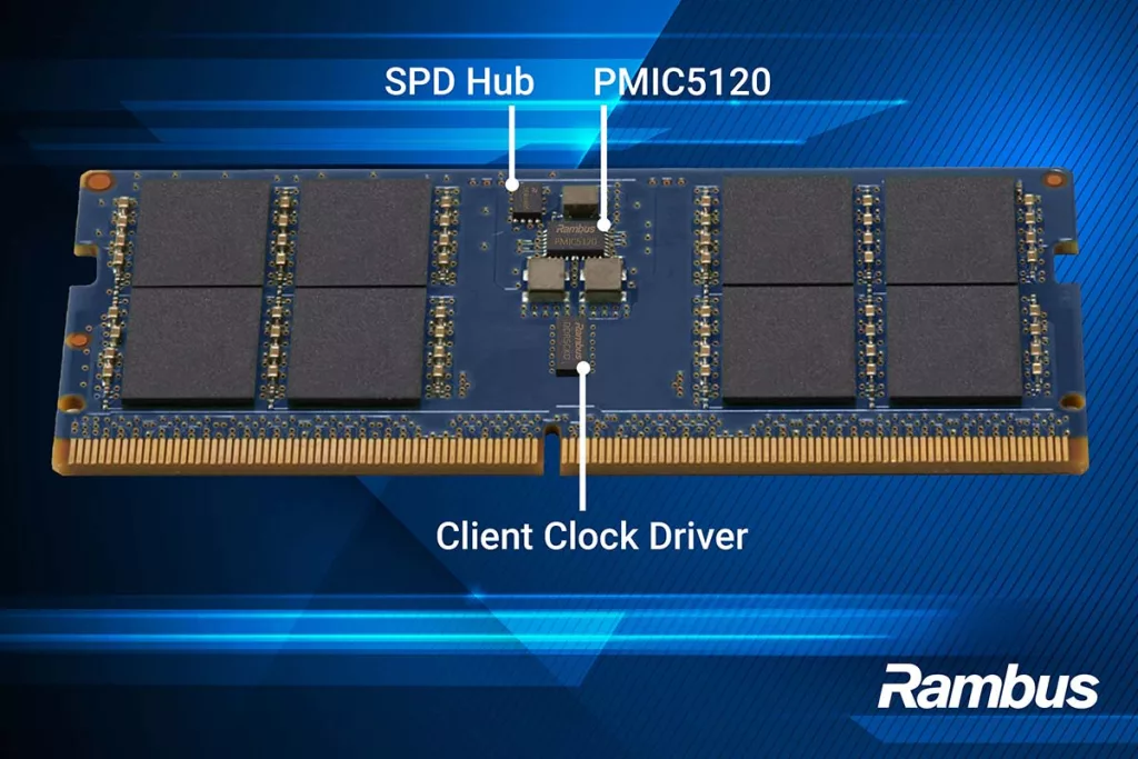

The transition to clocked DDR5 modules has been underway for a while now, but having the chips to actually build those modules at the highest speeds is a different conversation. Rambus (Yes, that Rambus: the one that convinced Intel to bet the Pentium 4 platform on RDRAM, a memory standard so expensive and unloved that DDR wiped the floor with it anyway) is stepping into that gap today with the announcement of its complete DDR5 9600 Client Memory Module Chipset, a three-chip solution targeting CUDIMM, CQDIMM, and CSODIMM form factors for what the company is calling “future generation AI PCs.”
The core of the new offering is the Gen2 Client Clock Driver, or CKD02. For anyone who needs a refresher on why this chip matters: once you push DDR5 past 6400 MT/s, signal integrity becomes a problem. Clock jitter and timing instability start creeping in, and the traditional unbuffered approach runs out of headroom. The CKD’s job is to retime, condition, and redistribute the clock signal from the processor to the DRAM on the module, keeping everything locked and stable at speeds the raw trace alone couldn’t handle. Rambus says the CKD02 supports operation from 8000 to 9600 MT/s.
Completing the chipset are the PMIC5120, which steps the system voltage supply down to the levels the DRAM and other on-module chips actually need, and the SPD Hub with integrated temperature sensor, which handles module identification, configuration, and thermal telemetry over the I3C bus. Nothing exotic there, but having a validated, production-ready combination across all three chips is the actual deliverable here: module makers get a complete, tested stack rather than sourcing and qualifying components piecemeal.
