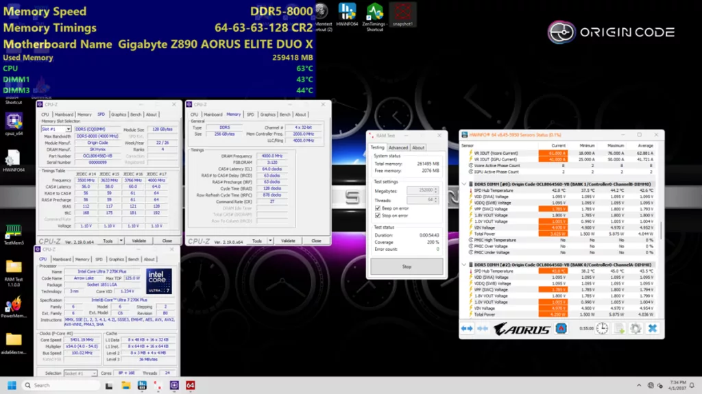

There are two configurations. The standard kit runs at DDR5-8000 MT/s with CL64 timings at 1.1V, which is the JEDEC-standard operating voltage for DDR5. The flagship kit is the more interesting part of the story: DDR5-8000 with CL42 timings at 1.4V, which shaves 22 cycles off the CAS latency at the same transfer rate. Closing a gap that large on a quad-rank module at DDR5-8000 is not table stakes, and it signals that Origin Code’s firmware and memory tuning efforts are more serious than a simple density play. Both kits are a two-stick, 256 GB configuration, validated on the Intel Core Ultra 7 270K Plus and the GIGABYTE Z890 AORUS ELITE DUO X.
