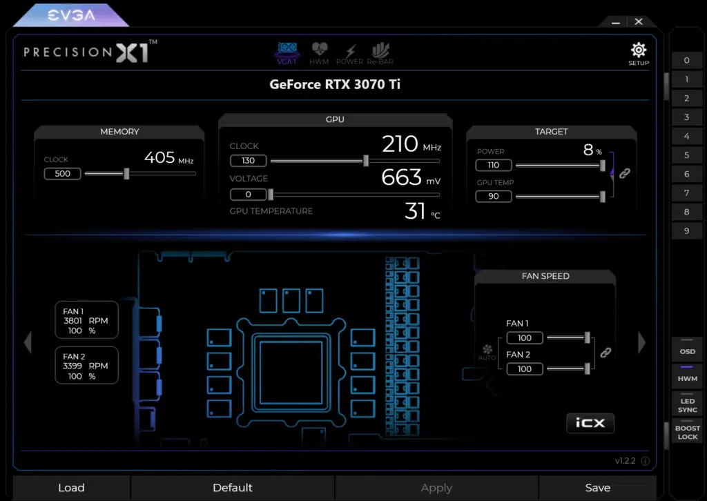

EVGA Precision X1 overclocked NVIDIA GeForce RTX 3070 Ti Founders Edition
How do you overclock an NVIDIA GeForce RTX 3070 Ti Founders Edition?  Well, you start by downloading EVGA Precision X1, which we downloaded the latest version of to overclock with the most updated support of the GPU.  With EVGA Precision X1 we can raise the Power Target up 10% to 110 versus 100.  This will give us some headroom to start, though it is not as high as the GeForce RTX 3080 Ti which allowed a +14% boost to Power Target.
Also, for comparison, the GeForce RTX 3070 FE was only able to boost the Power Target up 9%.  Therefore, we get one more percent out of the new GeForce RTX 3070 Ti FE.  We can also increase the fan speed to 100% for our overclock to make sure we achieve the highest overclock.
We were able to overclock the GPU clock up to +130.  This put the GPU Boost at 1900MHz versus 1770MHz.  To see how this translates into real-world frequency while gaming, look at the graph below.  On the memory overclock we set it at 20GHz versus 19GHz.  This video card uses GDDR6X memory, and that consumes a lot more power.  The increase in power can affect the overall GPU clock frequency if we push the memory too far.  The memory bandwidth has been increased to 640GB/s versus 608GB/s.

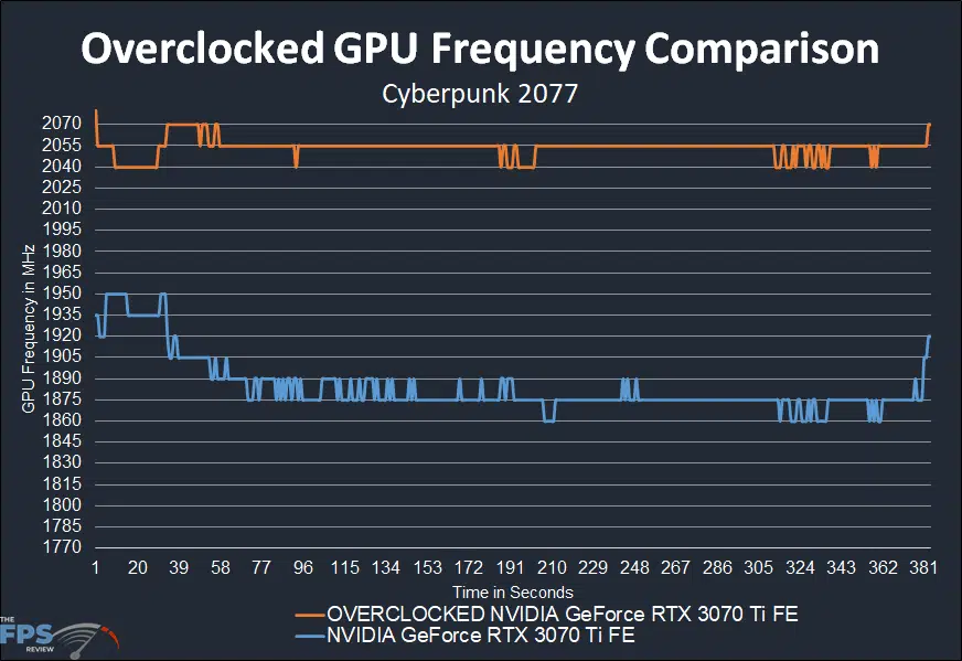

Overclocked GPU Frequency Comparison Graph NVIDIA GeForce RTX 3070 Ti Founders Edition
In the graph above, you can see that our GPU clock speed overclock is sitting well above the default clock speed at +130.  Firstly, 1770MHz (at the bottom of the graph) is the default GPU Boost.  The video card already boosts beyond this up to 1884MHz average.  The overclock, takes it even higher, up to around 2055MHz.  The average was 2054Hz.  That is a 9% overclock versus the default GPU Boost, and 16% over the 1770MHz GPU Boost setting.
