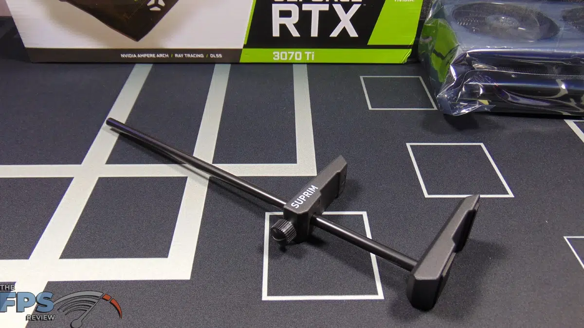

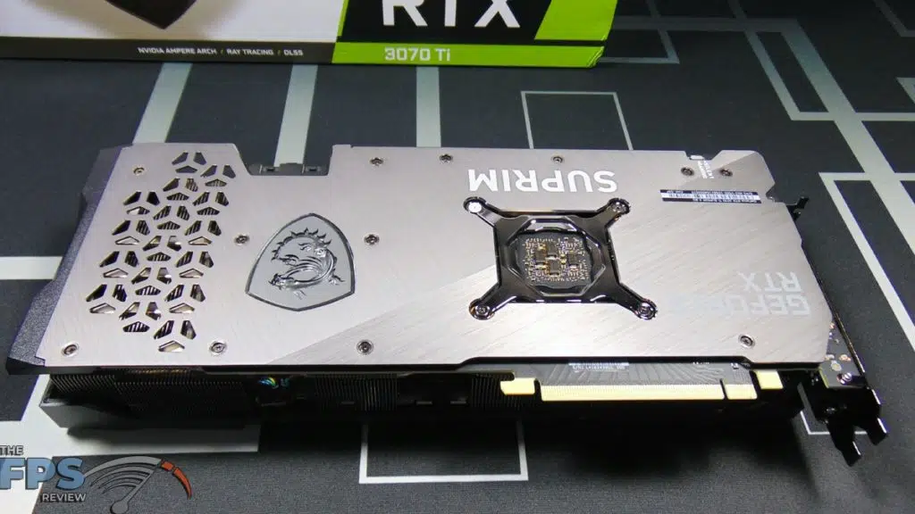

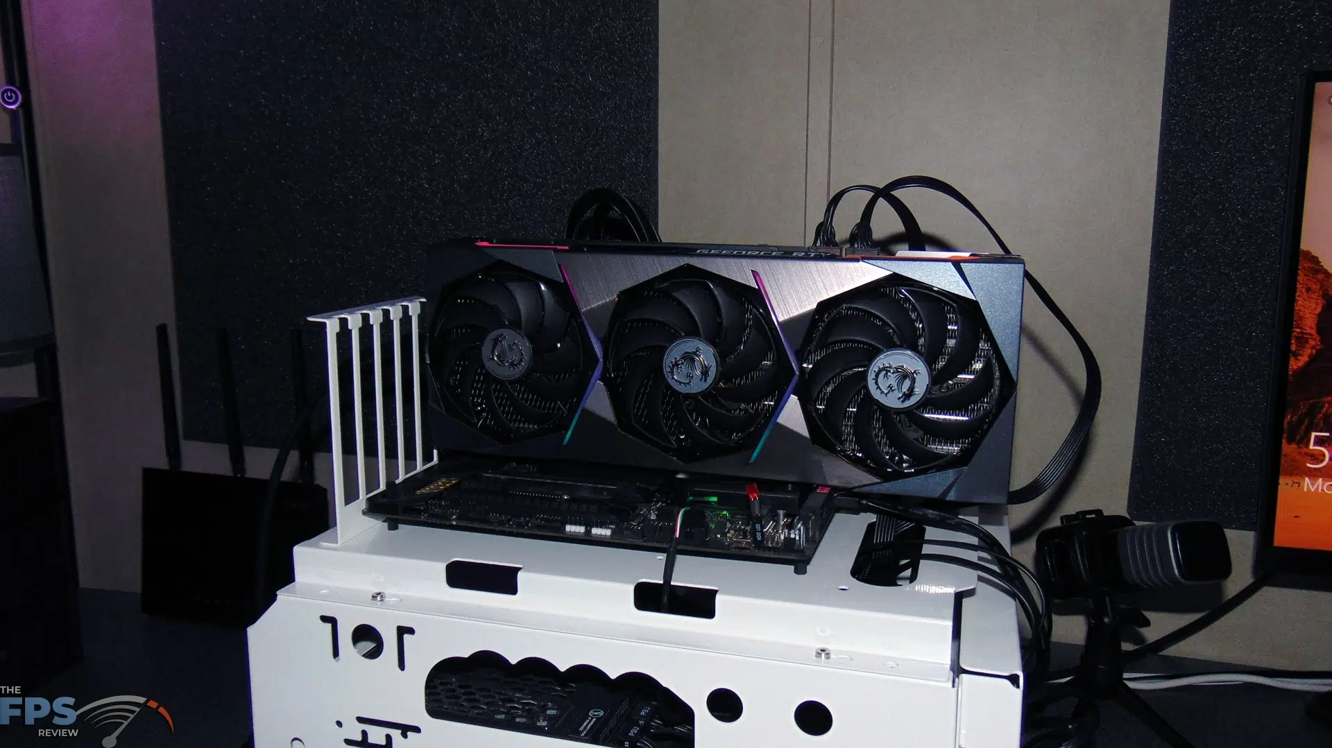

The box is very thick, robust, and protects the video card well. It opens up to present the video card in an appealing well-packaged bag. In the box, you get a nice presentation letting you know the quality of the product you just bought. There is also a nicely sized and very comfortable mouse pad. A stabilizing support bracket is included so that the video card will be properly supported as it is quite long.
The MSI GeForce RTX 3070 Ti SUPRIM X 8G has the highest factory overclock from MSI on the GeForce RTX 3070 Ti GPU. It has a boost clock of 1860MHz by default, compared to the Founders Edition which is clocked at 1770MHz. That is therefore a 90MHz factory overclock boost or 5% over the reference spec. Additionally, through MSI Afterburner or MSI Center, there is an optional “Extreme Mode” that you can enable in software that will increase the boost to 1875MHz. This gives you a significant boost over the reference RTX 3070 Ti spec just with a flip of a switch in software without having to overclock it. It has the standard 8GB of GDDR6X at 19GHz on board.

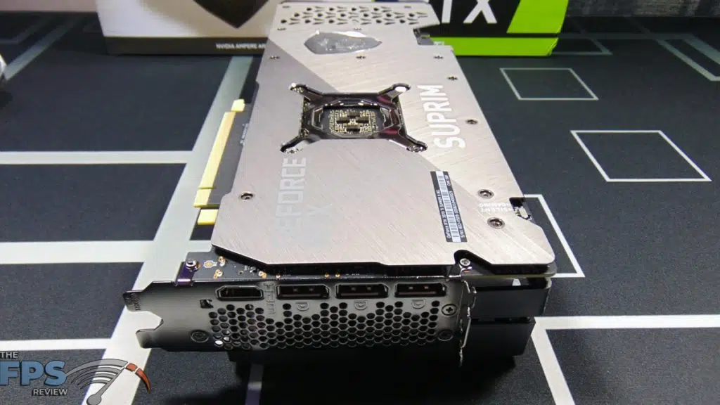

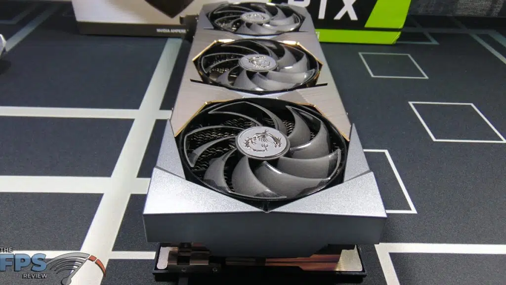

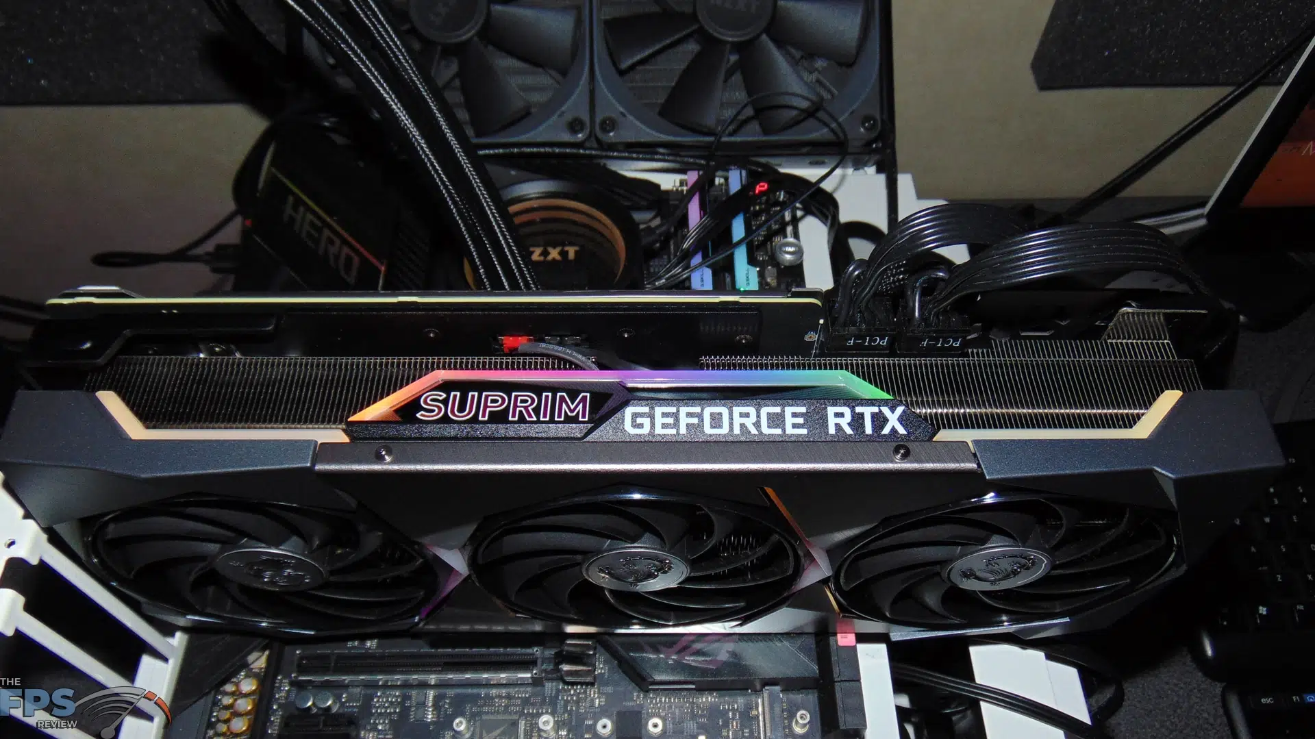

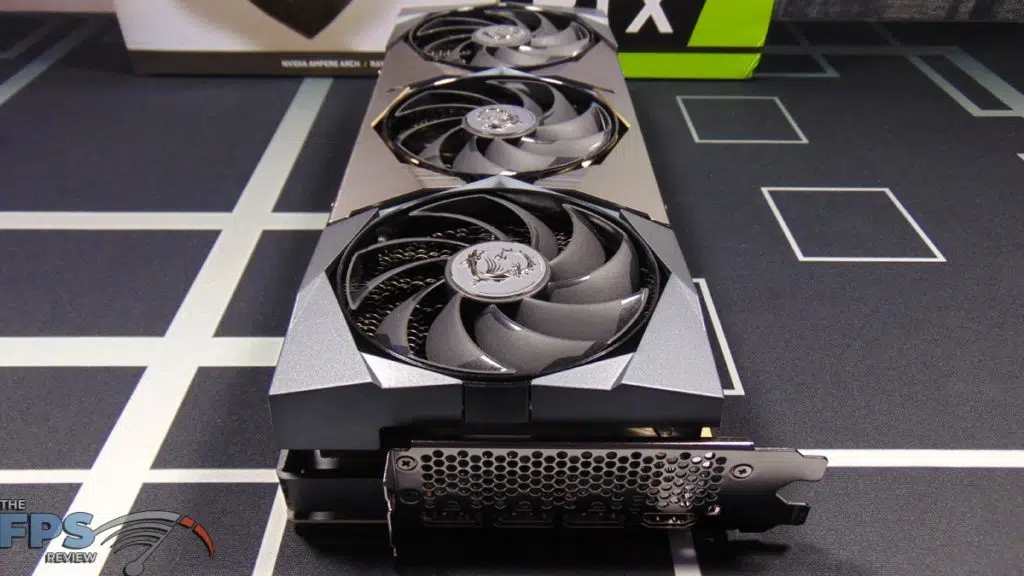

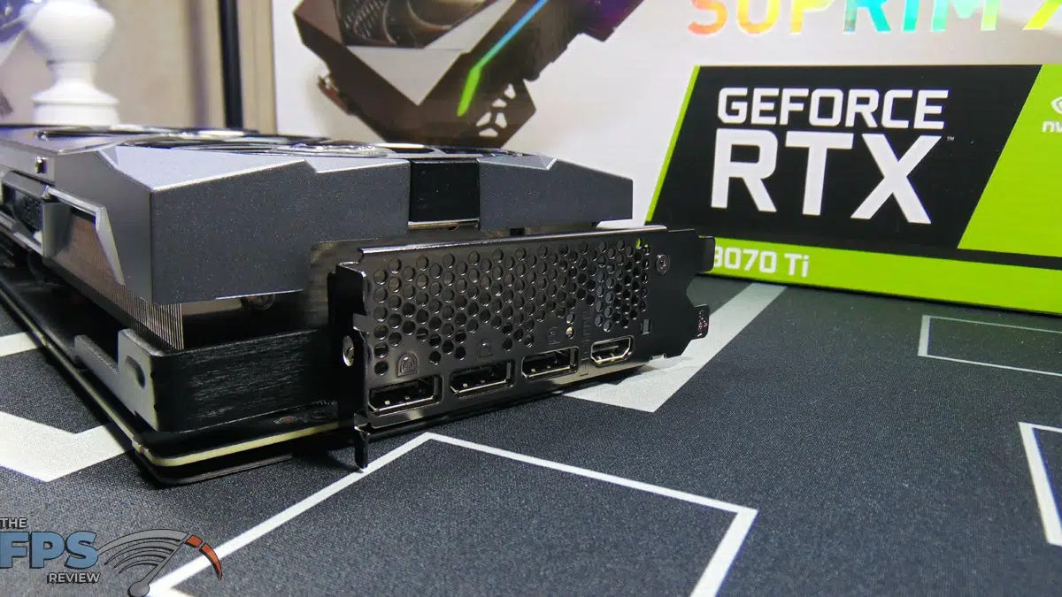

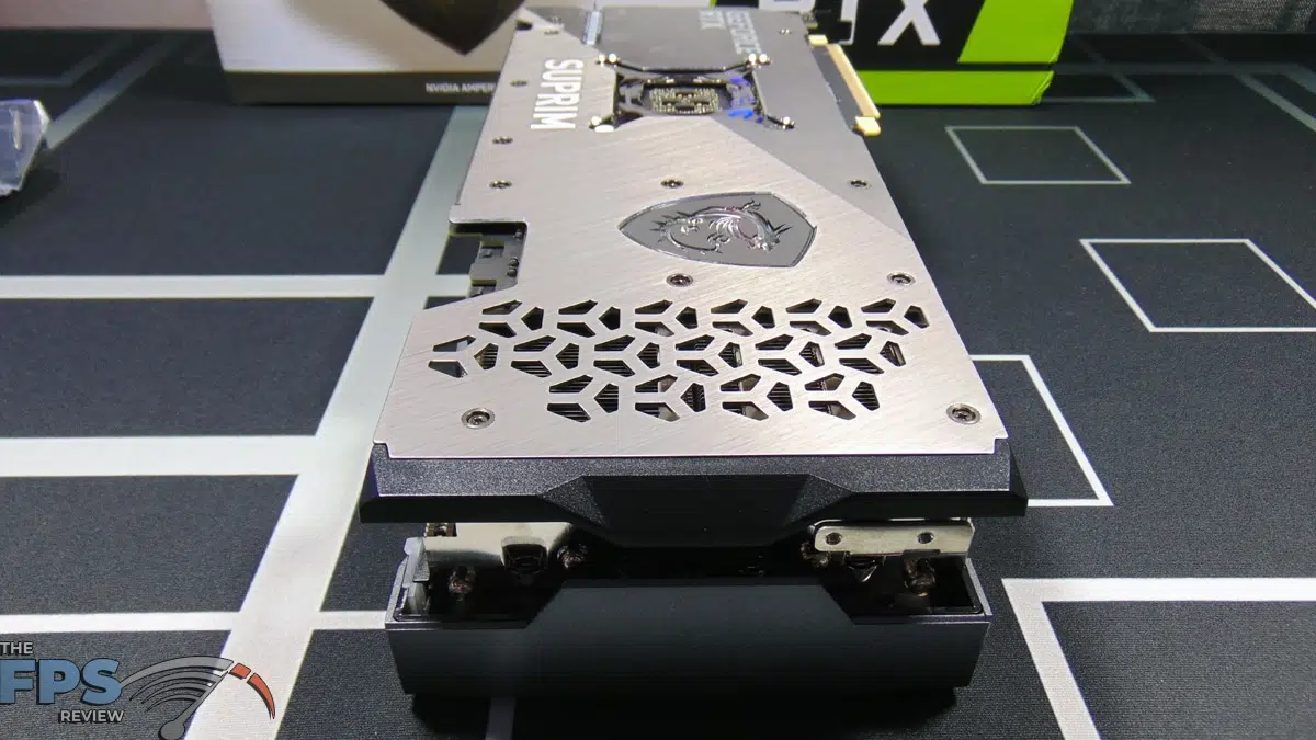

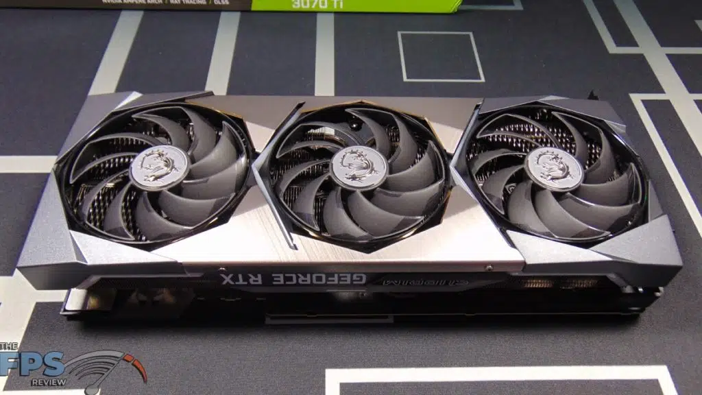

The MSI RTX 3070 Ti SUPRIM X video card measures a large 13.18 inches in length, 5.5 inches in width, and 2.4 inches in height. By comparison, the Founders Edition measures 10.5 inches in length, 4.4 inches in width, and only 2-slot in height. The MSI RTX 3070 TI SUPRIM X weighs a heavy 3.8 pounds. It has three DisplayPort 1.4a ports and one HDMI 2.1 port. The power consumption is quoted at 310W and the recommended PSU is 850W. The video card does come with support for your case.

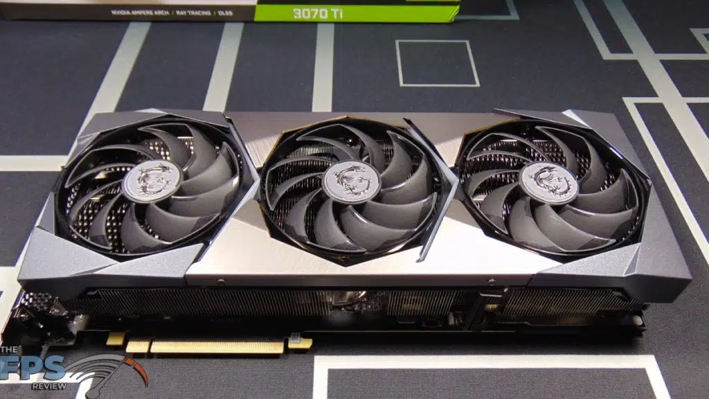

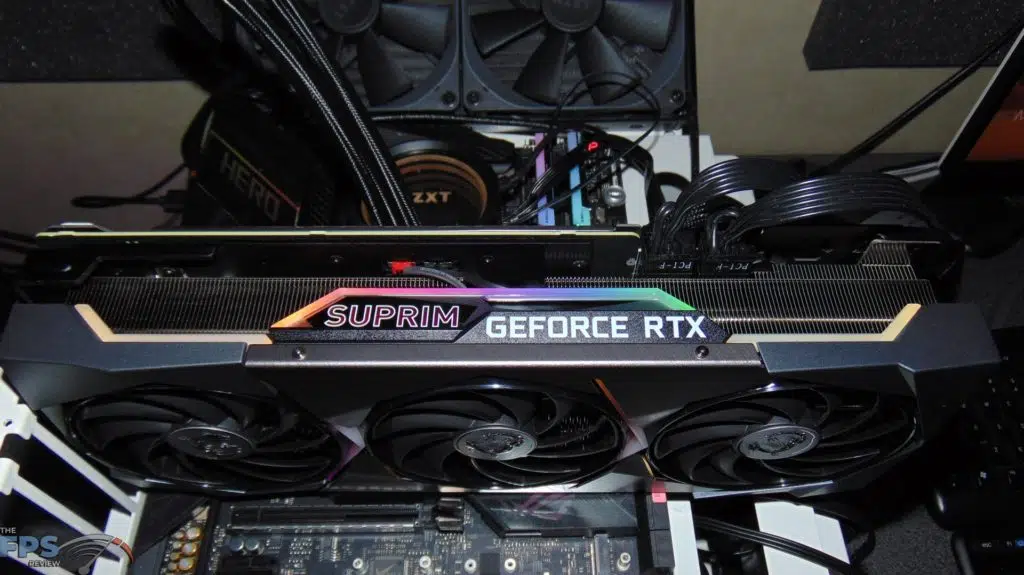

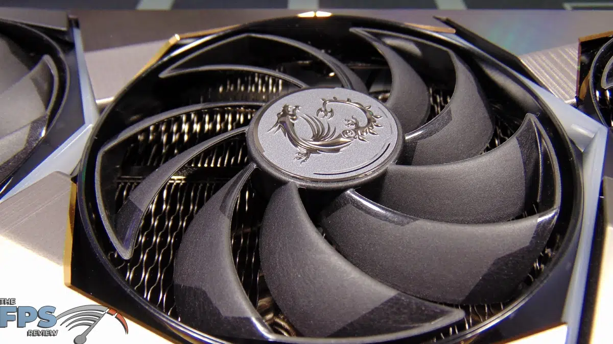

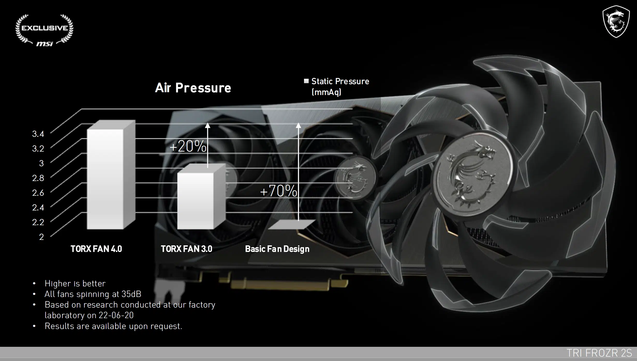

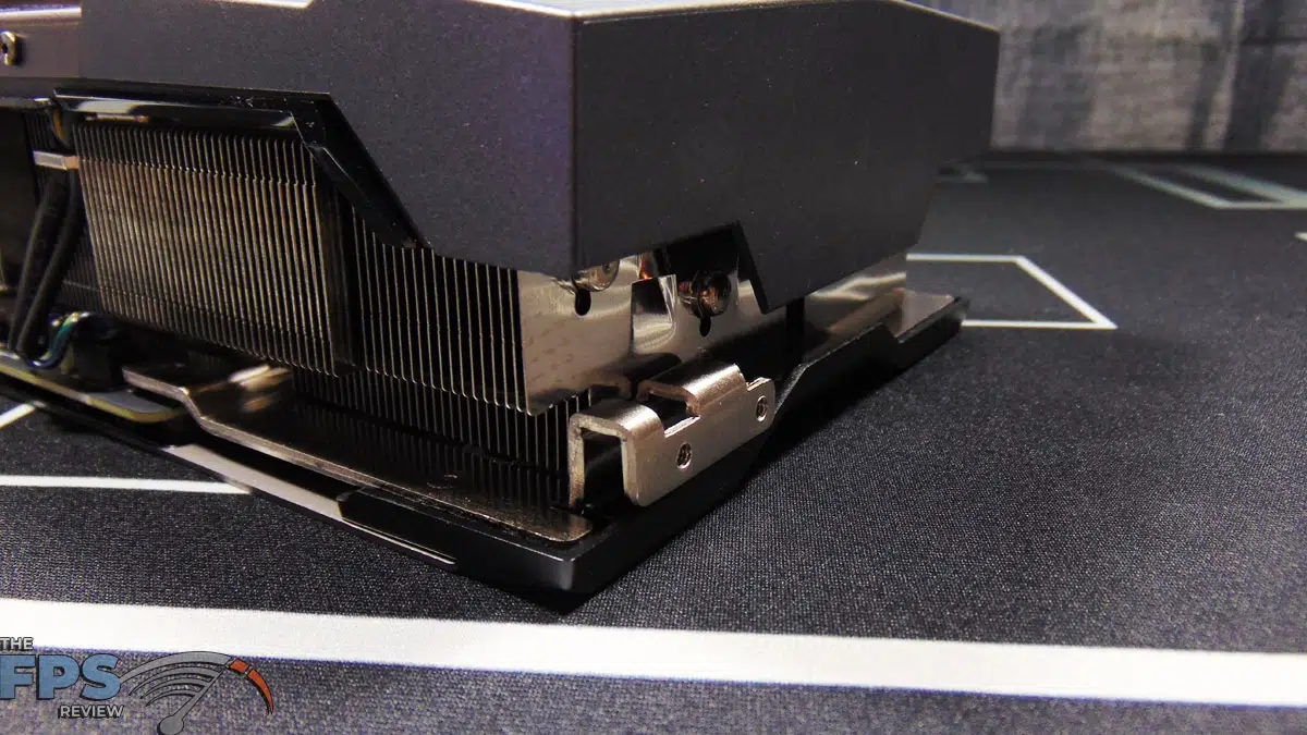

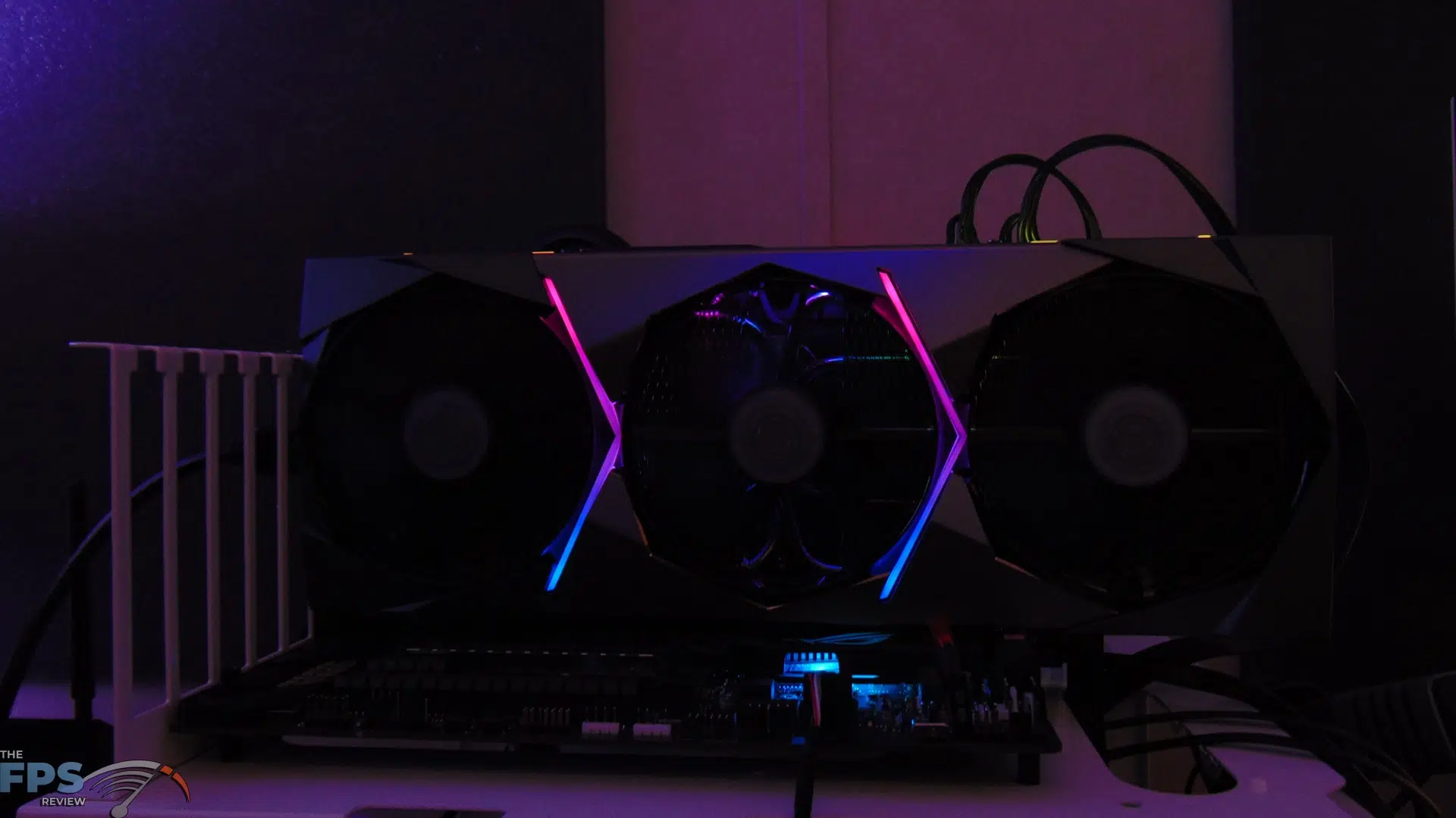

The heart of the MSI GeForce RTX 3070 Ti SUPRIM X is the TRI FROZR 2S cooler setup. The three fans are made up of MSI TORX FAN 4.0 fans, with pairs of fan blades linked together to focus airflow and air pressure into the heatsink. The fans support Zero Frozr which turns off at low loads.

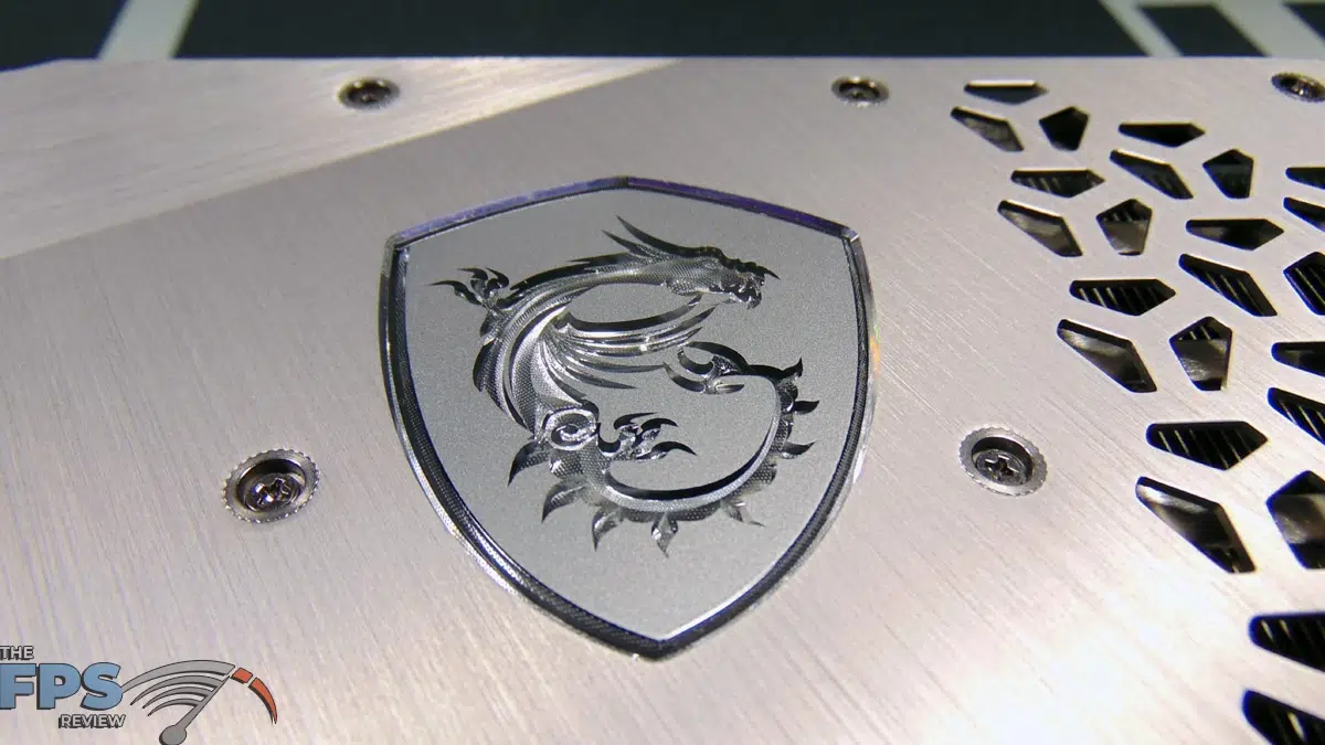

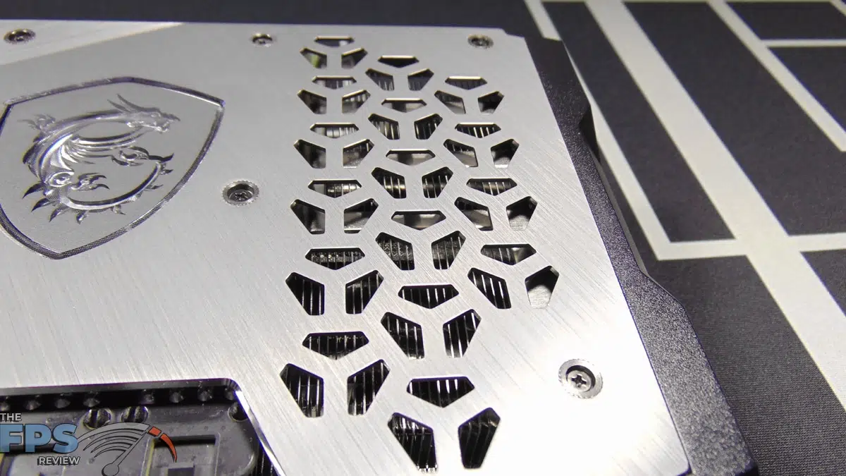

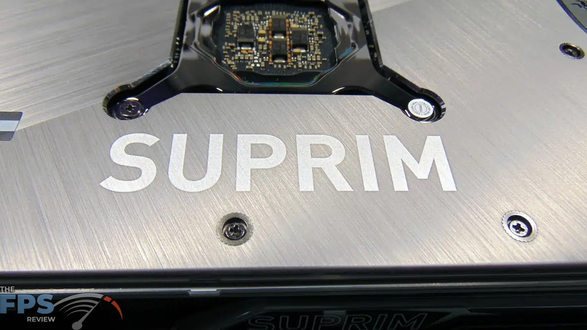

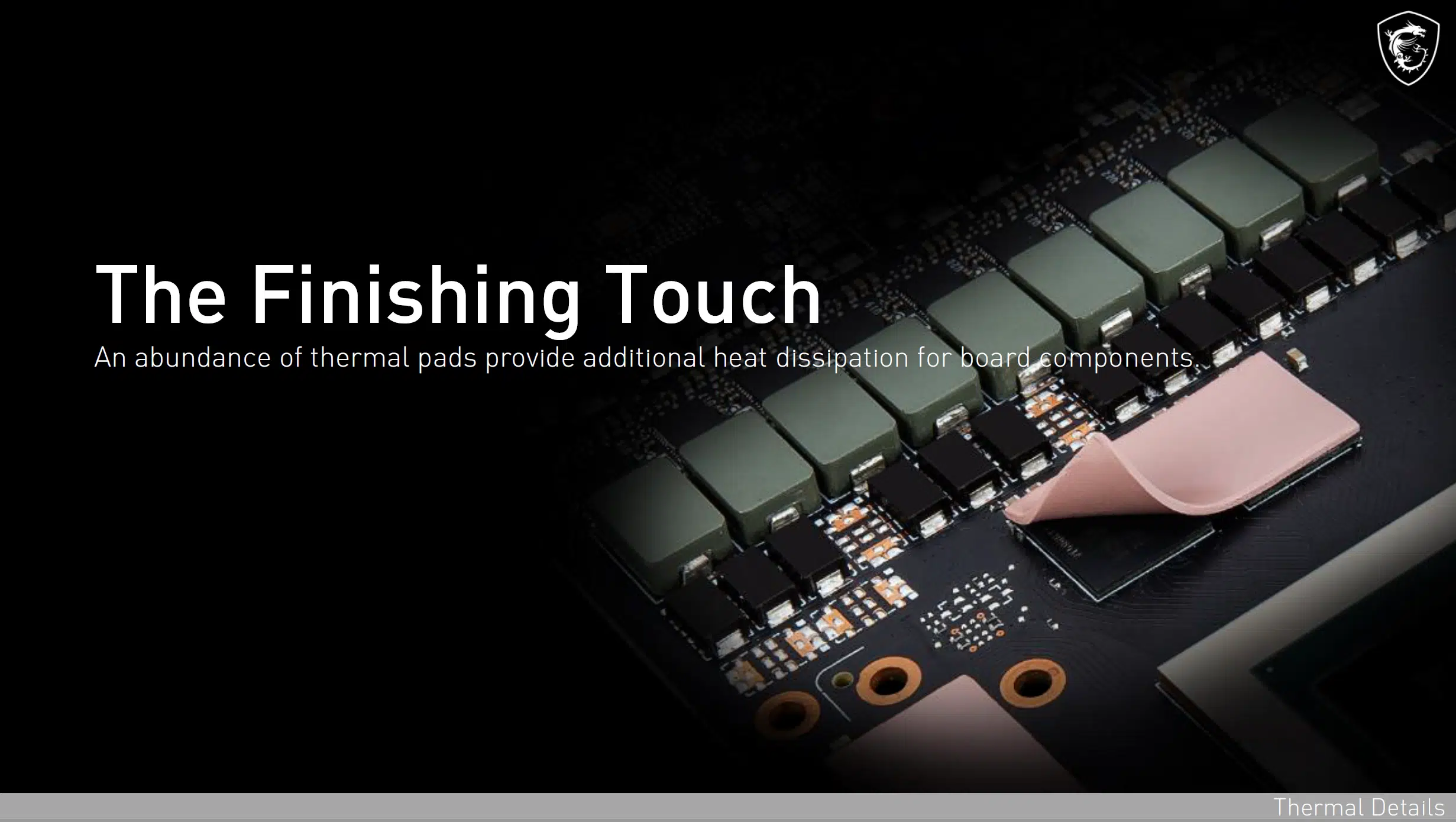

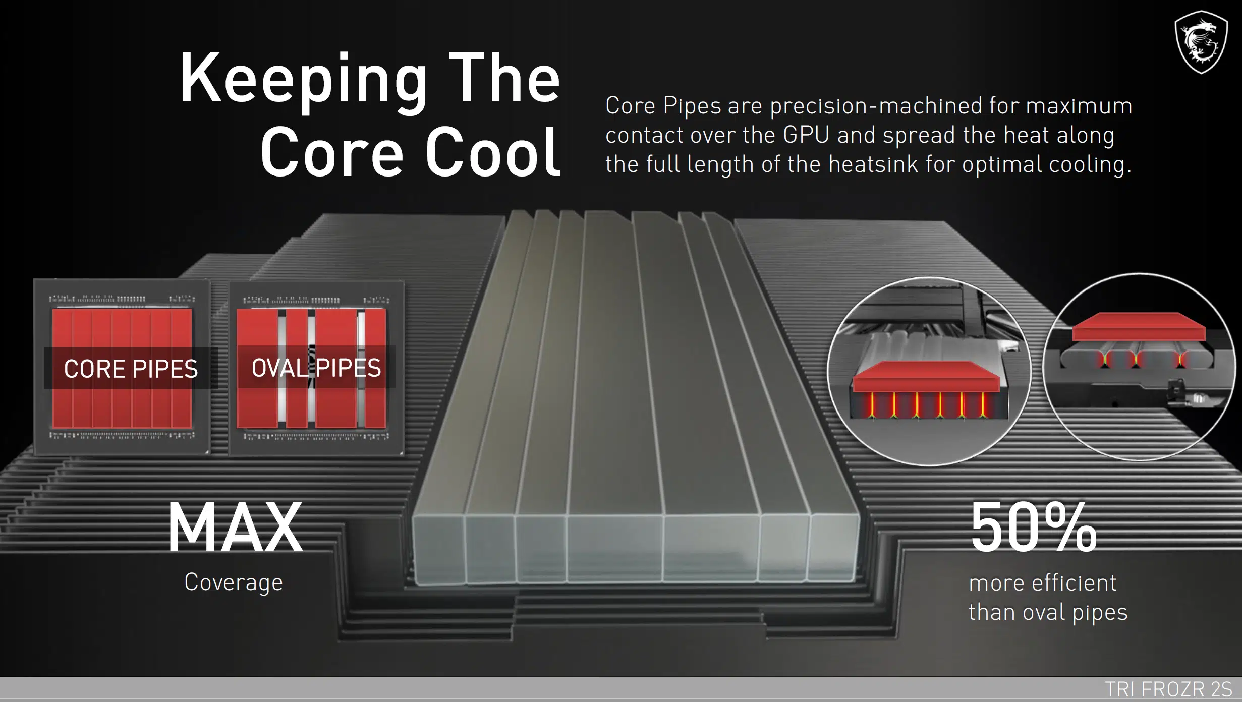

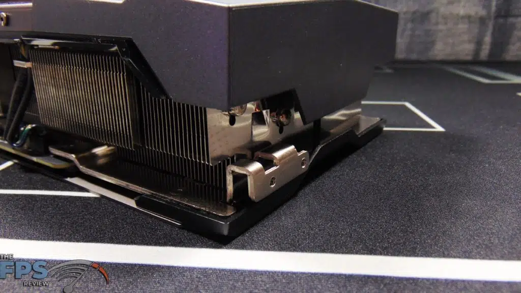

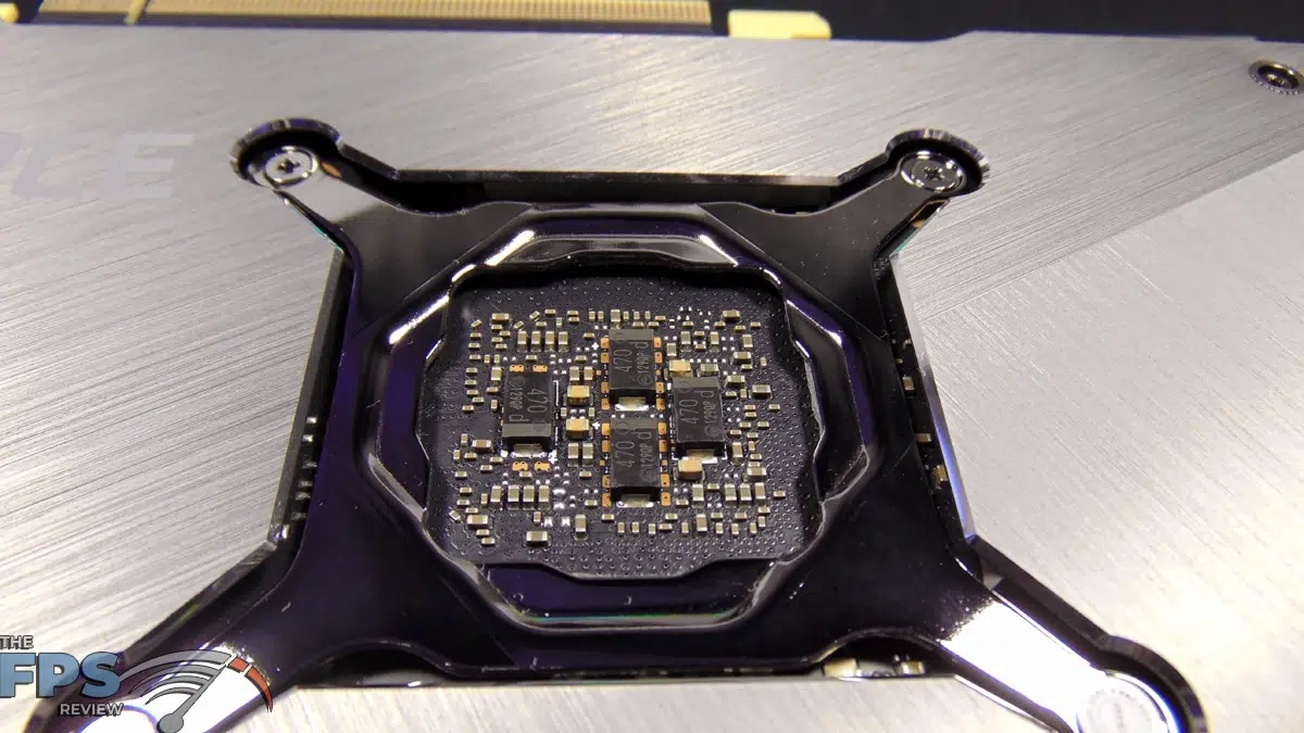

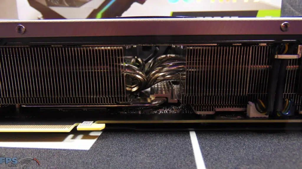

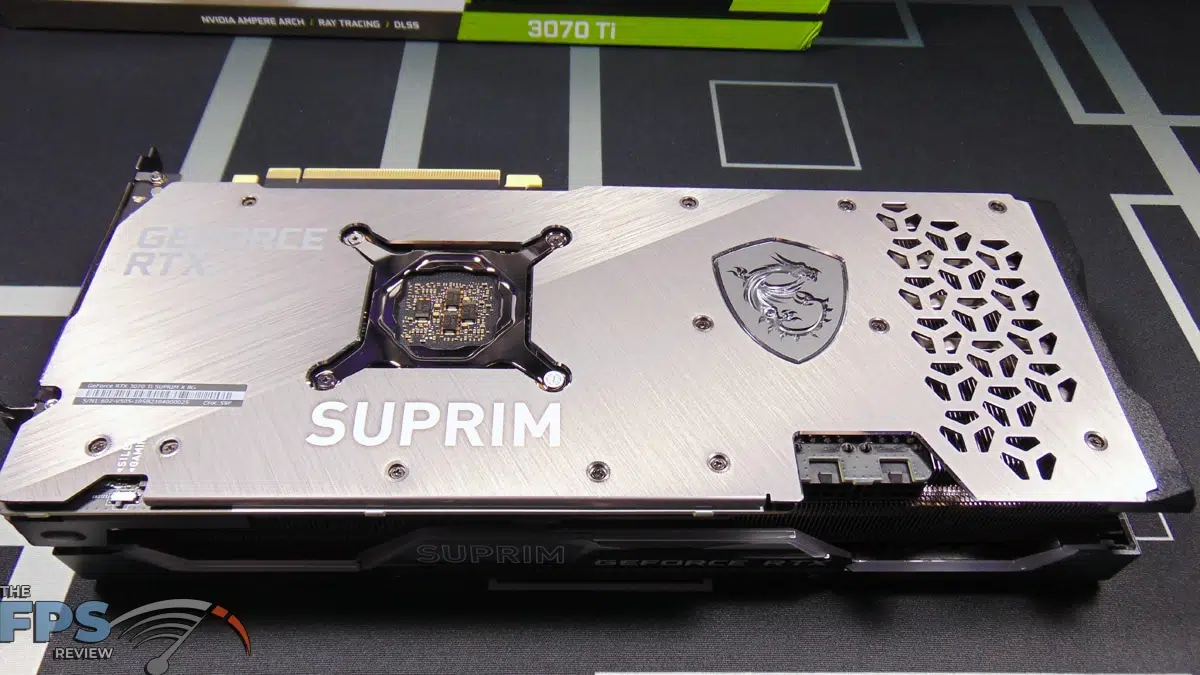

The heatsink uses a solid nickel-plated copper baseplate and an array of heatpipes. The baseplate is very wide and it uses MSI Core Pipe to make sure all heatpipes are in contact with GPU heat transfer. Airflow Control deflectors are used to and Wave-curve 2.0 fin edges to guide airflow. Memory modules receive separate specific Close Quarters Heatpipe & Heatsink design that runs to a dedicated heatsink. The backplate also has thermal pads to provide additional cooling.

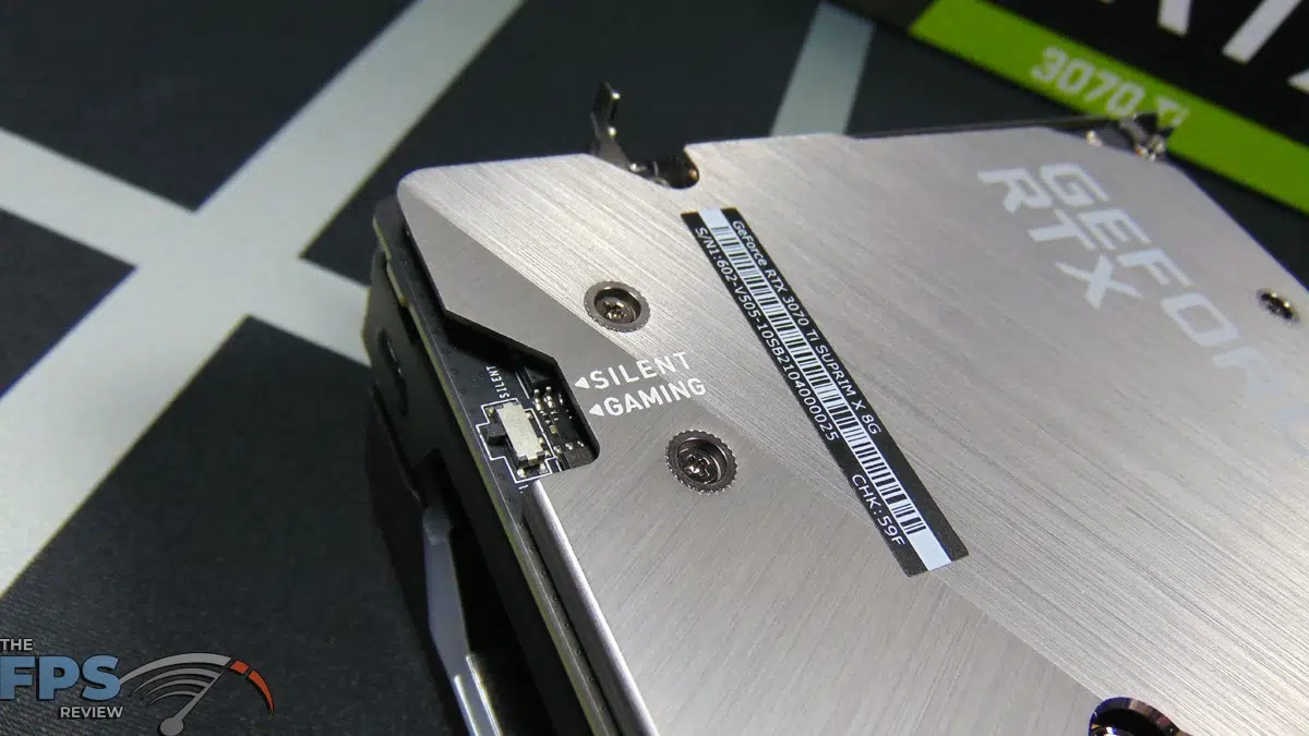

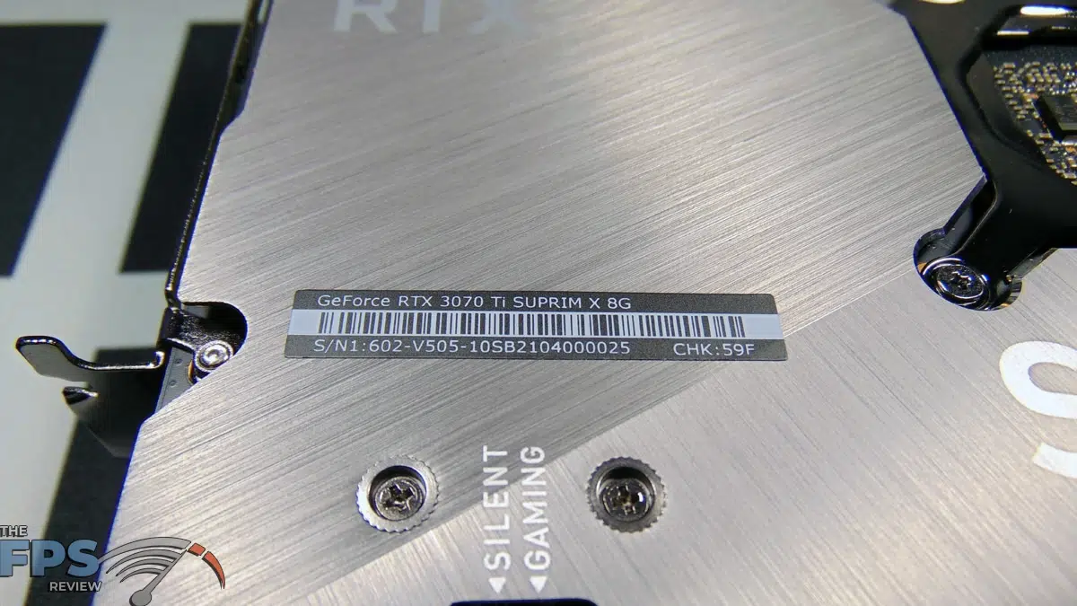

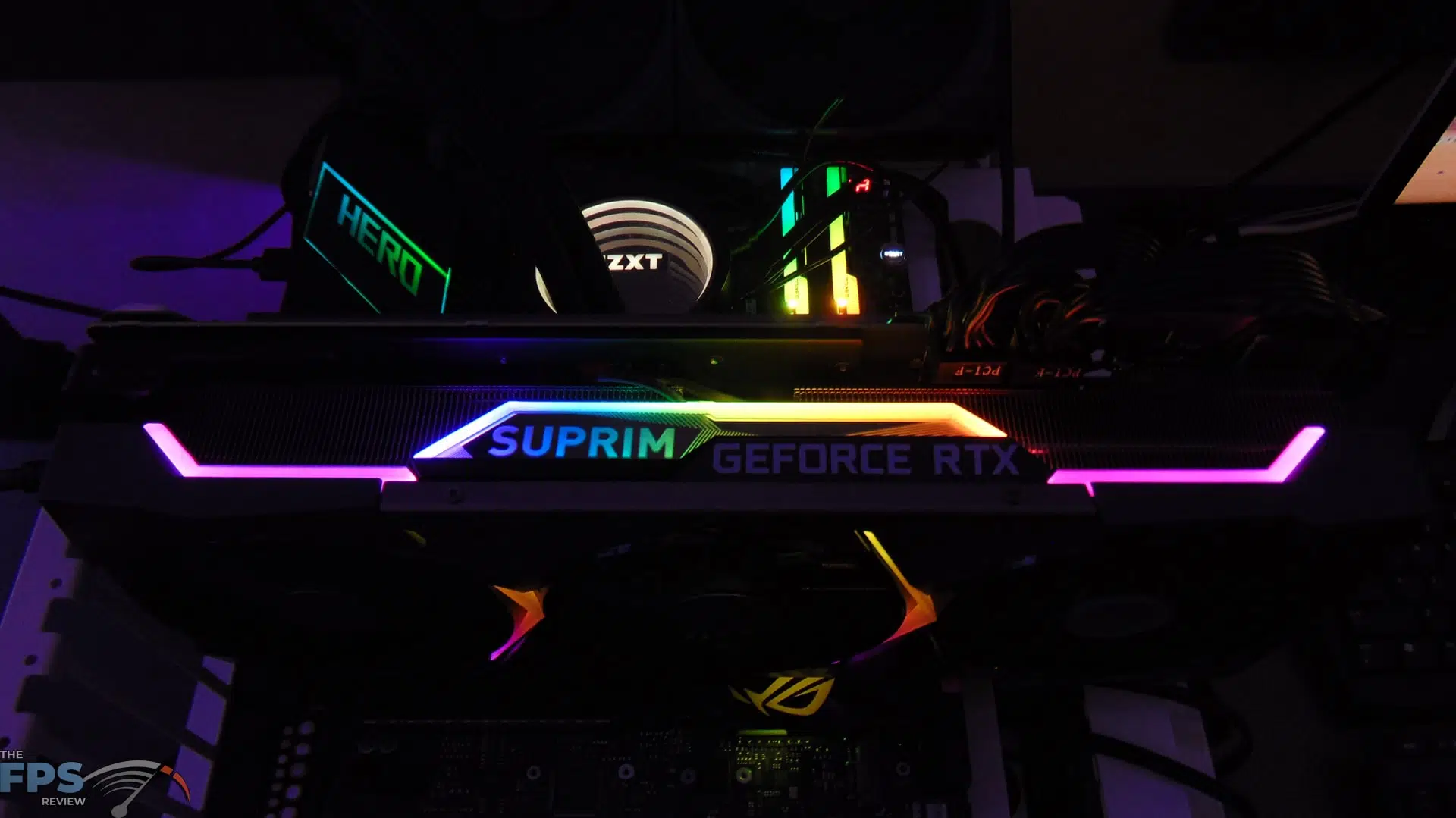

In terms of hardware, there is a Dual-BIOS on this video card. The default (shipping) position of the switch is in the Silent mode for a low noise operation. Optionally, you can switch it to the Gaming mode, which increases the fan curves. The clock speed (1860MHz) and power delivery is the same between both BIOS options. There are additional fuses built into the custom PCB to provide additional safeguards against electrical damage. The PCB is made of thickened copper to provide better conductivity and heat dissipation. The video card also supports MSI Mystic Light RGB with full RGB control in MSI Center.
