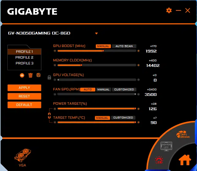

To overclock the GIGABYTE GeForce RTX 3050 Gaming OC 8G the manufacturer-provided software is used.  In this case GIGABYTE Aorus Engine.  This software allows adjustment of power and temperature limits, core voltage, as well as Core and Memory frequency.  Fan adjustment is also available. Below is a screen capture of the highest setting in Aorus Engine.
GIGABYTE GeForce RTX 3050 Gaming OC 8G Video Card Aorus engine screenshot
The Aorus Engine also allows controls of RGB lighting if the GPU supports it as well as other compatible RGB devices.  Monitoring of various parameters is also available as well as customizing fan speeds versus temperature.

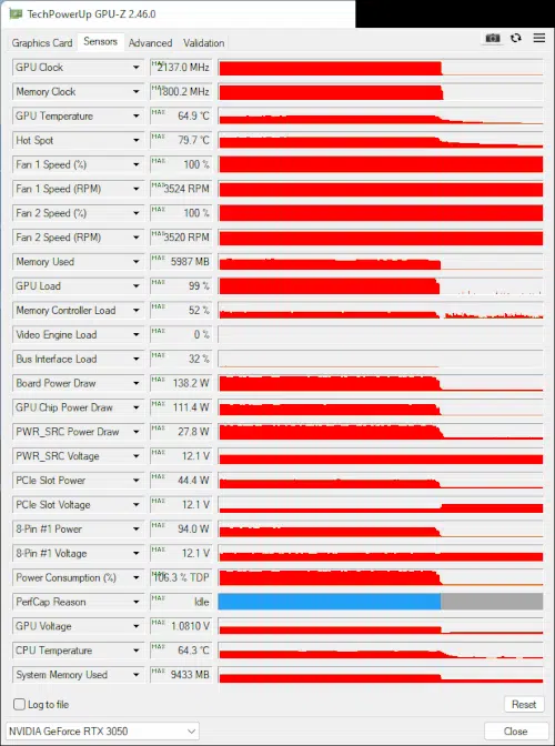

GIGABYTE GeForce RTX 3050 Gaming OC 8G Video Card overclock graph
We were able to increase the Core clock by +170 on the GPU.  This enabled the GPU clock speed to reach a steady 2097MHz.  This is 175MHz above the default Boost Clock, roughly a 10% gain in clock speed.  The memory was able to be increased +400 above baseline or roughly to 1800MHz.
This clock speed is in keeping with the results of other reviews here and here.
