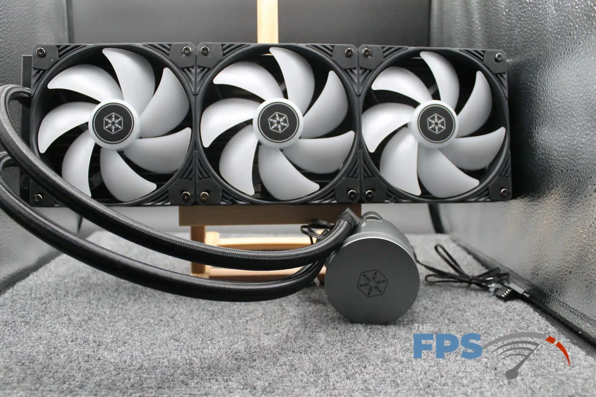

SilverStone IceMyst 420 assembled
Today we looked at the performance of the SilverStone IceMyst 420 Cooler and stacked it up against various competitors that we’ve previously reviewed to see how it would perform on our 13900 K-based test bed. We’ll recap the performance below and see how the SilverStone IceMyst 420 stood up to the heat in our kitchen!

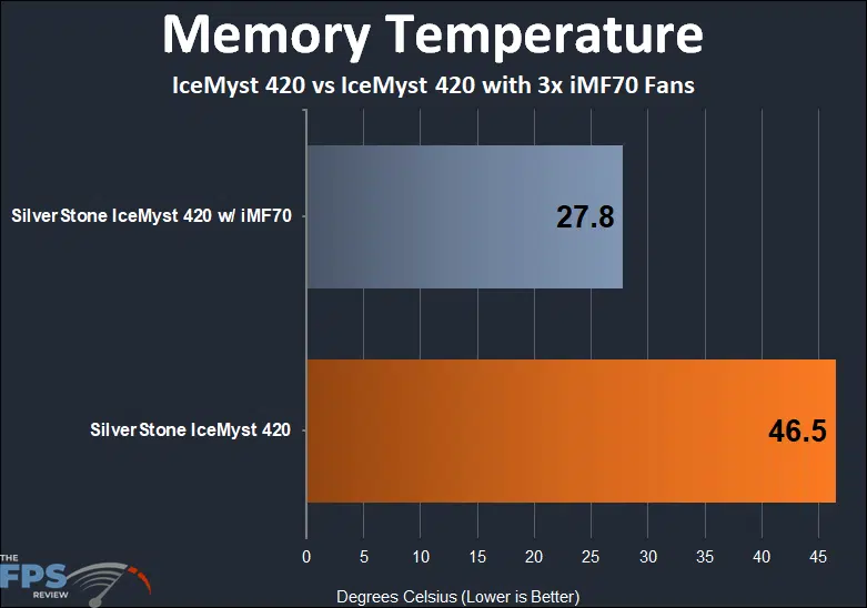

While the overall CPU temperatures were not materially impacted by the addition of three iMF70 fans, we decided to check out the temperature of our DDR5 modules during testing to see if the fans added anything to the equation. We found that the three (really, the one pointed at the DDR5) iMF70 fans made a significant improvement to our memory temperatures. Without the fans, the modules warmed up to 46.5 degrees Celsius, but with the fans, the modules were 18.7 degrees cooler at 27.8 degrees Celsius.
