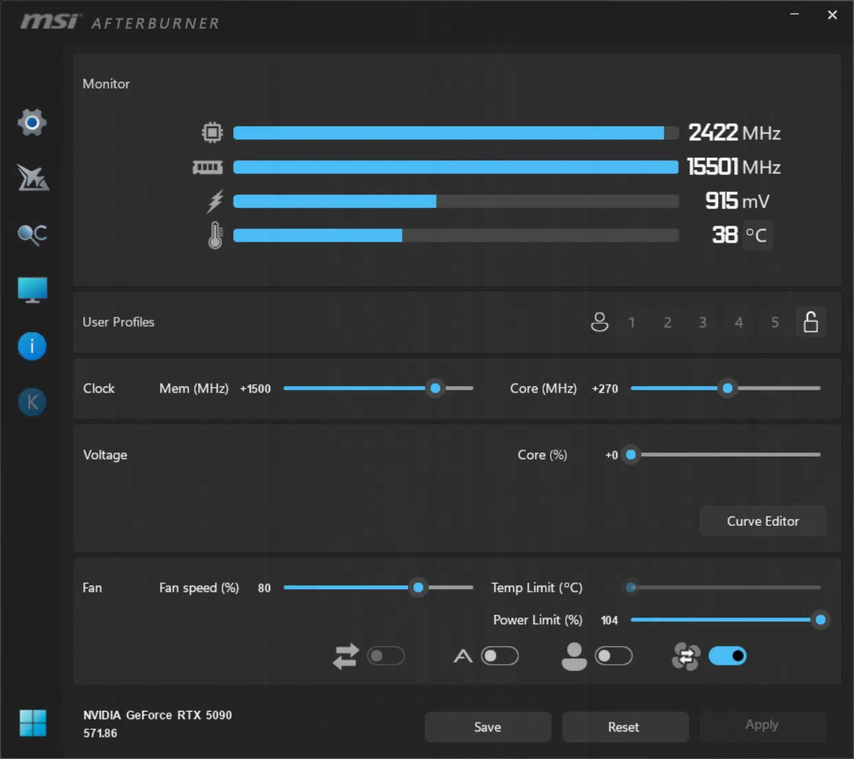

In order to overclock the NVIDIA GeForce RTX 5090 Founders Edition, we need software, and this is where MSI stepped up to the plate and sent us a new beta version of MSI Afterburner that fully supports the GeForce RTX 5090 GPU. With this new version of MSI Afterburner and this new UI design, we were able to control the Power Limit, Core frequency, Memory frequency, Fan Speed, and even Voltage.
In the above screenshot, you will find our highest-stable overclock on the NVIDIA GeForce RTX 5090 Founders Edition. You can see that the Power Limit was able to be pushed up only 4% from 100%, at 575W TDP this makes the new overclocked TDP a maximum of 600W. 600W just so happens to be the maximum power delivery of the 12VHPWR cable itself, so we are literally at the maximum potential of the cable, without power transients. We also set the fan speed to 80% to ensure the best overclock, this increased the noise level quite a bit, but it ensured we weren’t held back thermally for our GPU or memory frequency.
In our overclocking, we found that keeping the Voltage at default was the best, to maintain an overclock that did not exceed the TDP and throttle clock speed. It was clear that more Voltage would have allowed a higher clock frequency, but we actually encountered an interesting thing when we pushed up the Voltage. Pushing up the Voltage to 100% actually caused the video card to lock its frequency at just 600-900MHz. It could be a bug, or it could be a safety measure so that you don’t exceed dangerous voltages and power spikes. At any rate, to clear this issue out we actually had to turn the computer completely off, to reset it back to normal frequency. Therefore, we did not raise the Voltage for this overclock, and frankly with the power and extra heat, it just did not seem worth it to increase Voltage to extreme levels to begin with.
Our highest stable overclock had the Core frequency set at +270 and the Memory frequency at +1500MHz. You will see what this results in at the graph below, in terms of real-world gaming frequency. We were able to push the Core frequency slider up to +300 briefly, some games could play for a few minutes, and some others locked up right away, but at +300 we did see the frequency exceed 3GHz, but it was not sustainable without more Voltage. However, we do feel that with more Voltage, and more power, 3GHz+ might be possible, but you really need good cooling, more power, and more Voltage to do it.
On the memory side of things, the default memory clock frequency is 28Gbps, and with +1500 this increased the memory to 31Gbps. On this 512-bit memory bus, the default memory bandwidth is 1792 GB/sec, with the memory overclocked to 31Gbps the new overclocked memory bandwidth is 1984 GB/sec, an increase of 11% more memory bandwidth. That’s pretty amazing, to almost hit 2Gbps on memory bandwidth, and actually, 32Gbps may be stable, but the power demand is already exceeding the TDP at just 4% more power, so it could end up throttling the clock frequency overall.
