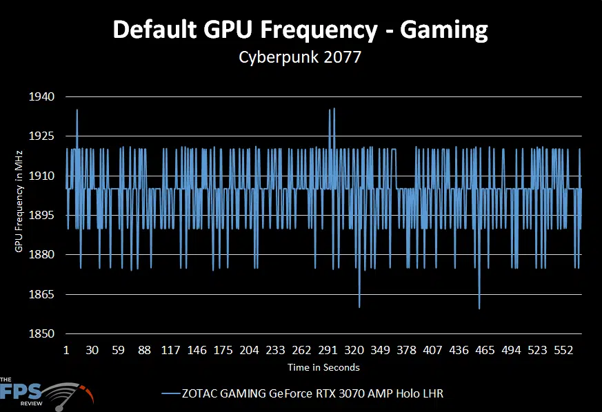

The ZOTAC GAMING GeForce RTX 3070 AMP Holo LHR settled in around 1905MHz but also rattled around between 1980MHz and 1920MHz quite frequently and maintained a temperature of 68.1 degrees Celsius. Compared to the Founders Edition that averaged 1875MHz, the ZOTAC GAMING GeForce RTX 3070 AMP Holo LHR declares victory over the Founders Edition by about 45MHz. Memory in both the Founders Edition and the ZOTAC GAMING GeForce RTX 3070 AMP Holo LHR is set to 14GHz using GDDR6 memory.

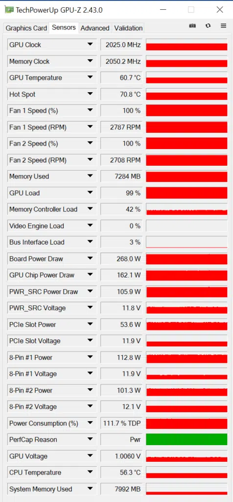

We started by maxing out the Power Target at 110% and boosted the GPU Temp Target up from 83C to 90C. We then cranked the fans up to 100%. There was not a knob present for modifying voltage, however, given the low power budgets on the RTX 30 Series that we have seen so far, adding voltage has not been necessary as it only increases power consumption and reduces how far GPU Boost will push the core clock speed up.

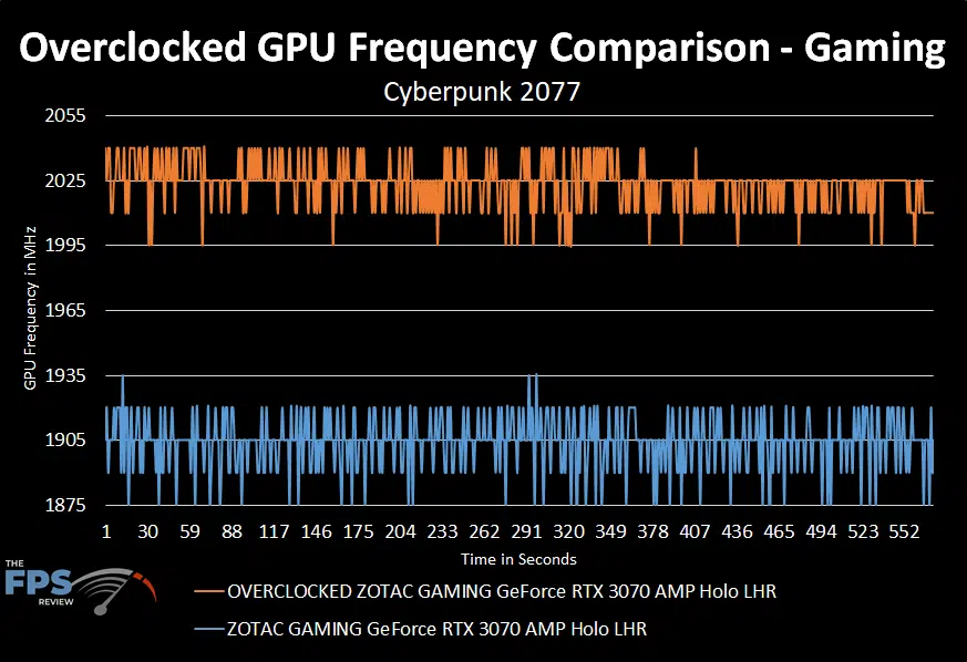

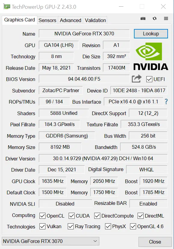

Putting it all together, we first tried our max individual clocks together to see how it worked. This gave us a final stable overclock of 1635MHz core clock, 1920MHz boost clock, and 16.4GHz memory clock.
Comparing the sustained GPU frequency to the stock frequency, we see that the observed overclocked frequency averaged out to 2025MHz. This is a 5.4% increase over the stock clocks and an 8% boost over the stock Founders Edition performance. The memory at 16.4GHz is 17.1% faster than the stock clock as well.
