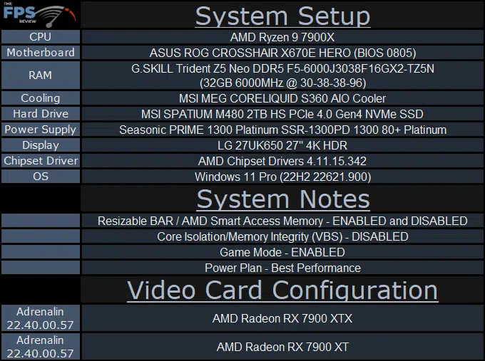

What we want to find out is how much difference it really makes with the new Radeon RX 7900 Series GPUs RDNA3 architecture. Therefore, we are going to take the Radeon RX 7900 XTX and Radeon RX 7900 XT and compare performance with Resizable BAR enabled and disabled in the BIOS, no other changes. We are running on an AMD AM5 platform Ryzen 9 7900X CPU and X670E chipset for that complete AMD Smart Access Memory (AMD SAM) platform synergy.

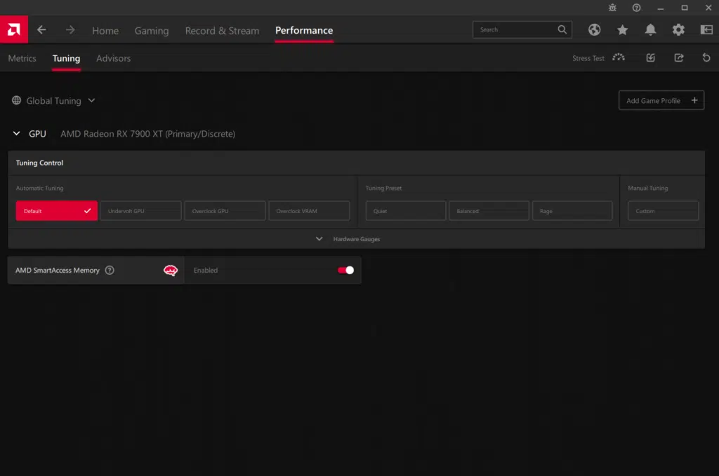

How to enable Smart Access Memory
Test Setup

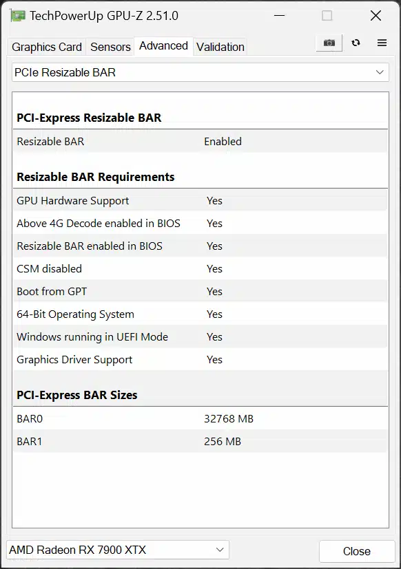

Yea found I had Sam on but it wasn't working because of csm. I turned that off.
